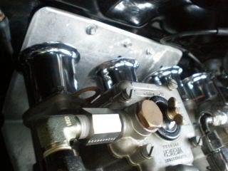

    I have a 16V MC carb project going right now. I posted a pic of the manifold in progress in the 8V thread. I welded the injector slots in my heads, I also did a gasket match while I was in there. My pendent on my CNC smoked, when the new one arrives, I will post more pics of my manifold.
  3. Member iceman2.0's Avatar
    Mar 28th, 2006
    W.Mass
    851
    MANY,84 Jetta Coupe, CC w/DSG
    06-04-2008 11:24 PM #143
    Quote, originally posted by frankthewelder »

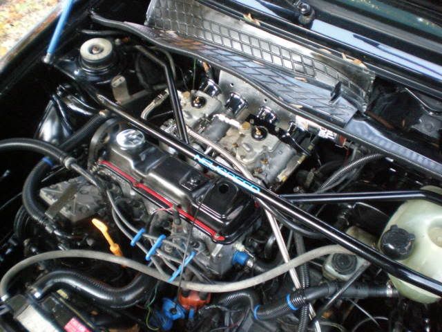

    Heres mine and my Engine Specs:
    1.8Lt, bored .040
    82mm pistons
    Head shaved .010
    Block decked .025
    280 degree Schrick cam
    Hi-Rev valve springs
    Weber single bore throttle body
    Engine rebuilt at Ron's Parts at approximately 110,000 miles (RPIequipped.com)
    Engine blueprinted by Techtonics
    Battery removed from under hood, placed in enclosure behind passenger seat for better weight distribution
    Transmission and Clutch Assembly
    210mm Clutch
