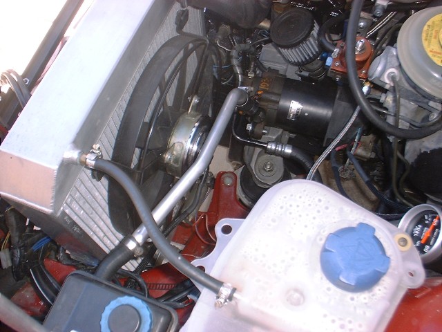

    The End Result courtesy of Twinscrew20V:
    & Eurosport
    The collected information and projects in this thread is simply amazing... Special Thanks goes out to the following as they made this happen:
    * Shawn DeZego who has been nothing but GREAT with his helpfullness and attention to detail!Below is an image of the current state of his ABE G60 Project.
    (click image to enlarge)

    Could someone post some pics of AEB 1.8t's out of car. Possibly top front like previous pictures and side view showing factory belt set up.
  30. Member CABNFEVR's Avatar
    Oct 29th, 2001
    Toronto, Canada
    4,857
    83 Rabbit
    11-10-2004 05:07 PM #30
    Perfect, thanks Any chance a non cut away version is out there?

    You stated in the other thread that you could use the g60 brackets on the AEB. Just wondering if I dont need AC or PS if the charger and alt could be mounted in the front of the engine not having to mount the alt in the back. Any idea?
  33. Member
    Dec 25th, 2003
    N. Phx, Az
    5,653
    91 20vG60 GTi, 91 VR6T GTi, 12 Golf R
    11-10-2004 09:31 PM #33
    You can...But it wont be a G60 alt. You'll have to do some experimenting to find one that you can mount below the charger. Look thru the 16vG60 Yahoo web group. Some of the fuys there have had some success with it.
    This is empty...Cuz Im too lazy to fix it now. Jus sayin.
