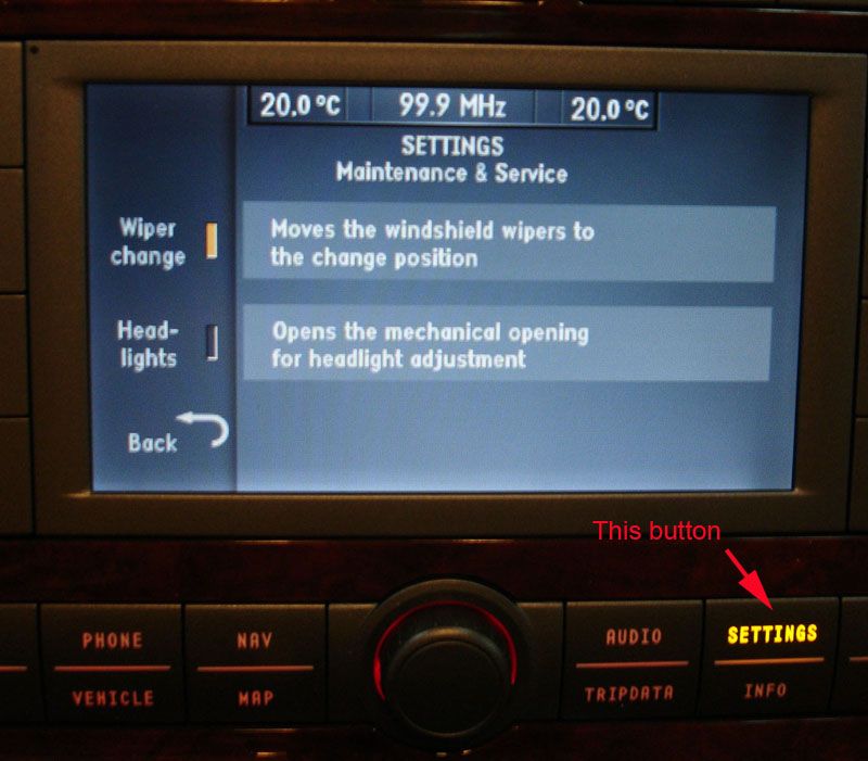

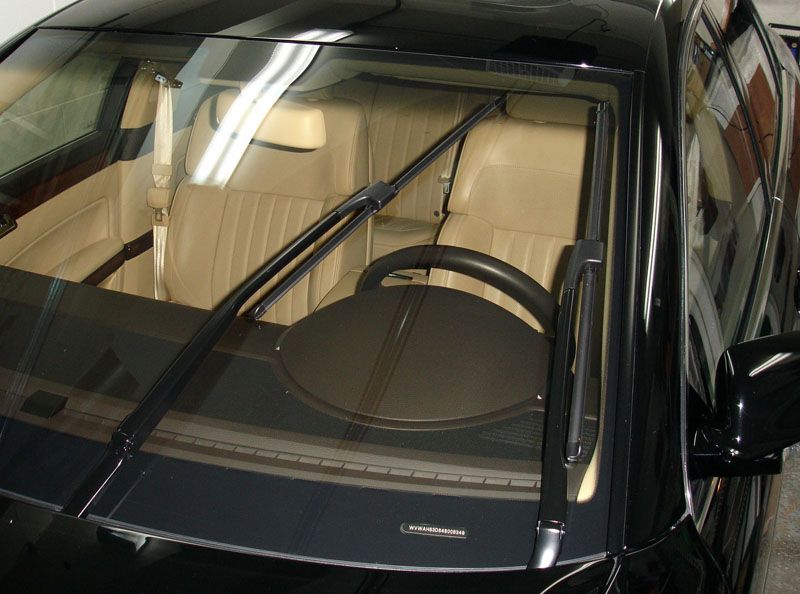

      1 – Put the wipers in the ‘wiper change’ position, using the control on the infotainment console. This will move the two wiper arms up into the fully extended position. If you try and lift the wiper arms when they are in the usual parked position, you will scratch the paint on the trailing edge of the hood - and, you won't be able to lift the blades up high enough to rotate them and remove the blade from the wiper arm.
      The control for moving the wiper blades to the maintenance position can be found within the commands available from the ‘VEHICLE’ button.
      Maintenance Function Screen
      Important Tech Tip: You can only operate the wiper arms from this maintenance screen if the wiper switch is in the OFF position.
      If the wiper arms do not move when you press the button, it is because the wiper switch is still in the 'intermittent wipe' position,
      because you left it there the last time it was raining.
      Wiper Changing Position

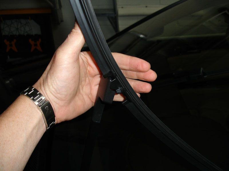

      Note that the longer of the two blades goes on the driver side of the car.
      2 – Lift the wiper blade away from the glass, rotate the blade about 45°, and pull it towards you. It will come off the wiper arm.
      Removal is very simple and requires no tools or force

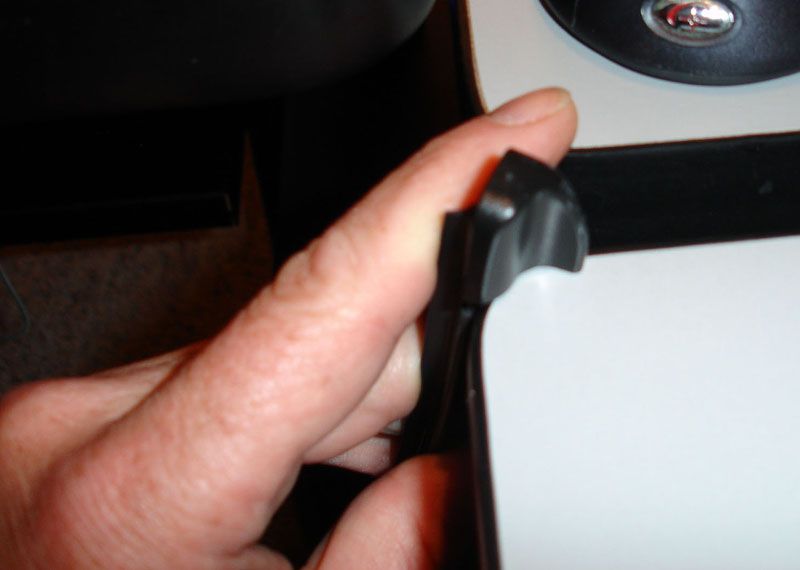

      6 – Pull the cap off the end of the blade that the wiper is attached firmly to. You might be able to do this with your fingers, or, perhaps you might have to use a pair of pliers, or pry the cap off by placing it against the edge of a workbench and pressing on it.
      One way to remove the cap from the end

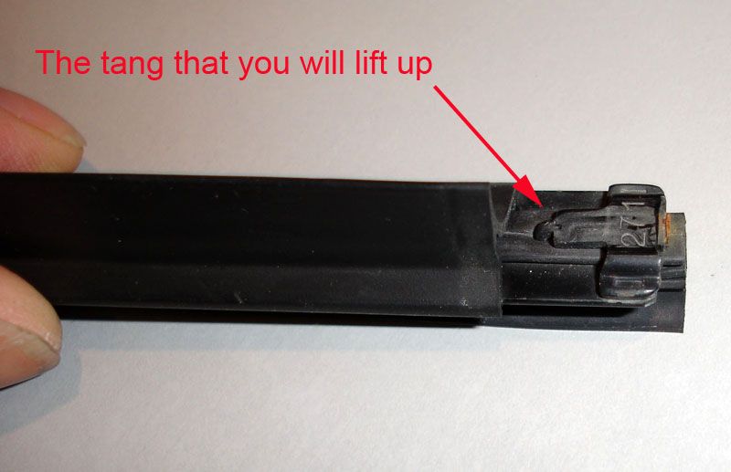

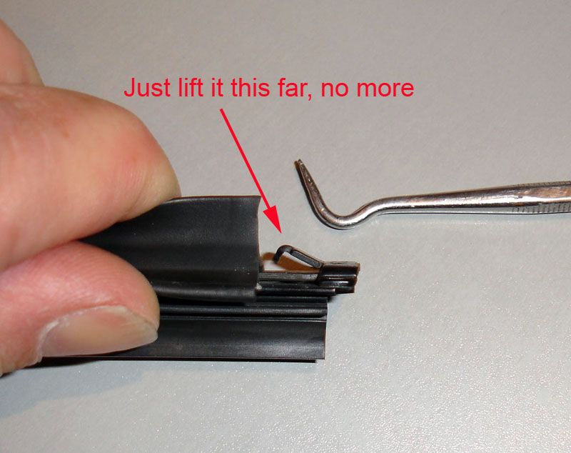

      7 – Once the cap is off, you will see that there is a small metal tang that presses down into the wiper blade to hold it in place. Pry this tang upwards a little bit using a small screwdriver or a dental tool.
      Before lifting the tang
      After lifting the tang
      8 – Slide the blade out from the assembly. If you encounter any difficulty removing the blade, immerse the whole assembly in a sink full of warm water and dish soap. This will lubricate the blade and allow it to come out easily.

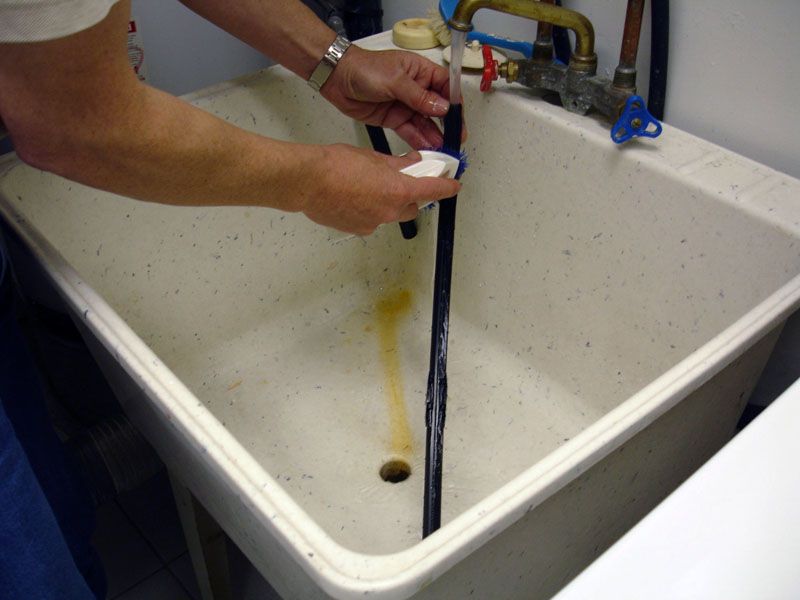

      10 – Wash the track that the old blade was in using warm water, dish soap, and a toothbrush. This will clean dirt out of the track and make it easy to slide the new blade into the slot.
      Cleaning the blade channel before installing the new blade
