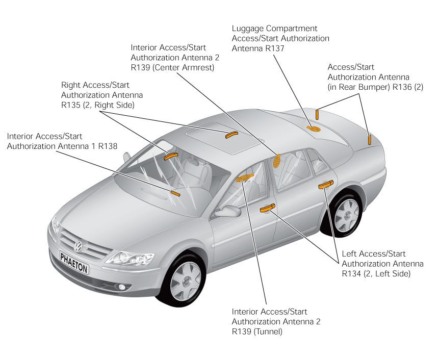

    Antennas needed for Keyless Entry
    Note that the reception range of the interior and exterior antennas does not overlap. There are two different and distinct zones - inside and outside.
    Also be aware that the exterior door handles themselves function as antennas.
