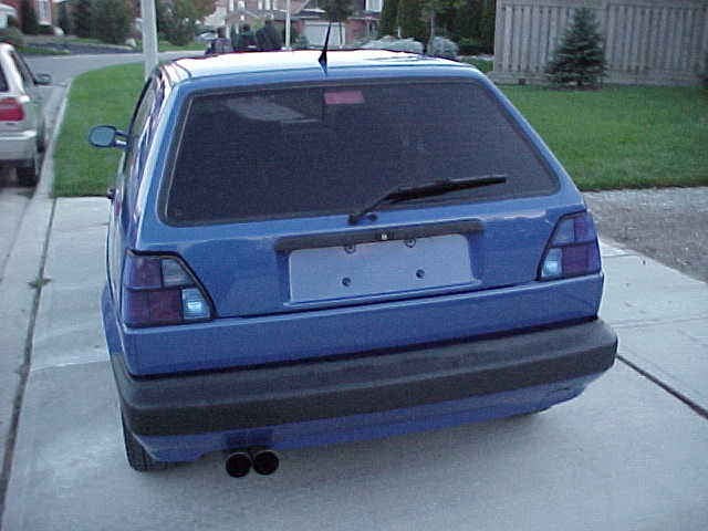

      Jason Crabtree A2 Golf TDI.
      From tdiclub forum:
      Well so far things are going well. The engine bay needs a damn good clean and the car needs a wash so I can inspect the body work and do some touch ups. I made the decision to run it in the winter so I must deal with the consequences. This isn't a show car (didn't win the lottery so can't afford to do that). The interior still needs to be completed which will be a spring job as it is too cold out.
      This car hauls and I love it. Has a nice vibration to it at idle (although my better half doesn't like it). Since I only drive it the odd week night and on weekends, I'm still getting used to actually driving it but I smile every time I drive it and the fuel economy is icing on the cake.
      The VR6 chin spoiler has a couple scrapes on in but is holding up. A little low and entering/exiting car parks must be taken with care.
      A run down of non-standard equipment:
      2.5" Scorpion twin DTM tip cat-back exhaust
      Wett chip
      11" front brakes (RPI Wilwood kit)
      rear disc conversion (with cross drilled - overkill. love it )
      25mm ABD front sway
      28mm ABD rear sway
      Neuspeed front strut brace
      Hella blue rear lights
      Euro fenders with blue side light
      RPI twin 7" front euro lights
      JOM badgeless grill
      SWG grill spoiler
      VR6 Chin spoiler
      RPI K&N air filter and custom heatshield
      Poly bushings on the front control arms and rear strut towers
      Boge turbogas shocks
      Eibach springs
      Beesting antenna
      M3 repilca mirrors (with a cool blue tint)
      15" VW Passat rims with snows
      15" TSW Hock R's with 195/50 Pirreli P-700 (summer)
      Oil: Mobile Delvac 1
      Fuel: Sunoco diesel with Amsoil cetane boost & fuel conditioner (thanks Andy)
      Jazz Blue paint
      Alarm
      Things to come:
      2.5" down pipe (details to follow)
      Things I want but can't get due to morgage (grrrr.):
      Upsolute tuning box (help Tazz out)
      Quaife LSD
      sachs power clutch kit
      Things I would do if I won the lottery:
      Remove engine and paint engine bay jazz blue as well.
      Roll cage
      A3 dash
      That is pretty much it. I will be doing a sping cleaning (remove intercooler & plumbing to see how oily and need to replace dash bulbs) and hopefully put on a 2.5" downpipe. Have toyed with Upsolute chips, but right now no $$$. Donations gladly accepted.
      Most work was done @ Ron's Parts (RPI) 604-944-0494. Thanks to Dustan, Andy, Warren and most of all Grame
      Paint & Body work: Walkerton Auto Collision (Randy & Paul)
      Thanks
      J.
      More about this TDI swap at:
      www.tdiclub.com
      [IMG]http://*****************.com/smile/emthup.gif[/IMG]
