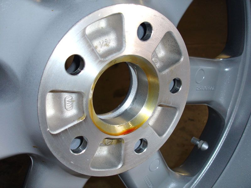

    New wheel before the wax is applied
    New wheel after the wax is applied

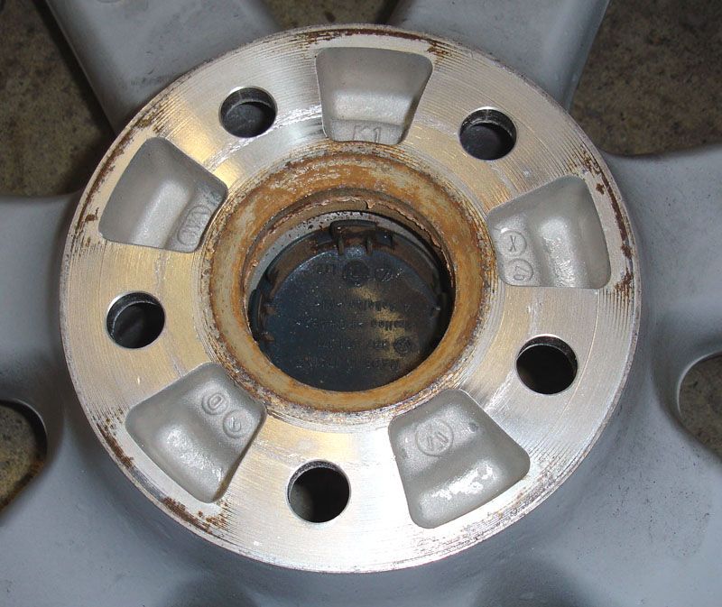

    Wheel showing corrosion if wax is NOT applied
    This wheel was in service for 3 months.

    Holy 3-month corrosion, Batman!
    Of course I have never read that page in the manual, and of course I've been driving around for one year, and did the VW dealer who rotated the tires use this spray?
