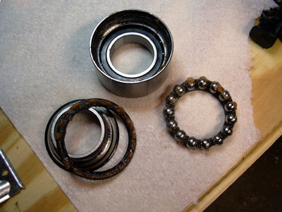

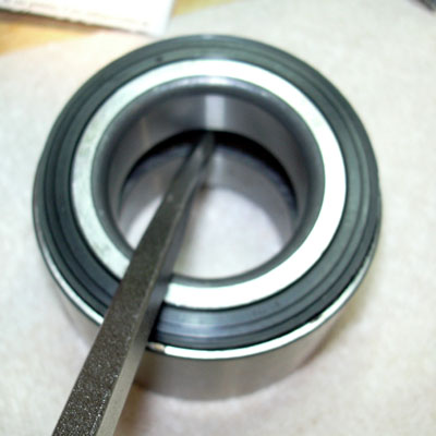

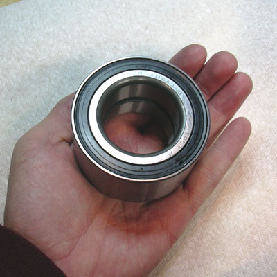

    Here are some quick pics I took on taking the bearing apart. This was a SKF brand bearing, so I'm not sure if the seals look like these on others. Please also note that it takes very little force with the screwdriver to pop the bearing apart and it doesn't damage tha ball bearings or the races. The other side can be popped out by hand.
    Take a screwdriver and carefully pry the two inner races apart (one side will pop out).
    Take the race and bearing out as one unit.
    Take note of the order of the parts (seal direction is important...i.e. outer & inner)
    Here are the bearings that just snap into a resin retainer.
    Simply clean all the seals and bearing of the factory grease and then repack with a good synthetic (Redline CV Grease is awesome).
    Hand pressure will press the the bearing back together. Be sure that both sides turn freely. If not, then a seal is not seated correctly.
