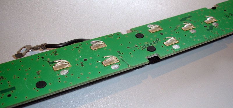

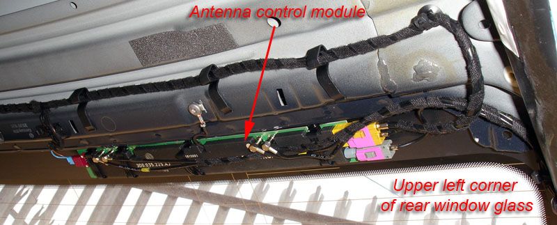

    It's quite easy to remove and re-seat the two antenna connectors at the J523 - see these two posts for more info:
    J523 Front Information Display and Control Head – Removal Instructions
    J523 Front Information Display and Control Head – how to replace (contains useful tips for routing the cables)
    As for the antenna controller - it's a bit more difficult to get access to it, because it hides behind the headliner, at the very top of the rear window glass on the left side of the vehicle. To get a perspective on where this thing is, open the left rear door of the car (LHD or RHD, doesn't matter), put one hand on the top of the rear window glass on the outside of the car, and one hand on the top of the rear window glass on the inside of the car. You will note that there is about 4 inches of rear window glass that is not visible from inside the car... that is where all the antennas are!
    It is a major nuisance (translation - massive interior trim dis-assembly) to get access to the antenna controller for the purpose of making sure that it is making good contact with the metal film on the glass, and to make sure that the two antenna connections (many more if the car has TV) are properly seated. I will eventually have to replace my antenna controller when I hook up my TV tuner, and when I do this, I'll take lots of pictures and post a 'how to'. In the meantime, I have posted a few illustrations and pictures below to give you all a general idea of where all these hidden components are.
    However - having said all that, I wonder if the FM stations in the UK transmit at a lower wattage than those in North America? Most of the folks reporting problems are from the UK, and most of us who have no problems are in NAR.
    Michael
    Antenna Components on Rear Window of Phaeton
    The actual Antenna Module that fits against the glass
    Here you can see where the tangs (shown below) on the antenna controller touch the contacts leading to the antenna wires embedded in the rear window glass
    These are the 'tangs' that touch the contact squares shown above.
