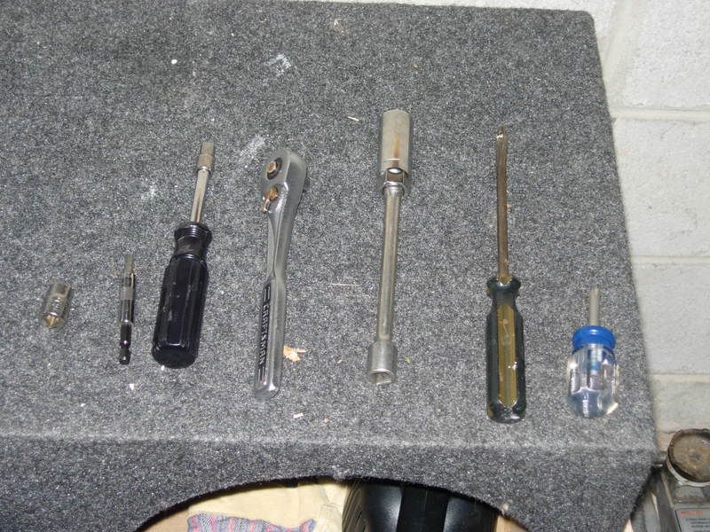

Tools needed-
-Phillips head screw driver.
-Flat head screw driver
-10mm Socket
-Sparkplug socket
-Ratchet
-Extension
-Allen key

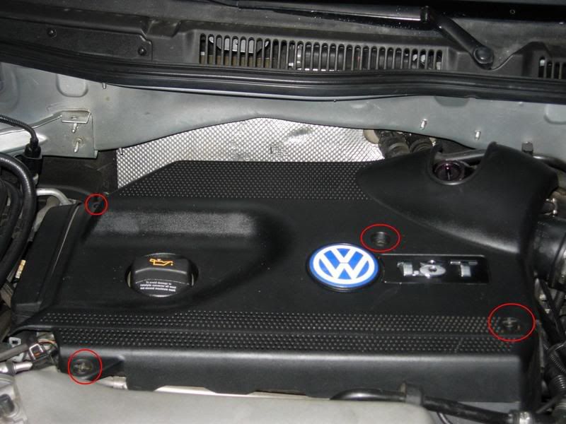

Step 1. Remove engine cover. (found circlued in red)
-Turn the 4 screws a 1/4 turn then lift up

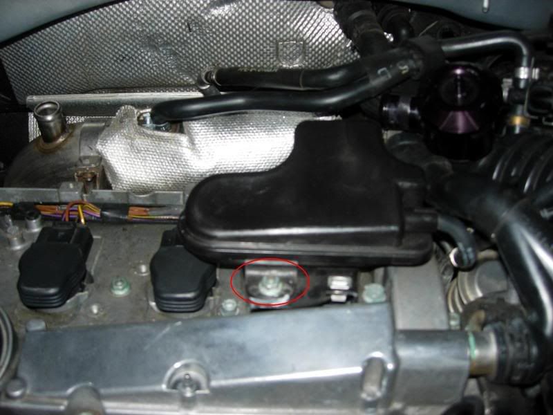

Step 2. Unscrew 10mm nut. (found circlued in red)
- After that tuck the box out of the way to the right.

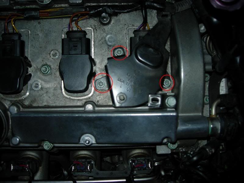

Step 3. Unscrew the 3 Hex bolts (found circlued in red)
- Pull away metal pice and place off to the side.

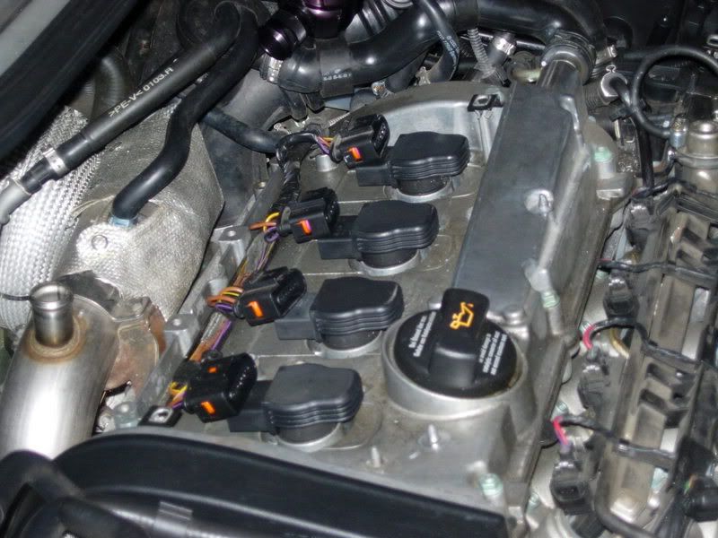

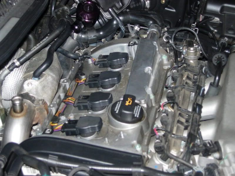

Now your engine should look like this
- I have my DV hose off. For install on Hyperboost DV.

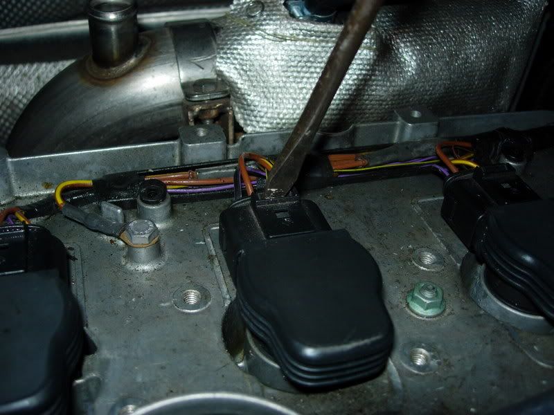

Step 4.& 5 With Flat head screw dirver. Place the flathead on the tab on the connector to the coilpack. And push backwards. Dissconnect all four.
Step 6. Coil Pack Removal.
-With use of flat head pop out each coilpack. This can be done with hands also. My engine was a little hot so i used this.
Do this to all 4

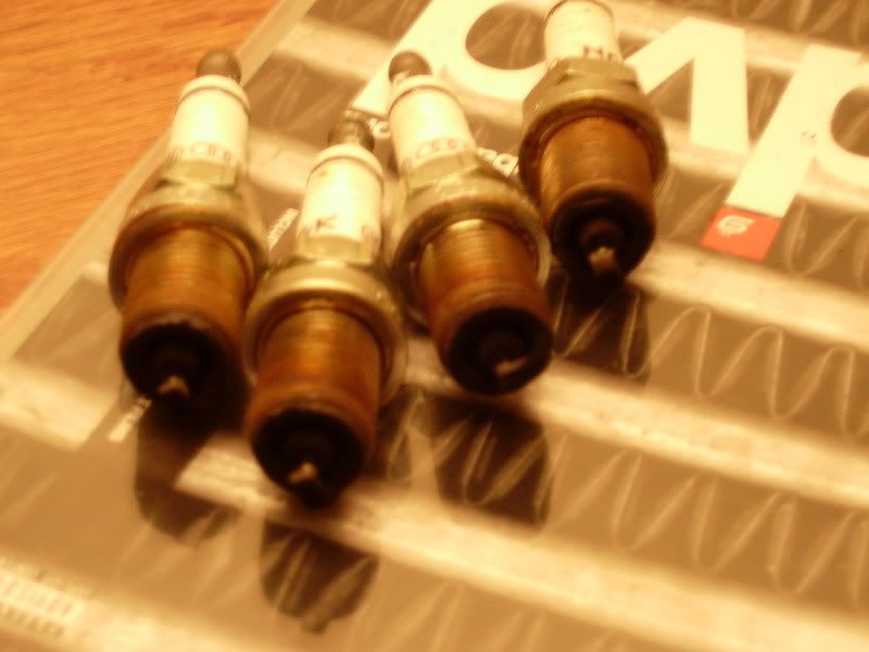

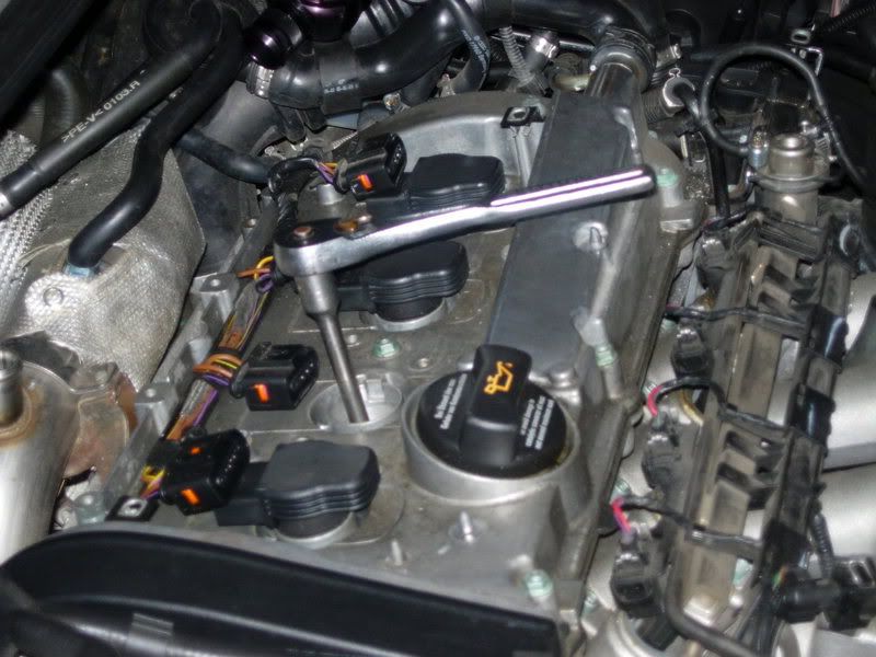

Step 7. Spark plug removal.
-With use of the Ratchet, extension, and spark plug socket Take out each of the Spark plugs. There in there a little tight.

ur plugs look a lil oil fould
