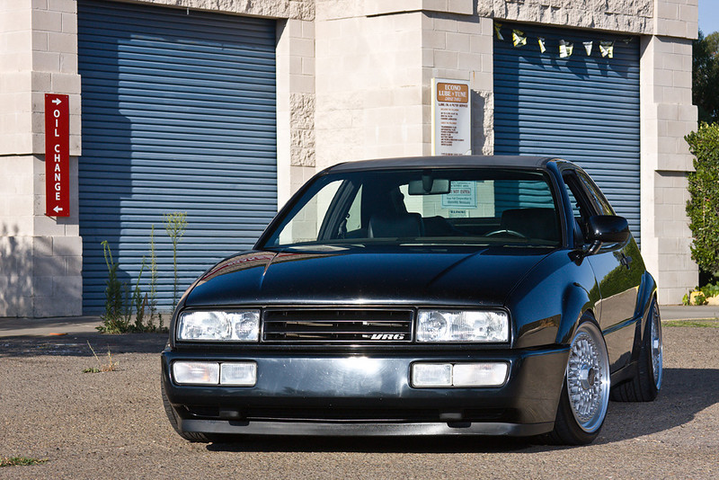

    Wheel specs:
    BBS, RX II, 5x100, 16x7, offset 35mm
    Spacer or adapter specs:
    H&R 8mm front (5mm requiered to clear DE brakes), 15mm rear (for looks)
    Tire specs:
    BFG, G-Force Sports, 205/45/16
    Brake specs:
    11.3 DE calipers front, stock SLC rear
    Suspension specs:
    VR+
    H&R sport springs, Bilstein sports (FWD)
    Body specs:
    VR fenders, untouched
    Clearance summary:
    doesn't rub in front
    doesn't rub in rear
    One picture (1200x900 or less) of the above setup:
    Modified by corrado-correr at 7:46 AM 3-21-2008
