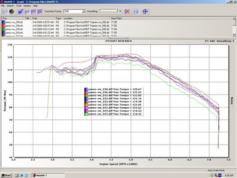

      jamesr88
      94 jetta
      150,000
      dyno jet/ university of northwestern ohio tech college
      ported obd1 upper and lower manifold
      dual valve springs
      t.t. 276 cam
      matching t.t. chip
      oem exhaust with test pipe and vr muffler
      rebuilt head
      mk4 lifters
      k&n drop in
      a/c delete
      power steering delete
      wrd poly mounts
      123 whp/122 tq
