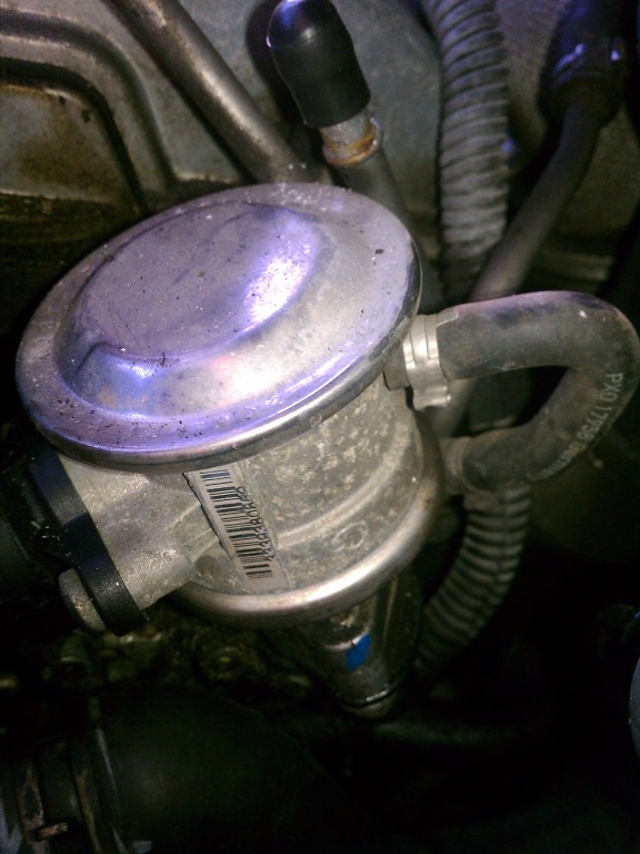

    The hardlines that I guess are bolted to combi valve, I can wiggle them like they're just sitting behind the combi valve and not welded to it. Can I remove the combi valve, remove those hardlines then put the combi valve back on the block? Wasn't planning on removing the sai or evap, just the PCV and N249 stuff.
    edit:
    Also, if I leave the combi valve on, what do I do to this hose that's on it that connects to one of the hardlines? Just cap it I assume?

    Yes, the valve is attached by the two bottom bolts, not welded. I don't remember the hard lines even being tied into the valve. I think they are just mounted on the coolant flange and are so close that it may be wiggling the valve. Remove the lower screw on the coolant flange and the hard lines should come loose. I think if you look back there the hard lines may be bolted down to the bracket attached to the valve, the bolt is behind the wires coming off the spark plugs. You have to disconnect the two clips and push back the wires to access the bolt.

    Yup, figured it out, forgot to update my post. The hard lines were bolted to the Combi valve. Unbolted them, removed them and put the Combi valve back on the engine. Capped off the line that was running to the hard line.
    Deleted the PCV, EVAP and N249. A few of lines for the PCV system were broken. Car runs much smoother now.
