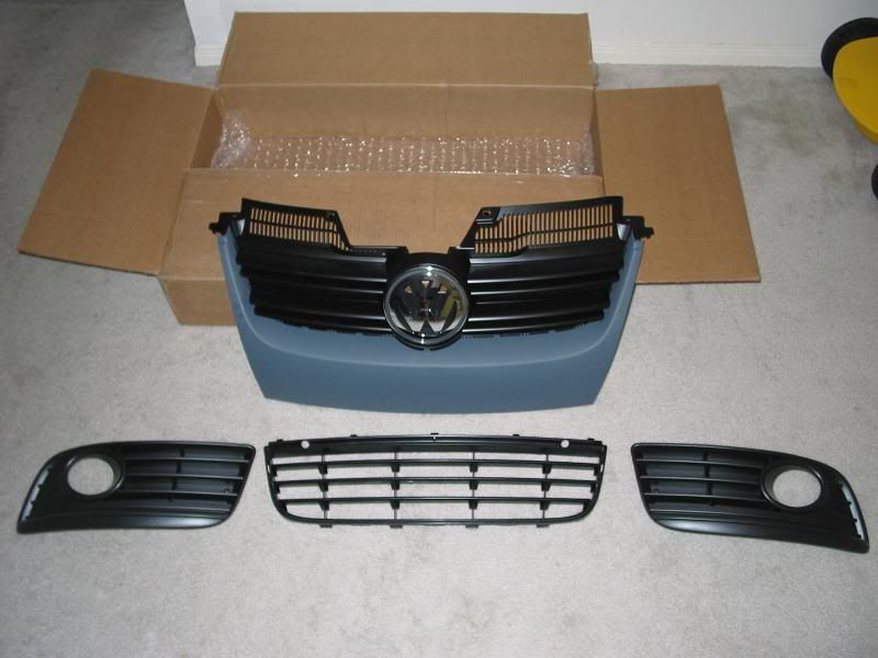

I ordered my kit from oempl.us. Here's what it looked like upon arrival. The front shield and lower trim piece are primered and can be painted whatever color you want.
The front shield and lower trim piece come separated from their respective grill pieces. They attach by numerous snap together tabs. These pieces are pretty flexible, but the lower piece can break easily (speaking from experience).

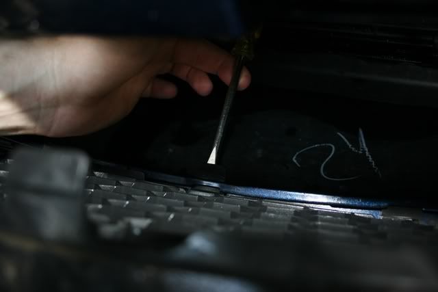

Here's the tricky part. Unless you have the lower skid plate removed, you cannot access the lower tabs from the bottom of the car.
I had to pull the top away from the bumper, stick my hand inside, and use a flat head screwdriver to help release the lower tabs.
I've heard some people just yank hard to remove the lower grill. I'm too wimpy and was worried about breaking something.
