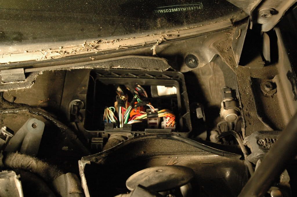

    The main wiring harness connectors are between the windshield and the hood. I didn't know how to remove the plastic panel covering the area. Then I found just pull hard. It came off.

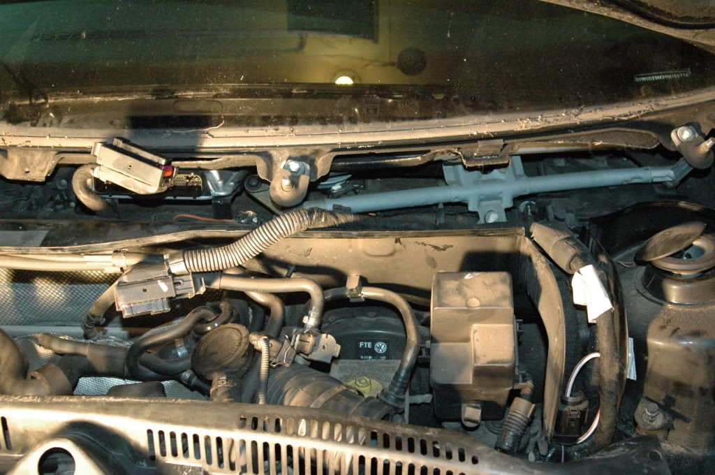

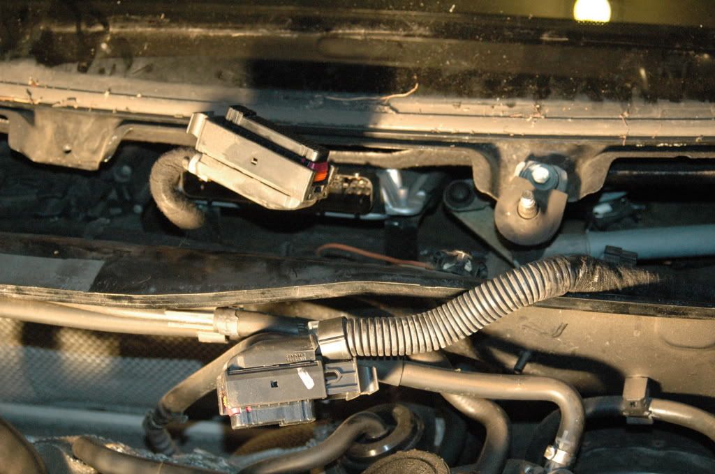

    Of course the windshield wipers have already been removed. The two main wiring harness connectors are in the center right in front of the windshield.
    The relays are connected to the main wiring. The wiper motor and linkages are in the way. So out they go.
    [IMG][http://i21.photobucket.com/albums/b274/yaofengchen/VW_jetta_2000/DSC_5152.jpg/IMG]
    The relays are inside a box with a plastic cover beneath the wiper motor and linkages.

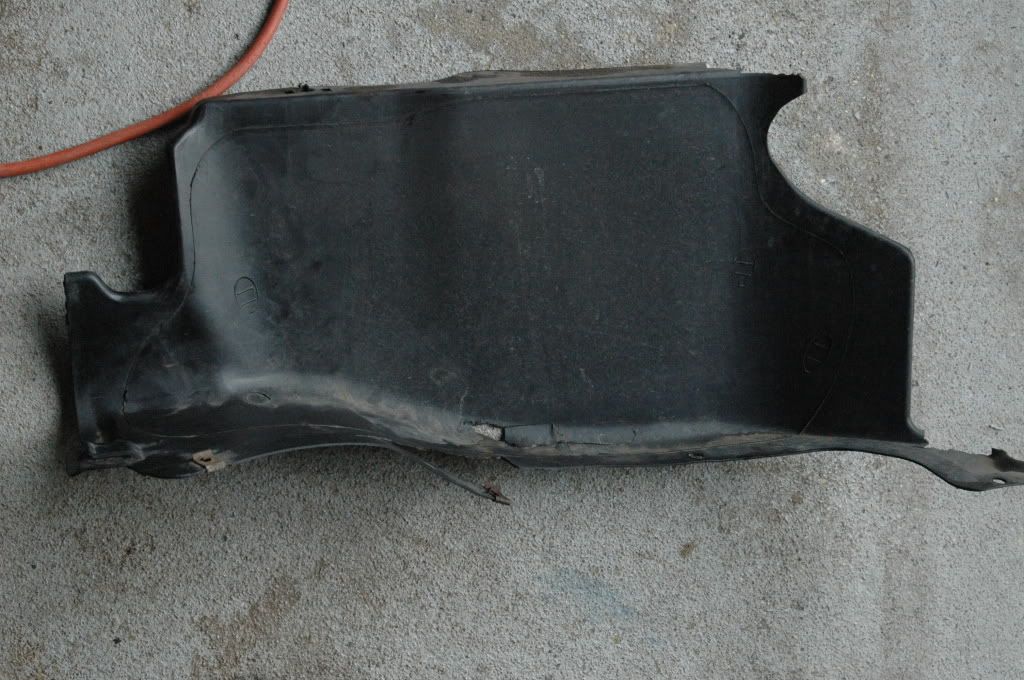

    Also is there a dealer mail order source for VW? Also is there electronic part catalog online? One plastic parts I removed was damaged. This is the plastic trim next to the intercooler. I would like to look up the parts number and order from the dealer. I don't think this part is available from regular parts outlet.

    i think u can get that plastic piece from dieselgeek. it may be modified to fit their skid plates but im not sure.

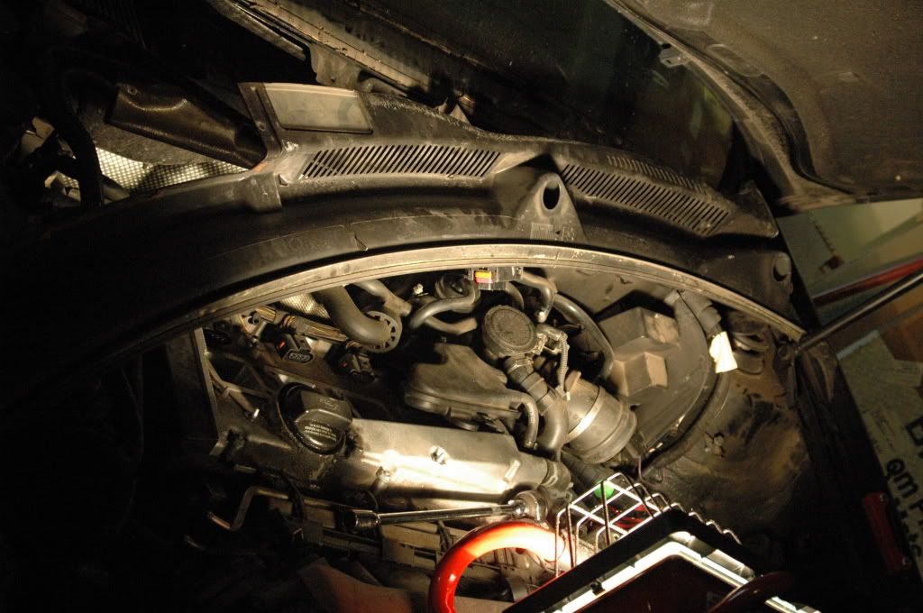

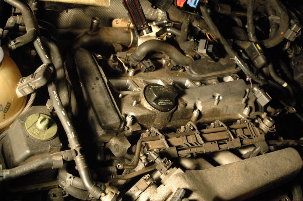

    A few pictures taken while pulling the engine.
    The engine on the hook on its way up.
    I had to cut two wires or the the engine can't be removed. These two wires are on the passenger side branching off of the wires to the O2 sensor.
