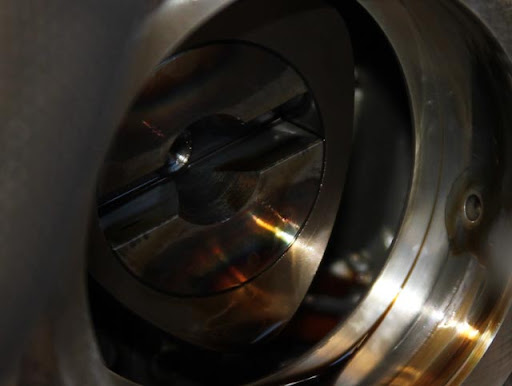

    My '07 GTI just passed 59,3xx miles, so I checked my cam and cam follower today. What do you guys think?
    This is the first time I have checked, and I am so happy to have Rev. B Cam.
    Is my cam follower in good condition?
    Thanks!

    Your follower and, more importantly, your cam lobe, look fine. I usually check mine at every oil change just to make sure it's not wearing out too quickly.

    Looks good....I'd change it for the peice of mind incase the metal is starting to concave and thin, it's $55 from the dealer. Good investment. I did mine, my diverter(thought it was acting up but it wasn't haha, still don't know what the noise is), and just ordered the revised oem pcv with breather cuz of some minor oil along valve cover gasket and some I think a bit too heavy of oil consumption

    Change it once the black material is gone. As long as its not concaved.. and cam looks good... and your not getting fuel cuts ur good.

    I know as long as its flat and the black protective surface is still in place you're good. I went ahead and changed it since it was apart, and the part is not TERRIBLY expensive.
    I still have 30,000 miles on my CPO warranty which covers drive train, but I don't want to deal with it going bad if it doesnt go bad until AFTER the warranty ends on me.

    I changed my cam follower at 55,000km (About 34,000miles) Currently have about 81,000km (about 50,000miles) Difference of about 26,000km (about 16,000 miles)
    Here are the pictures... looks a little much no in terms of wear and tear on it?
    Thanks
  35. 05-04-2013 10:14 PM #1085
    Did mine today,
    2006 A3 with 107,000km. The cam follower looks to be original, seems pitted in the middle, lucky I changed this because failure was immanent. There is no way I would make it to the extended warranty of 192k.
    I dont understand how Audi will only do something once it fails and I'm stuck at the side of the road.
    looked pretty bad.
    Cam look ok?
