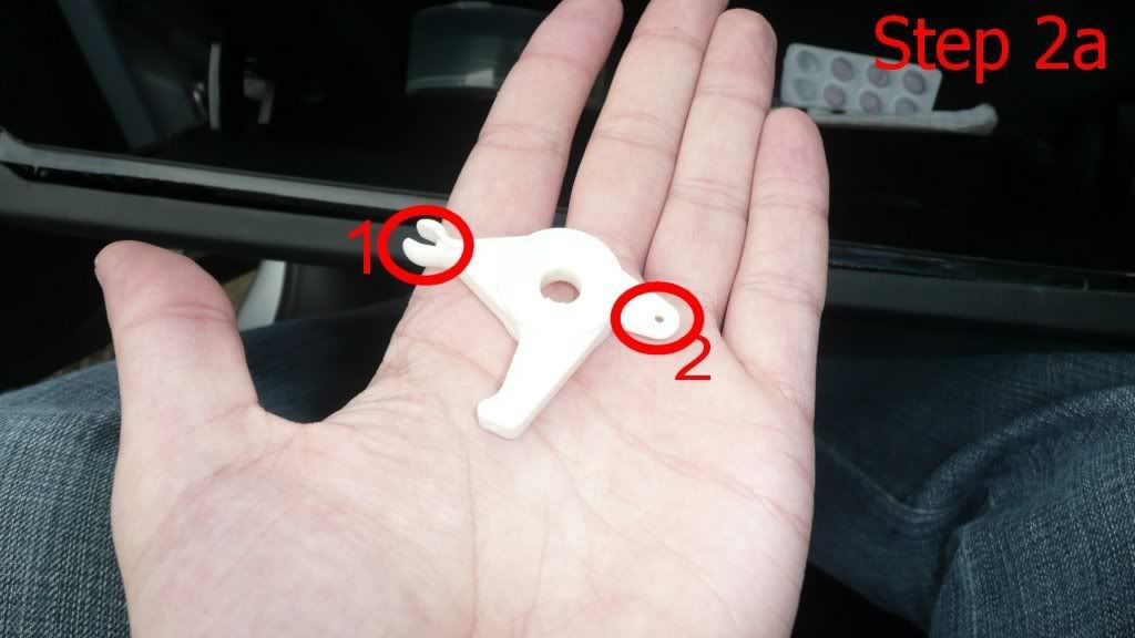

    Step 2 The problem
    (-) Here you can see the problem.
    (-) The small white hinge has fallen off the peg which holds it in place
    (-) There are 2 arms (to left and right in picture) which move in and out when you pull the handle on the front of the glovebox
    (-) With the white hinge out of place no movement takes place and your glovebox catches do not engage and hold the box closed
    Step 3 The solution
    (-) The fix is pretty simple
    (-) Attach the white hinge over the peg, ensuring that the part with the small hole (pic 2a - ring #2) is facing down the way
    (-) The 'teeth' of the hinge should be facing up the way so that they lock into end of the arm shown in pic 2b
    (-) Once you have attached the arm and the hinge ensure that the spring between the left and right white hinges is in place (this is fiddly)
    (-) The reason the white hinge fell off on my car was that the end of the plastic peg on which the hinge sits had half broken off
    (-) To fix this I fitted a small screw into the peg (pic 3) tight enough to secure the hinge but loose enough to let the hinge pivot
