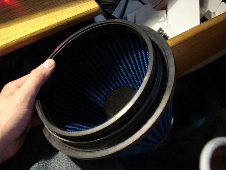

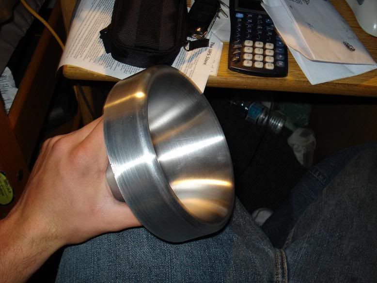

    Just got my forge velocity stack + filter. I was really surprised. The filter is very very good qaulity. As good as a K&N for sure.
    Looks good what are the dims on it? 6" inlet with 3" outlet?
  29. 06-05-2008 12:47 PM #30
    Quote, originally posted by DonR@Unitronic.ca »
    unfortunately the inlet is 2.5", but it is long enough that you can cut it where it goes to 3" and still be safe. That's what i'll do.

    Quote, originally posted by infinityman »
    So you'll get a 3" OD tube slip it overtop trace it, cut and weld a 3" stub?
    If i can find some 3" aluminum yes i'll TIG on a little stub to it. If not, i'll cut it and just use a coupler, it shouldnt slip off.
