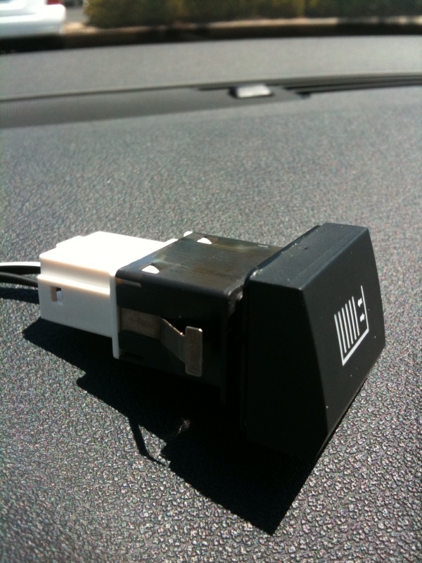

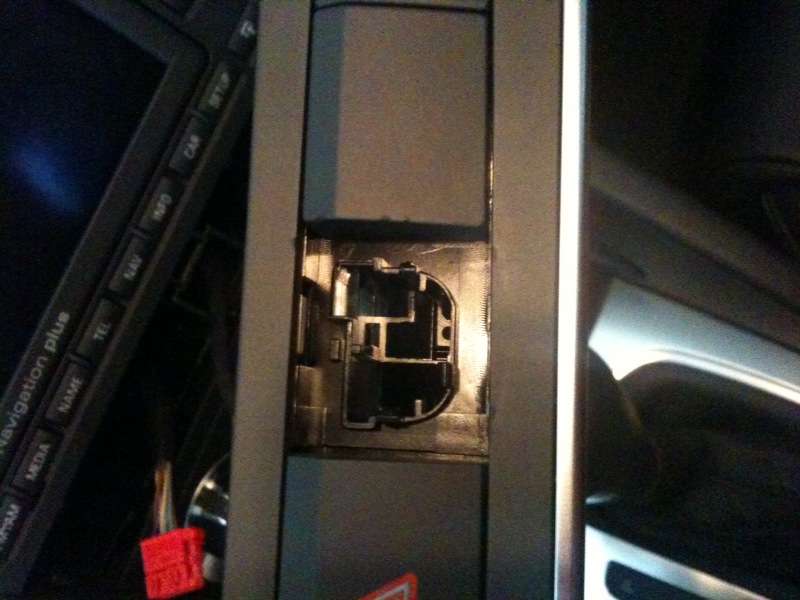

    Oh sorry. The pictures work great when I look at them. But It makes since. Take two.

    oh i see what you mean, square peg in a round hole.. not good my friend..
    what position and side is that button for?
    i would buy it PM ME! ..
    is the bracket that holds the buttons in place plastic or metal? looks plastic in the photo.. if so a lil dremel and might be good to go.
    while you had it out, did you at-least check if there was a power hook up for it on the harness?
    did you check the other spaces to see if they were all the same? thats a middle space it looks like, might be different.

    The housing is plastic. It would be pretty simple to use a drimal and cut out the plastic. The problem would be to line up the switch and secure it so that it is at the same level as all the rest and make sure the gap around the switch is even. It will be a little work and probably a little frustrating. The other switch locations on the right side will require the same treatment. the front of each switch is a different shape so you need to get the correct one for each location. DONT try to pry out the switches individually from the front. The whole switch assembly unclips from the dash as you can kinda see from the pic. If you look close you can also see the pry marks I left on the blanks when I tried going in from the front

    what about the harness? is there still a extra plug in for it to at-least get it some power to it?
    Yea it would be dremel and prolly some epoxy or something to get it to stay could also cut it a lil to small then squeeze it in.. again, ill tell ya what it would be permeant.. so o well to the next owner would have a button that they have no clue about.. hah. o well.. its definitely going to need a bit of time to work on it.. i guess for the newer face lifted cars..
