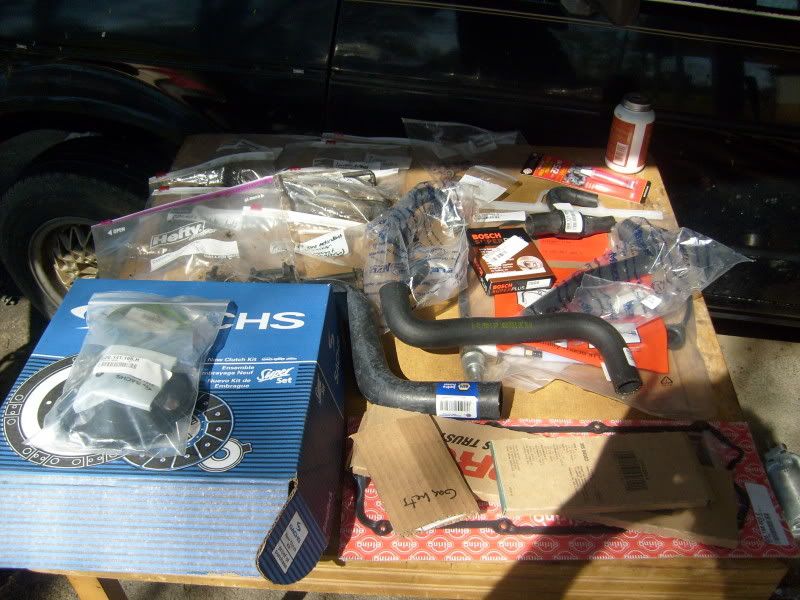

      Slowly getting there. Got the new clutch ordered, hopefully I can still make rent. Friday I got the cv shafts dropped from the trans with the help of a 3/8th impact. I tried out a product called "Freeze Off" on my exhaust manifold bolts and it worked great. Before I couldn't even get them to turn. About 20-30 seconds of spray from the can, waited a few mins, and they came off easy as pie. All that's left are the motor mounts and that puppies out.
      Now the problem is figuring out all the small differences and what I want to do. I'm going to end up using parts from both motors I think. Breaks down to something like this

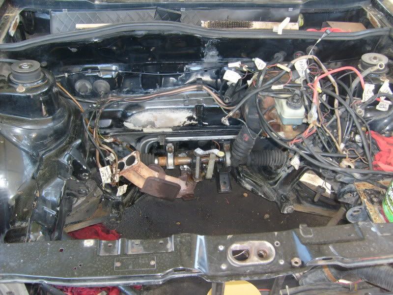

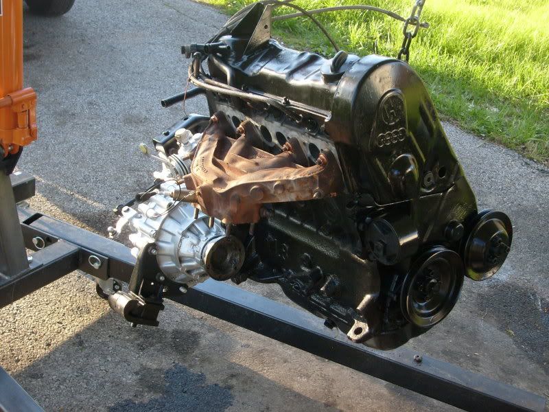

      Progress! Finally I feel like I'm getting somewhere. Clutch kit should be coming tomorrow and I can get the "new" engine and trans together.
      Up:
      And Out!
      Feeling very accomplished right now. First motor I ever pulled myself!

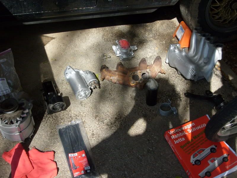

      Got the engine and trans cleaned up today. Also got both exhaust manifolds off and the dual downpipe cleaned up to go on the new motor. Did manage to snap off two exhaust studs, on the motor I'm using of course. They all came out just fine on the 1.7 though. Figures.
      Going to do the clutch and whatnot when I get home - I think. If the flywheel looks ok - is it necessary to get it machined?

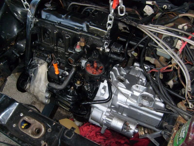

      04-11-2009 09:12 PM #39
      Progress! I decided that I would work nonstop on the Rabbit this weekend, weather permitting. Started by laying out most of the things that need to get put on:
      Decided not to paint the engine bay. It's just not in my budget anymore, I just cleaned the bay the best I could. I'm not going for a show car type look anyways. It's fairly clean though, good enough for me.
      Starting to look like an engine again! Took a big breath and started the task of putting it back in. I picked the wrong time to try and stop drinking!
      SUCCESS! I took this pic before I got all the mounts sorted out due to quickly fading light outside, but they're all in loosely now.
      tomorrow more reassembly, and maybe I'll get to hear it run. If I work quick enough, I should have the car running again by the end of the weekend. Either that or I'll find I just put a lot of work into a bad motor. Either way I've learned a lot and feel damn good about myself.
