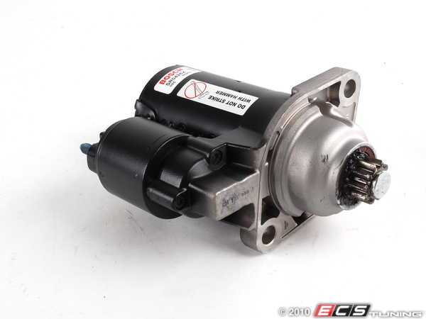

    DAMN My starter crapped out, no warning signs or anything... The starter has 12V constant power and I get 12V when I turn the ignition on the the solenoid Sucks... Dammit I suck at page ownage (quote from Lane)

    Weird, went to local paerts store and had them test my starter, it didn't work so bought one and installed it, still no go in my car. returned part and they tried it and it worked so I was like what the hell, had them try my starter again and it worked 6 continuos times... so got money back and installed my starter again, now comes a question for you guys that might have a clue
    1 I have a constant 12V at starter
    2 when I have my wife push in clutch and try to start car I get 12v to solenoid....
    3 if I get 12V to solenoid that means my cpp clutch pedal position sensor is working otherwise I don't think I'd get 12V to the solenoid (confirm if I'm wrong on that)
    4 checked grounds that go from transmission to chassis as in I have 12V from starter and ground to the wire on chassis, and I have 12V from starter to chassis ground....
    What the heck Any ideas are welcome

    06-14-2012 10:28 PM #11560
    ok I messed up I'm only getting 12mv to solenoid, not 12V... Stupid cataract surgery cant see very good close anymore... Gonna work on it tomorrow, Got a hunch its my clutch pedal position sensor or a different relay

    Try just running a jumper wire to the solinoid from the battery to make sure that everything is working... Have your wife hold the clutch just in case

    Just a bad ground, had to sand off some paint on the chassis and now all good, damn I'm an idiot
