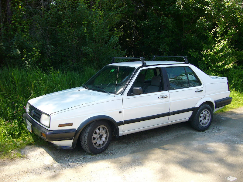

    That's awesome!! We too have a Diesel in need of some love, expected after 248k miles, runs like a champ though but leaks oil and diesel all over the place
    It does have Scirocco tarantula wheels and a few GLi pieces, including the infamous spoiler.
