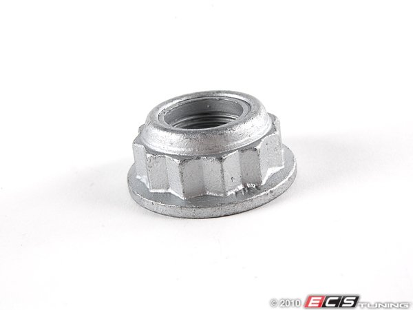

    Just to be clear, which axle nuts are the proper ones to use? These are the OEM ones, and they're about $10 each at ECS Tuning. Are these the ones with the nylon locking ring that we shouldn't be using? If so, where do you get the metal ones?

    German auto parts has a listing for 6 point metal lock nuts for those axles.

    This one? I'm not seeing any reference to metal lock nut. http://www.germanautoparts.com/Volks...ivetrain/309/5
    EDIT: Wait, that's the 12-point nut, but that's all I see.

    Thanks. Incidentally, I called them already this morning, and they said those were the only ones they carried, and he didn't even think they had a locking portion on them at all.
