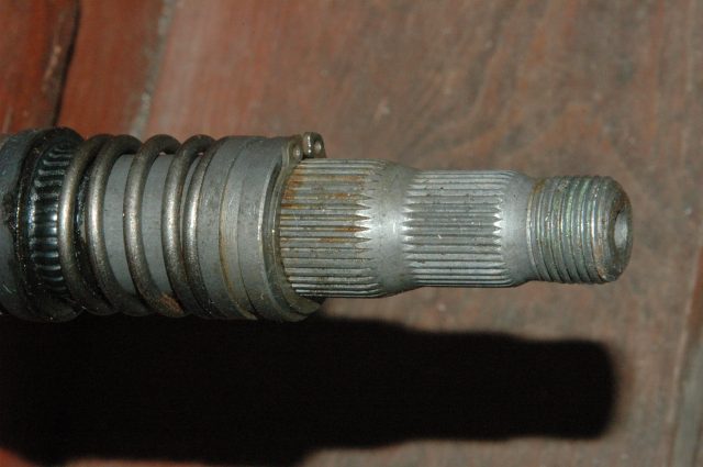

    This is what I meant..........
    which pictorially explains what I wrote, that the car in question has both splines, not that it's got the miserable press on sleeve of some other models.

    The double splined column shaft is too long for the turn signal cancelling cam and the horn contacts to work. The double splined shaft needs t get changed out for a single splined shaft, one horn wire needs to be addressed.
    Click the link in my sig, scroll down to the air bag section for more details.
