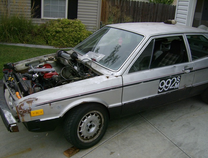

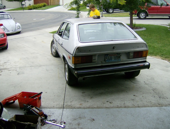

    Today is the end of a looooooong two days. Recap.
    Boise, ID
    1:20p Friday: Find truck
    3:40p : rent U-haul ( we would arrive at the Scirocco after the U-haul there closed)
    4:00p : leave Boise
    Seattle, WA
    11:30p : Arrive
    12:15a : Load car
    1:30a : Leave after shooting the bull with Rocco owner.
    Boise, ID
    10:40a : Arrive ( Co-driver after not sleeping a wink goes to Auto-X his Scirocco for the rest of the day "BoiseMKIGTI")
    11:50a : put $4 in a hand spray car wash to blast off all the moss and grime.
    12:20p : Drop car off at house
    1:30p : return U-haul

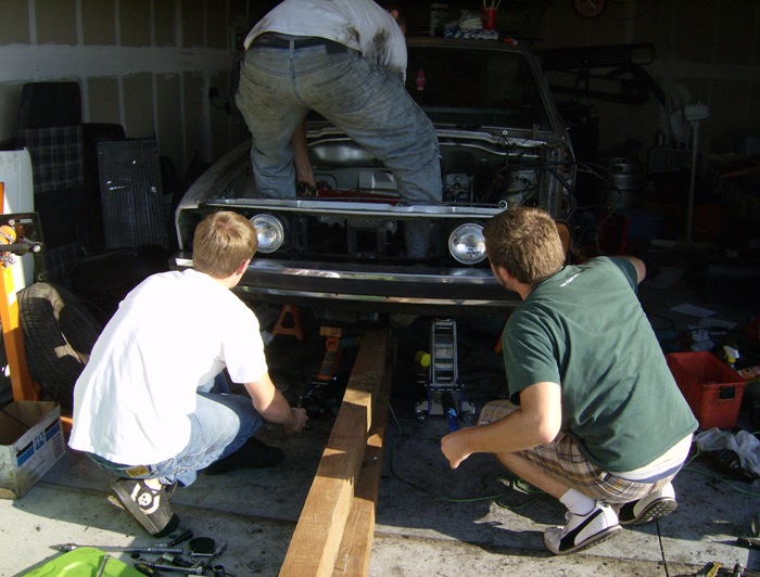

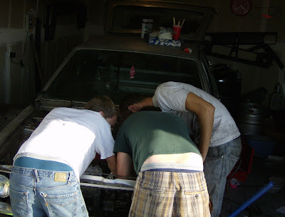

    3:30p : start jacking, standing, cleaning, ripping, unbolting hammering, and Crying (rust ).
    6:00p : Stock motor & Tranny dropped, frame lifted over ( two roommates and myself grabbed the front bumper and lifted the car above our heads! THAT is how light these cars are!)
    7:00p : Sit down.
    This is My first S1. In high school i had a S2 but did not know how awesome it was at the time and had it towed away for $25 because of fuel issues.
    So after lurking in the forum for a long while before I was a member, around 2004ish, I am glad to say that now I have a real project on my hands and it should be a lot of fun.
    Goal is a Restore with Auto-X and Hill climbs in mind. So clean but fast! I have a 2.0 16v that I will be tossing in ASAP, running it on MegaSquirt, N/A for now but one of the turbos sitting on my shelf will be used someday.
    I hope to keep this updated... but you know how it goes.

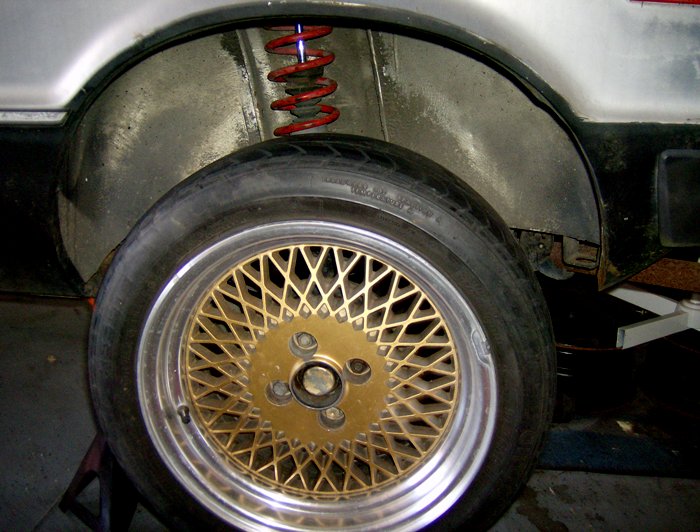

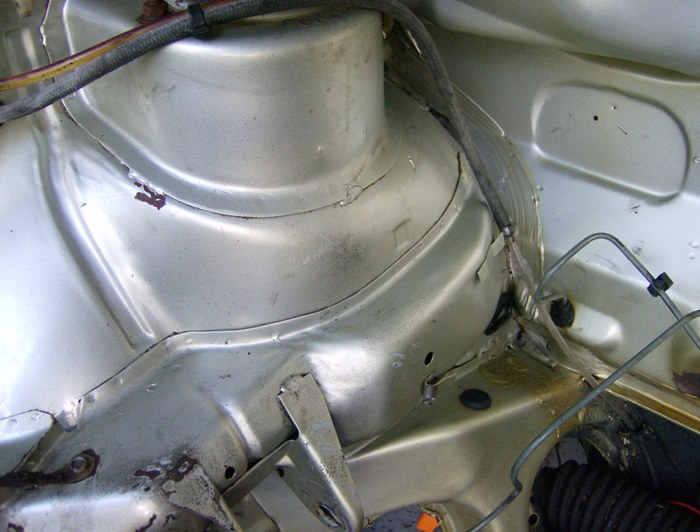

    Did some cleaning, and sourced some floors that I am going to go pick up soon.
    Night and day!

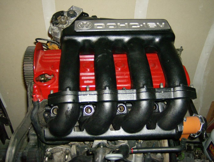

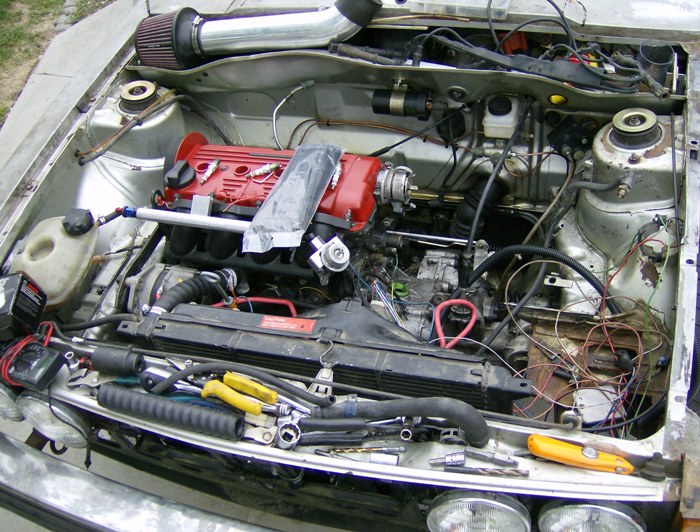

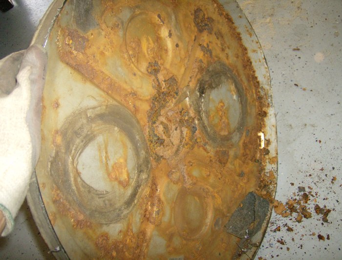

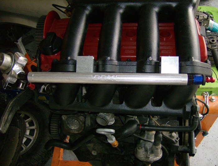

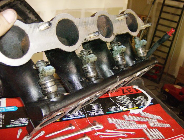

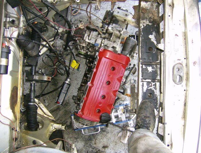

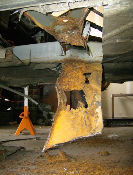

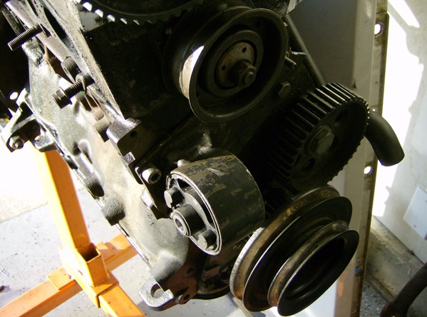

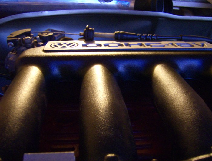

    did some work on the motor today and figured out what I want to do about all the rust. going the the junk yard tomorrow morning to cut out new parts.

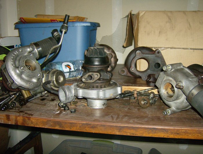

    And I'm making a Frankenstein turbo from these:

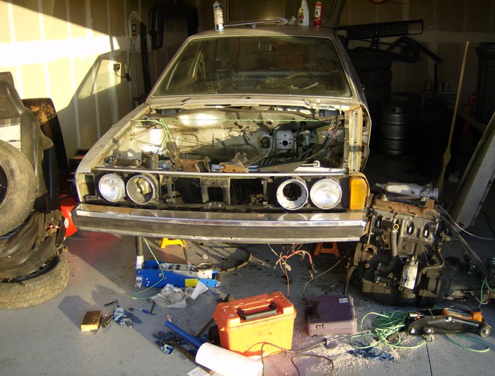

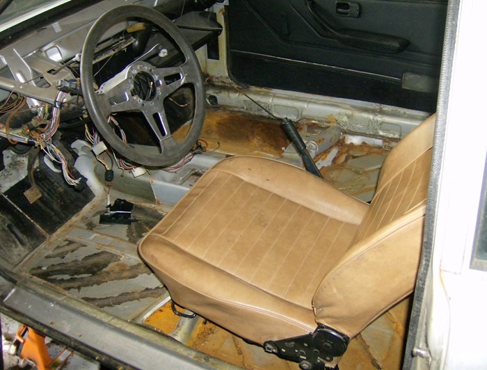

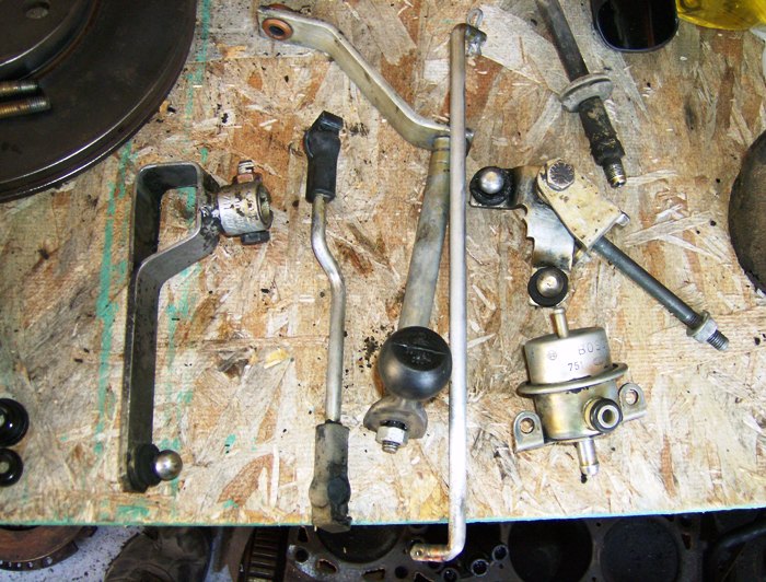

    Well another day down.
    Today I pulled.
    E-break handle
    Door trim
    ignition with a KEY!
    Motronic Engine harness
    Motronic fuel rail
    Motronic injectors
    Spare tire well ( to replace my rotted one)
    I kept having Sawzall batteries die so could not grab floor pans this time. Tomorrow I guess.
    Today I got antsy and mocked up seating and steering after putting the ignition on. I feel at home sitting in her. Except I am 6'5" and if i wear a hat my head rubs...

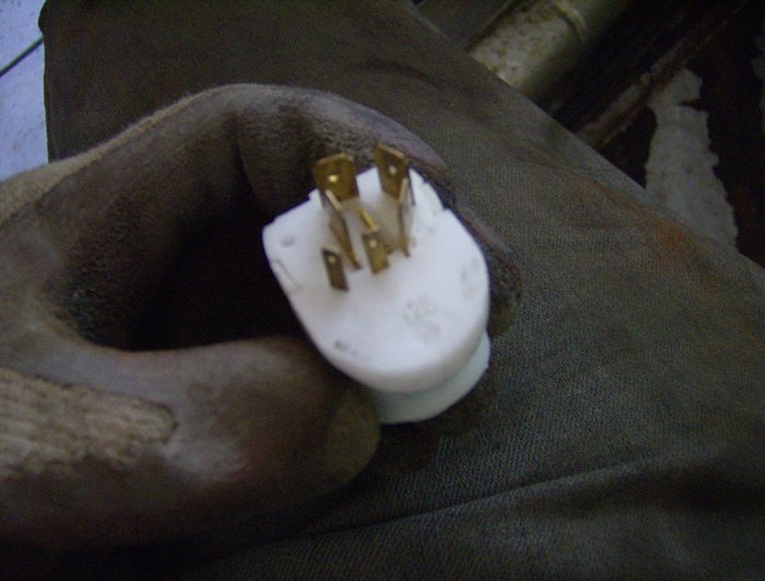

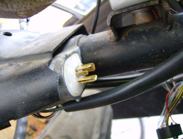

    Oh! a question I had was I pulled the ignition off of an MK2 Scirocco and the MK1 has an extra prong on the connector that connects to the dash wiring harness. anyone know what that extra prong does? but the MK2 is missing that prong. I hope it is not important!
    ** edit for connector shots*
    MK1 ( extra tab)
    MK2 ( no extra tab)

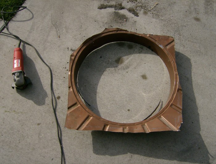

    More work done!
    This...
    Replaced with this the brown is nice pretty paint! (I'm sorry poor poor rabbit I had to vivisect)
    From this
    Cheers again!

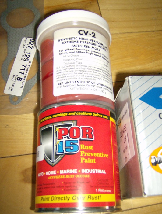

    ok Got some more work done and I got some supplies!

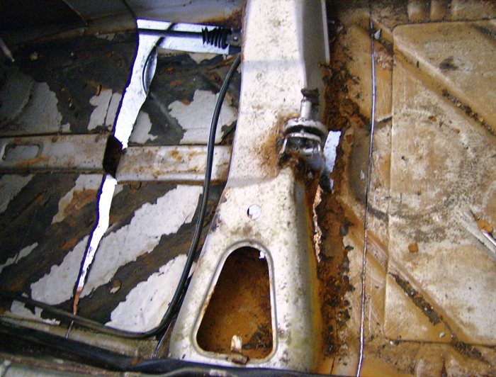

    Started cutting out the floor so I can fit the new floors I chopped out of that poor, poor rabbit. BTW WTF is going on with Rabbit carpet glue? It gave up quite a fight after being older that I am!

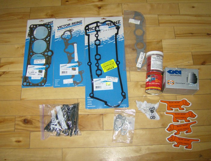

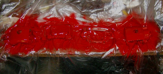

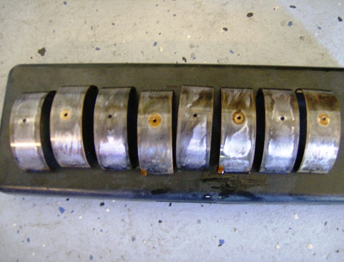

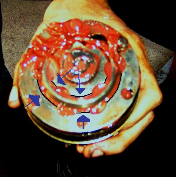

    Here are the rod bearings that where in the motor I replaced them as part of my motor refresh. Yummy!
    And here is the most important piece of work I have yet to do!

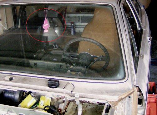

    My whole garage smells interesting...part moldy Scirocco, part some random air freshener.
    untill later...

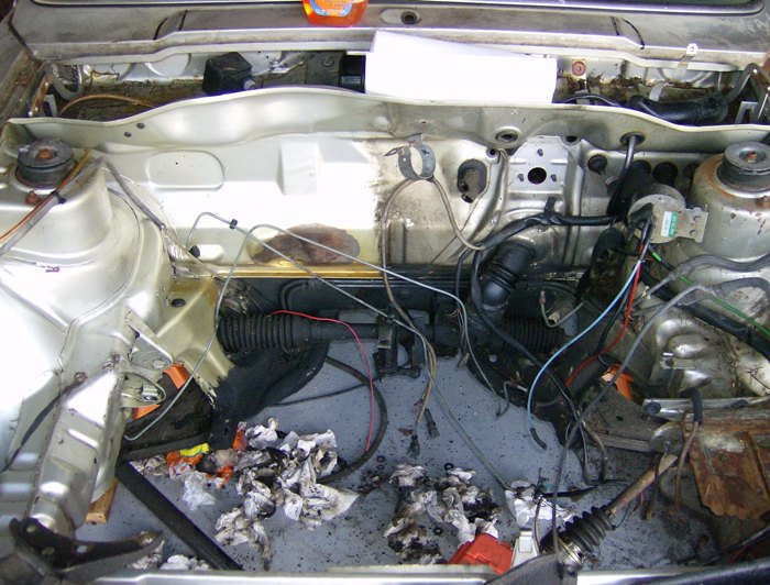

    SAT:

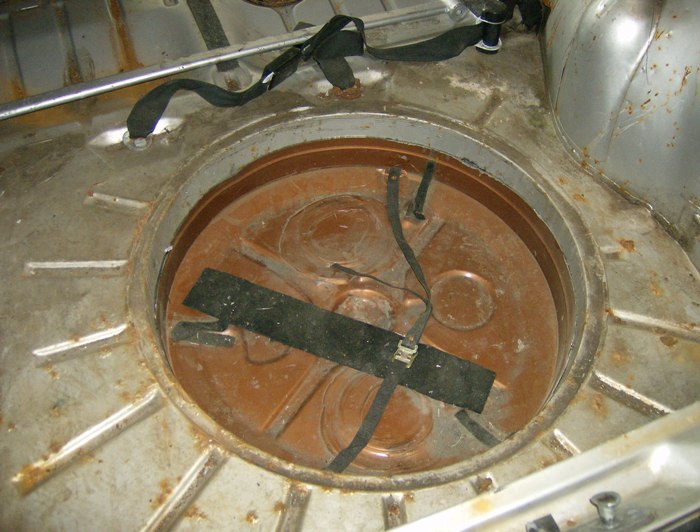

    Well floors and spare tire well are nice and sturdy again! the color matching is a bit odd, hopefully the POR-15 silver is close to the VW color. (not keeping my fingers crossed)
    In the fitting of the floors I broke a rusty brake line, I don't know how i feel about them running through the inside... oh well better replace them now instead of having them go out on a hill climb. To crash and be covered in break fluid is only insult to injury.
    This is exciting...! I pulled that ignition from a S2 Scirocco, it fit wonderfully, and it had a key in it. Well just for sh*ts and giggles I put the key into the door handles that came with the car. Low-and-behold! the locks popped.
    I have stumbled upon the magical Scirocco key that gives me the power to access any sirocco I wish.
    Pics later the camera ran off.

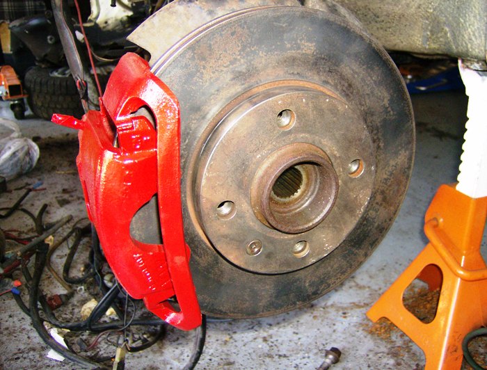

    and decided it was time to see these...

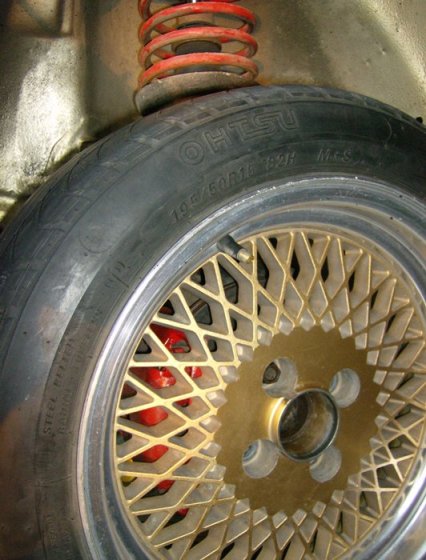

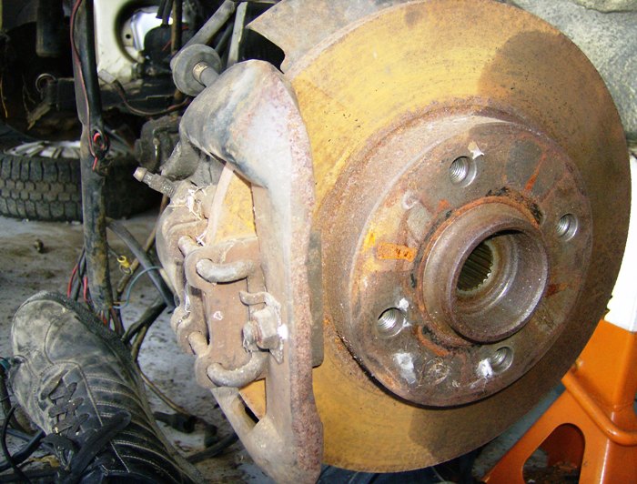

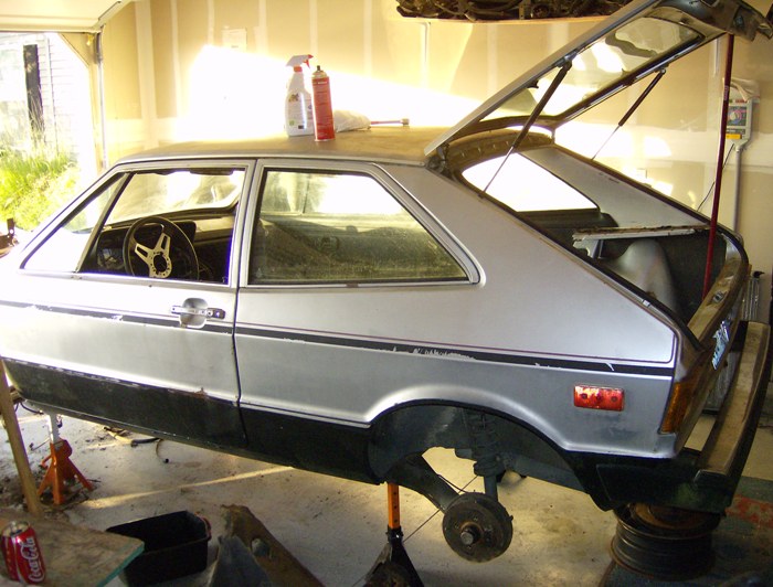

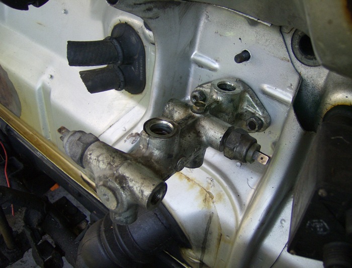

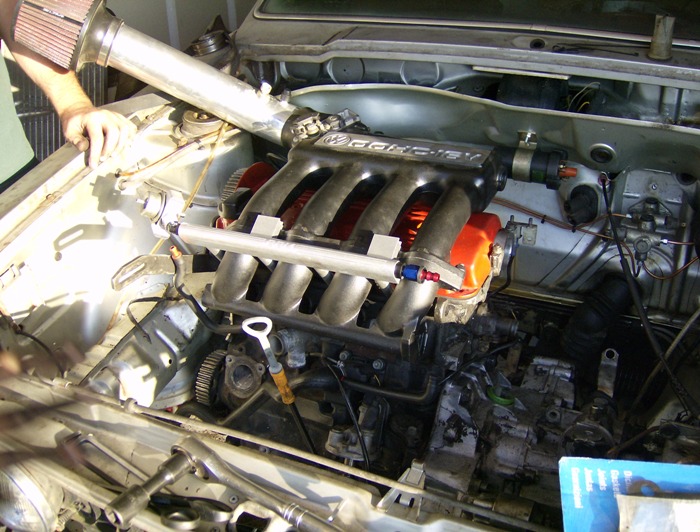

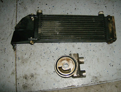

    Been doing lots of little things finally got enough of them together to make it work posting.

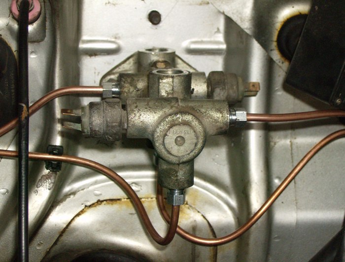

    removed old brake lines to have new ones made to length. I am still debating on weather to get a bending tool or not.
    Prepping the body for the POR-15.

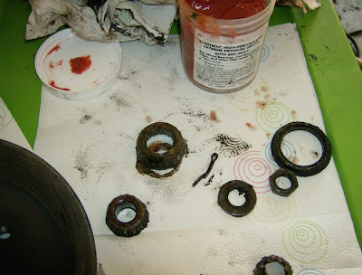

    Removed rear drums and re packed the bearings with Red-line high temp grease. Slightly tightened one drum so it stop wobbling.
    Took apart CV's and wiped them down then slopped on the Red-line grease. I have a ripped boot but I don't care at this point it is just get her on the road.
    Here is a tip: When Popping the balls back into the CV Line up so the inside ball retainer has the short sides to the long sides of the outside retainer. I got all the balls in with it the other way and it did not move at all. So do it this way the first time and save some effort.
    New brake lines tomorrow. new clutch tomorrow. Motor in tomorrow ( crosses fingers)

    Picked up the clutch disk and dropped off the lines.
    Fitted the motor mounts I love how easy he '77 mounts fit an '89 tranny and a '91 motor. Its like VW wanted us to swap motors.

    No brake booster. for several reasons. I did not have one. Weight. and the feel of manual brakes is nice.
    Got this together today too going to get lines fitted tomorrow, I think I am going to get them pretty long, so I can mount it in a location I cannot foresee just yet. and to increase capacity.

    Alright today started early with pulling a wheelbarrow full of parts from the junk yard.
    New MkII Scirocco brakes and rotors with lines.
    Rabbit shift rod
    Rabbit shift linkage

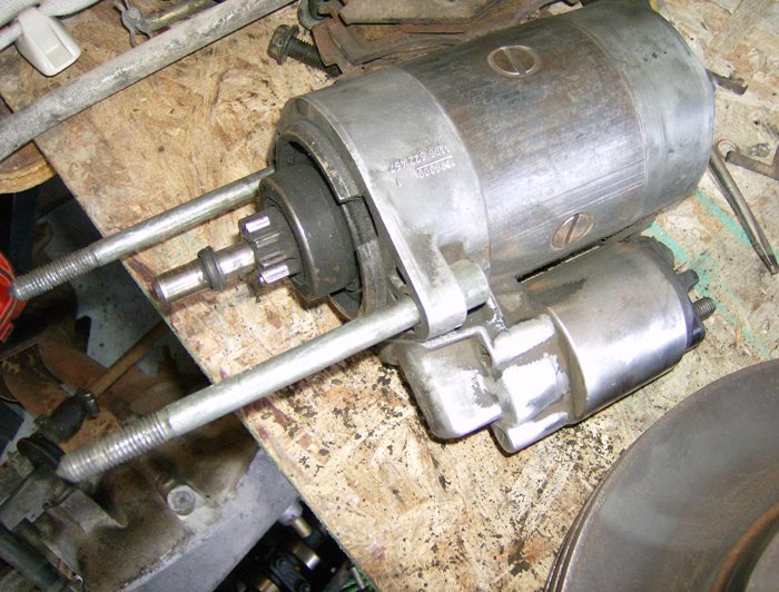

    Starter
    Brand spanking new alternator, this Jetta must of gotten it put in on the way to the junk yard.
    Picked up some G60 injector cups for the EFI system from the local VW dealer. The parts guy behind the counter had never heard of a Corrado! Let alone a Sirocco like my project. So after being disgusted with humanity I took my trunk full of booty back to the man cave to start work.
    Tip #1 Wire nut for an angle grinder. Get one it is amazing.

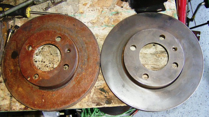

    S2 rotors:
    Before v. After
    Starter After, before it was BAAAAD.
    \redi8407/Misc?feat=embedwebsite">Misc</a></td></tr></table>
    Calipers scrubbed silver again and put out to paint...if you can see em.
    G60 cups installed into the base of my 16V intake manifold so that I can put electric injectors in. Such a brilliant idea so glad it was this easy.

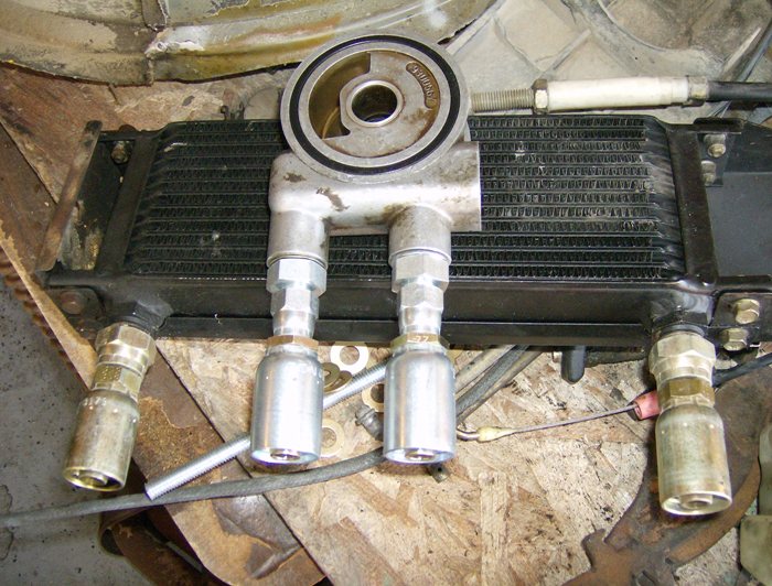

    New ( new new) fittings for the oil cooler... I cant afford the hose yet...
    S2 brakes, mocked up:
    Old brakes, mocking me:

    anyway I have been doing tons of little things nothing worth noting but today I got mail. So I busted out some projects.
    Brake lines bent, twisted, and fitted.

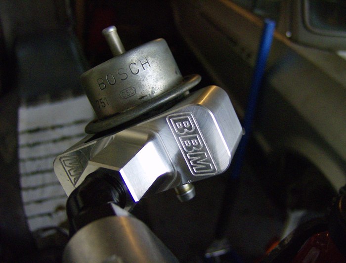

    and put on my new BBM fuel rail. I was tempted to buy the E-bay one, however I did splurge and I am SO happy I did. it is absolutely beautiful and is machined perfectly.
    cheers, motor in next now that brake lines are in.
    photos of that soon.

    MOTOR IN!!!!!
    **Edit after taking the motor helpers out to dinner**
    It was a day an a half today, the worst part though was the S2 Sirocco that I have been stealing parts off of was marked for crushing today :'( I'm going to try and save it on Monday morning.
    Three heads are better than one.
    tomorrow it is. fit up a lot of the little things. Perhaps toss in the interior. and CV's too
    Waiting on BoiseMK1GTI to put the megasquirt in with the wiering and I'll be golden.
    I also orderd a set of 215/50/13 R-comps to go on theses wheels.

    Those brake lines are pretty. But I hope they aren't pure, but rather the real thing. If not, let me know so I can take out a life insurance policy on you.
  28. 08-09-2009 01:51 PM #28
    That should have been:
    "...hope they aren't pure copper..."

    *shrug* I would not think so., but you never know.

    Copper from the household plumbing supply vs Copper-Nickel brake lines. Hundreds of PSI burst strength vs Thousands of PSI. Also, Pure Copper becomes brittle with vibration, then cracks, then...

    they are copper-nickel. I asked the specialty shop i got them from. They will also be getting me some nylon corded hydraulic hose for the oil cooler.
    I am getting really low compression and after talking to several sources we think that it is just dry piston rings so today is finish bolting on parts of the engine so that it is complete enough to add the fluids.
    Cheers,

    Hey have not updated in a long time! School has started up again and I am swamped and out of money.
    This build is now a budget build for the winter.
    As it sits now just need to finish wiring. I put fluids in her and it was amazing till I came out on Monday morning and found the puddle of $30 tranny fluid all over the floor, flange seal I think. So off with the CV's again, after I make the tool to get the cir clip off.
    Dropped it down on all fours and rolled it out!
