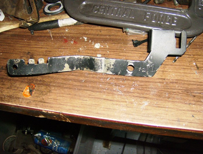

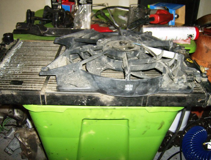

    ok the alternator set up works great the batt can keep the car running, however with the batt sitting at 12.63 still will not turn over the motor. I will be moving the batt to the engine bay to see if there is something causing trouble in the cable.
    I need to set up a time with the exhaust guys to get that done. Then I need to find a timing light so I can tune the MS spot on. then...well who knows really.
    BTW I miss summer when plastic did not shatter and metal did not freeze to your hands.
    Here are some photos of the setup.
    I got this by using the bracket that has the "arm" that sticks out, while the old one I had was flat. Normally when you see a non-ac and power steering set-up this arm is cut off and the lower mount is used. I had to keep mine on because the lines from the oil cooler run there. I do not see a downside to running the alternator higher besides needing a longer V-belt.

    Another thing I knocked out today was a slim radiator fan set up. This fan is off something, I have no idea because I just found it lying on the ground at the junkyard..
    But it has two wires to control it and it works when a battery is hooked up to it. It is very quiet BTW.
    so I took off my old one with the monster shroud and as you can see it is not big enough to fit across the whole thing. I looked around for pieces of wood.plastic, or metal that I could make a bracket for.
    and I came up with this:
    It is a holder for the old Steel braided CIS lines. I pounded it flat(ish) and gave it a little bend to put force on the fan to hold it in place.
    I painted it black so it did not stand out too much. That thing just screams jerry-rig.
    and here is the slim fan on the radiator next to JUST the old shroud.
    I saved about 5 inches of engine room.
