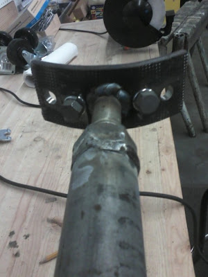

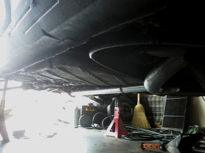

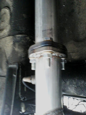

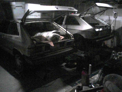

    I finished some stuff on the car I also found some groovy stuff in the local yard

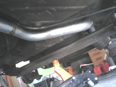

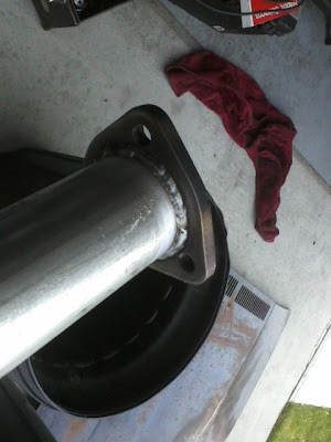

    Here is the finished Downpipe, turned out rather nice
    (Sorry all the shots are Cell phone shots)

    If the taillights are uncracked and the hatch is a non-wiper as it looks in the pic it would be worth your time to go pull them and sell to help fund your project!

    Quote, originally posted by Rocco_crossing »
    cool! there is one more silver one in the yard. Pretty bad front damage. the other one has striped lights. I cant tell if they are raised plastic that has been painted or tape that has faded. I don't want to poke it to much. I can grab photos at a later date
    I would give the lights on that car a 7 / 10 if you have greater interest I can grab them in short order as well as photos of the other Scirocco.

    Today I am doing more sanding and toss some primer on the shaved side markers, Exhaust should be finished today.
    Next large thing is getting the title figured out and finding someway to get the brake lights to turn on!
    *Edit*
    Well Exhaust got pushed back till tomorrow so I bolted up the new downpipe and hooked up the Wideband.

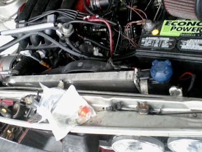

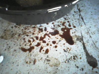

    Here are some photos of progress.
    Here is what the gas in my 79 Looked like when I started draining it.
    and here is what the MK2 sirocco radiator looks like in there, A much cleaner install.

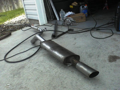

    Exhaust done! it sounds great! now it is MS issues. I am getting Wideband readings now which should help!

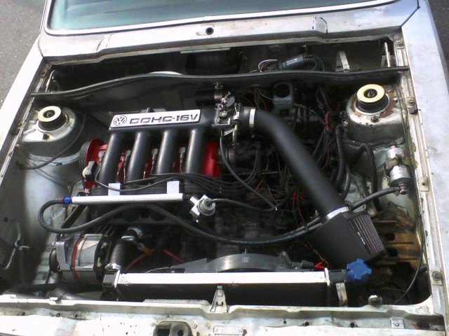

    Well got the Megasquirt working well enough for an idle at 1200 RPM. Let it sit on idle and I crawled around listening to everything making sure things were working, everything sounded great!
    Right now the Fuel pump relay is clicking very rapidly and I am looking around on the enterwebs for a solution.
    I have a rip in my Pass side CV that tosses grease on to the exhaust manifold and junk so I am tempted to get some new ones. Replacing the boot looks painful.

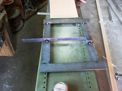

    05-02-2010 10:03 AM #82

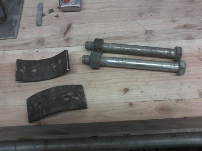

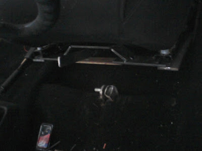

    I started on seat brackets for the Race seats.
    This is the first test. I put them in and marked out how I needed to change them. I need to drop the front about 2 inches so I can steer, and I need to trip the sides about 1/4 inch, I also need the back to sit lower as my hair brushes the roof and no way would a helmet fit.
    So until I go back to work on Monday and re-weld it It is small stuff. I might put the dash in today!

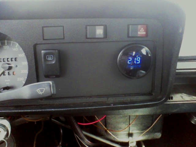

    05-07-2010 02:38 PM #83
    Whew! I found it. ( you know what I mean)
    Well so far I can count on one hand what needs to be done to drive it around my neighborhood and hope it does not explode in a ball of firey doom.
    Install Dash.
    Put Tires on it.
    Make sure the fan fix will lower temps.
    Give it a scratch on the head for encourangement.
    Cross fingers.
    If all goes well it will happen this weekend. Although mom comes first!

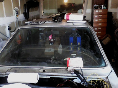

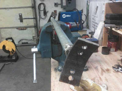

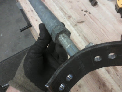

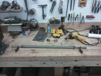

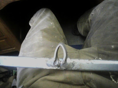

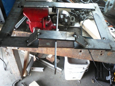

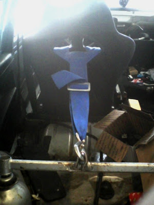

    Here are some welding projects that I have finished.
    Seat brackets( Tacked)
    Seat belt bar/Rear strut bar.
    Quote Originally Posted by george.redinger View Post
    Brain stools are brain farts gone wrong.
    Scirocco Build
    Scirocco Trailer Build

    Nice progress! One comment though. Please rethink that rear brace/seat belt bar... With a small amont of forward load (crash and the driver being supended from the belts) those shockmonts will fail and your belts will not be attached to enough to stop your body.
    -Kelly
    -Kelly
    yeah this is just mock up. I will be cutting back the bar so it will mount to the body on the shock towers and putting a curved piece of steel to support it then welding it all up.
    Thanks though!
    Thanks though!
    Cool! Just want to keep us all safe! You know, people who like sciroccos are a rare breed and we can't afford to loose any.

    Lol! Thanks I also have the stock seat belts in so I dont have to do up the harnesses for a trip to get milk, which will be no good because it would be cream by the time i got back. (get it muahahahahah)

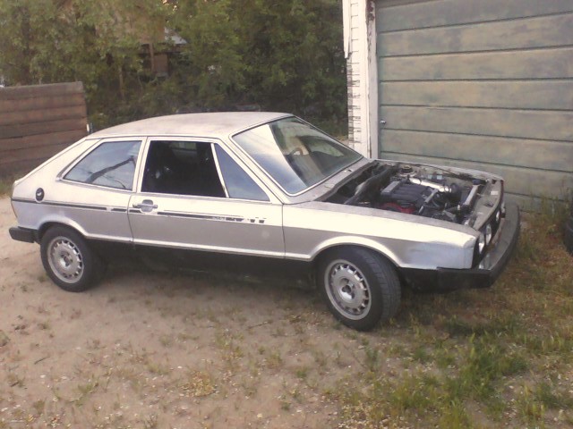

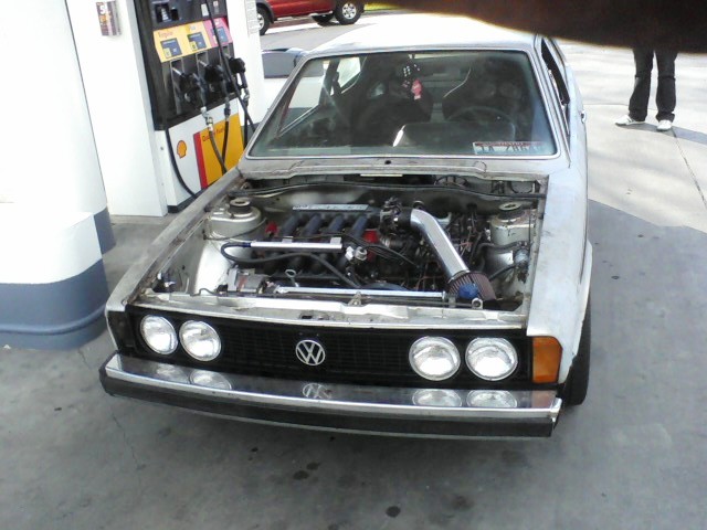

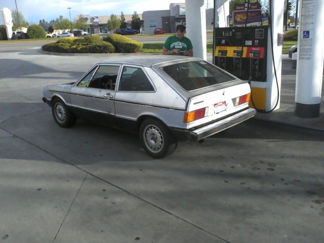

    Well Ladies and Gentlemen after 44 Weeks and 4 Days I drove it around the block! This is the FIRST time I have ever driven a Scirocco( 4 AutoX runs don't count ^.^)
    It ran SO great that I took it to the gas station down the block. put $15 and drove it back. Nothing flew off. Nothing exploded. No deaths that I know of. However there is a bad motor mount somewhere( I think the rear) because it bucks pretty bad in first when easing the clutch in, and it bucks really hard when you let off the gas and leave it in gear.

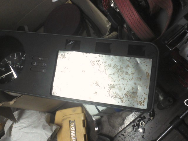

    Dash panel.
    My buddies son loved the Scirocco. That is a test fit.
    and paint. I like it.
    Okay maybe I got crazy with the paint, but I think it looks better. Chrome
    I have been driving it everyday! Here are some photos of it in the wild!
    Driven it 70Km so far! (~44 miles)

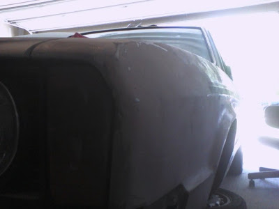

    Body work :/ I dont know if it looks much better after I spent HOURS on it but meh.
    yesterday I had the front end in the air trying to find out why the Drivers side wheel is 2inch more to the back of the car than the drivers. I had not turned it over in two weeks so I sat in it and turned the key and it fired right up and held an idle(this is strange because I am still playing with tuning and it hardly ever starts on the first try and the cold start is messed up) So I took this as a sign that it wanted to go for a "walk". So I dropped it down on the "new" (tires that are not bald...yet) tires I got for it and took it for a walk it will not soon forget.
    Right now I am putting together the race suspension, in my head and on paper till I can afford it. So it is just sitting around.

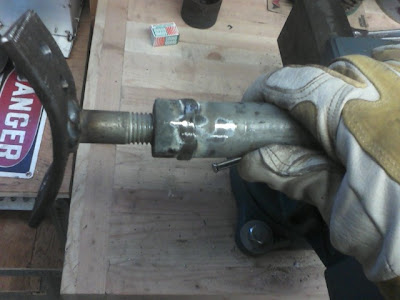

    I spent 5 hours yesterday on one strut. Finally got the damn nut off. The allen stripped out in the first 5 seconds Bent three channel locks, went out and bought a pipe wrench that did nothing, wore a hacksaw blade to nothing. They are un-destroyable so why do the allens strip so easy!
    but I got it off and now the scirocco does not dip and wobble 6 inches when you push the bumper, and bottom out on a single piece of gravel in the road. Now going to go test it on the twisties!
    I need someone to run the laptop, but my laptop monkey is still sleeping :/ Well a strait piped Rocco does do some hearing damage, lets go rouse him!
    Quick photo update.
    Dont worry the hood is not staying, it is pitted from rust too badly to save easily.
    Trying to fix the fenders.
    Until something big happens

    Use a "Heat Wrench". Heat up the nut you are trying to remove, that may break it loose.
    Weld a larger nut on top of the one you are trying to remove.
    Bang your head on it for 5 hours. :banghead:
    Google it. Do the google before going blind from the head banging.
    http://www.crankshaftcoalition.com/w...tuck_fasteners
    Borrow a geologists hammer from the office and do a "Shawshank Redemption" on it.
    No matter which method is used, enjoy the process. This is all for fun right?

    slow day at work today So I made this!
    thanks to 531sb2 for measuring a rear strut bar for me while I was at work. 53"3/16 is what it ended up being.
    Some paint and it will look great!
