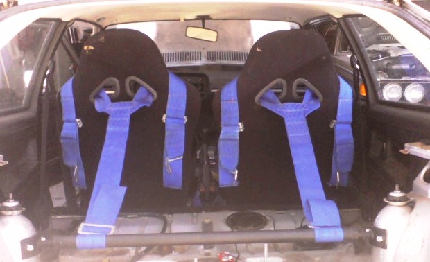

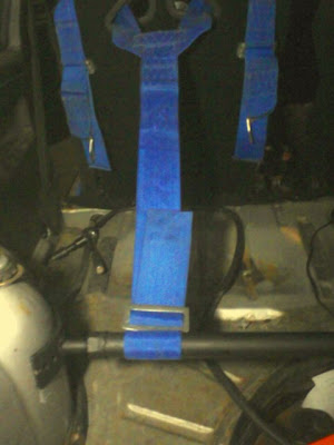

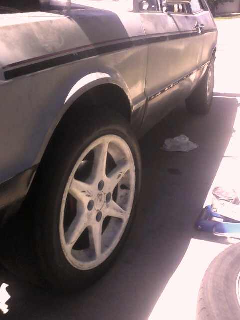

    I worked into the dark last night. Here is what happened.
    Paint
    after it dried

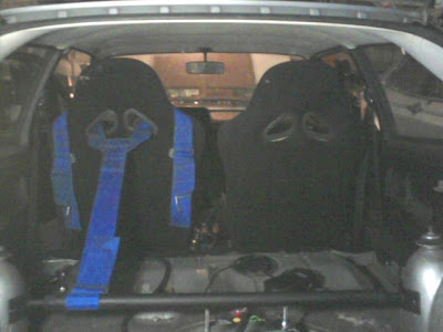

    Got the harnesses bolted in.

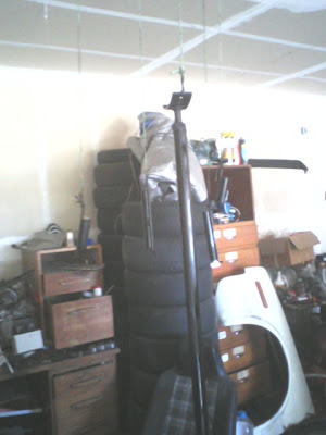

    The reason I wanted to do this is because there is an Auto-X coming up and I want it to be ready for one race this season. and the drivers side seat belt did not lock if you tugged on it, this is a part of the Tech Inspection for Auto-X so I did a push for the harnesses. However! When I was bolting up the lap belt for the 4-point I took the back portion of the stock seat belt out to see why it was not locking. I looked at it for about 5 seconds then gave it a hard smash on the floor. Now it works perfectly.
    I plan on bolting in the Harness bar today bolt up the other side and get the seats mounted better.
    I changed the oil the other day so I might play with the tuning and take it for an extended drive.

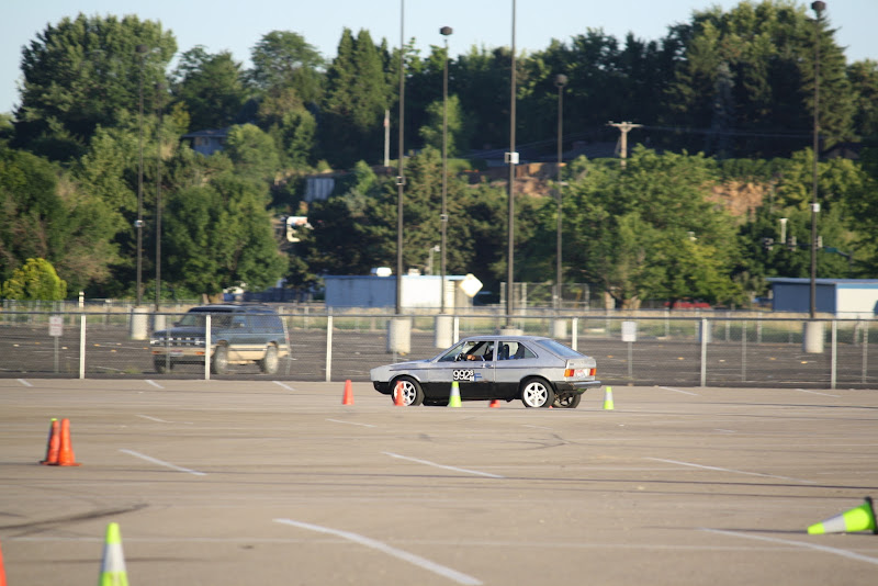

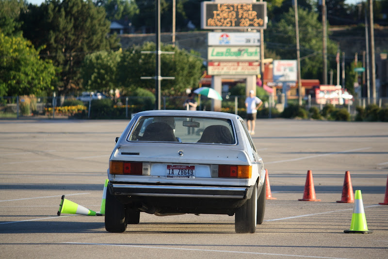

    Here are some videos of the event.
    There where 9 runs these are in order from first run of the night to near the last. I can see improvement! Still needs work though.
    and here is a photo A buddy of mine took.
    And one from Mr. David

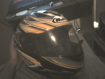

    got a helmet today so I do not have to keep using the common helmets at the events, also I am planning on hitting up the Bogus Basin Hillclimb on the 4th and 5th of September. So I am gathering safty gear.
    The helmet is a SNELL 2005 making it good for another 10 years and I got it for $35 on craigs list! SCORE!
    bad thing is that i have a hard time fitting in my car with a helmet on, any helmet. my head hits the headliner. I need about 2-3 inches of clearance. I will be playing with my seat bracket, but hte big question is should I re-move my headliner?
    By SMF rules it should be in there, but it is just a thin peice of cloth streatched accross the roof. the biggist thing that kills me is that the headliner is in almost perfect shape. There are some rips near the back by where the parcel tray would be but that is it!
    do I have the heart to remove it so I fit?
    Let me know what you think. I also need decal location ideas

  10. 08-06-2010 11:25 AM #115
    [QUOTE=Brycejoseph;
    Cheers,![/QUOTE]
    Option A:
    1. Remove headliner
    2. Stretch a bump in the roof where you head goes
    3. Replace headliner, stretch and glue into the new "Helmet cave"
    4. Put a decal on the roof bump
    Option B:
    1. Grind the highest point of the helmet down to fit.
    2. Put a decal over your work
    Option C:
    Make a Convertible
    Option D:
    Lower the seat
    (Boring option)

    yeah Option A & B put me in another class.
    So as of right now it is C or change my sitting posture.

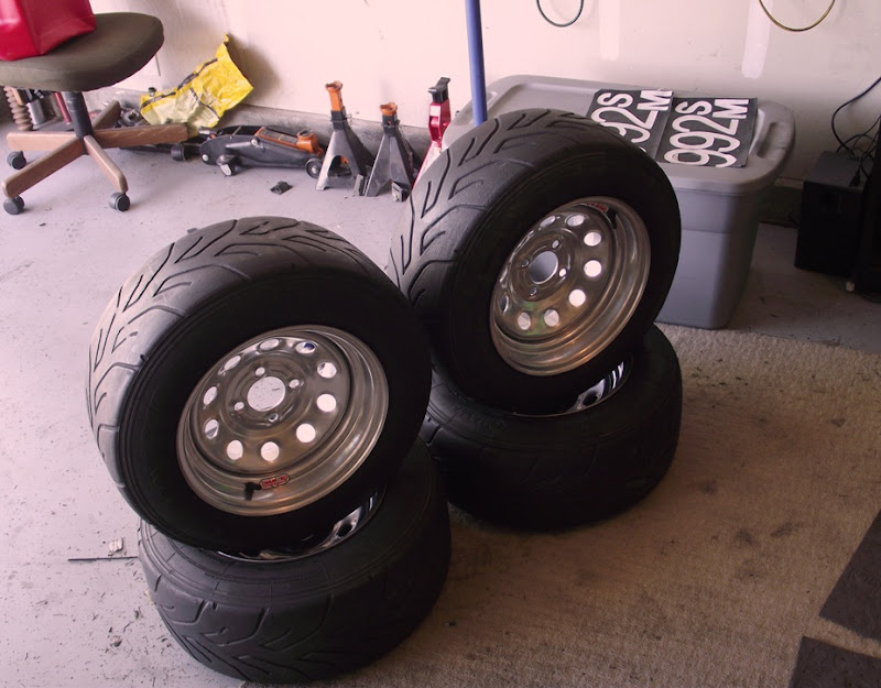

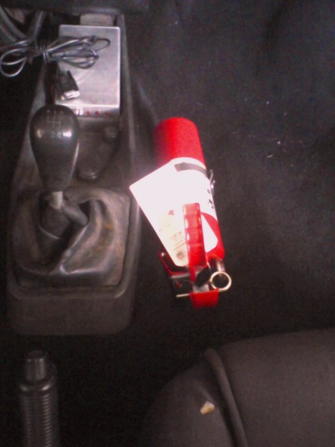

    some little updates! I am slowly collecting safety gear for the Bogus Basin Hill Climb at the start of next month.
    some more gear

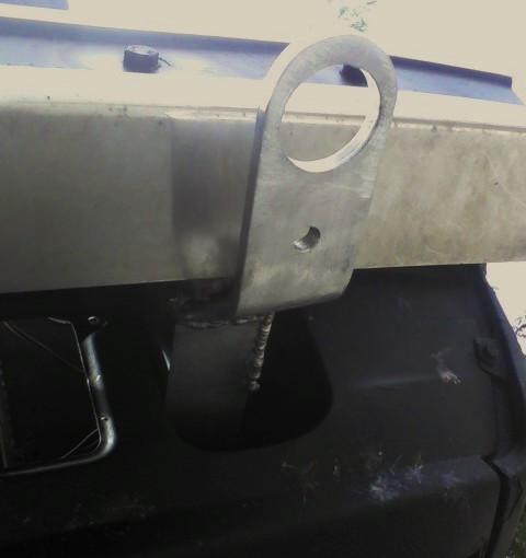

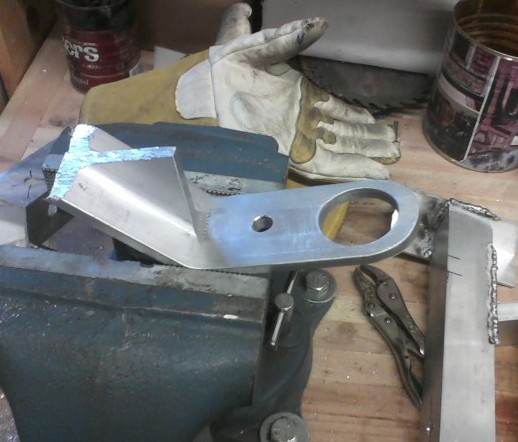

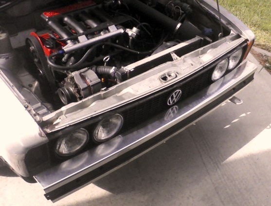

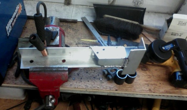

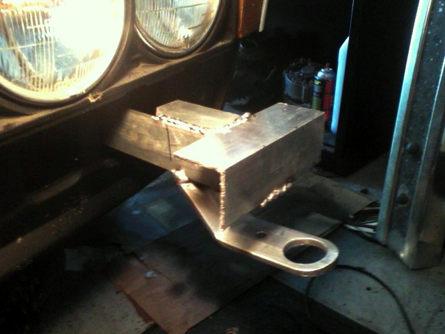

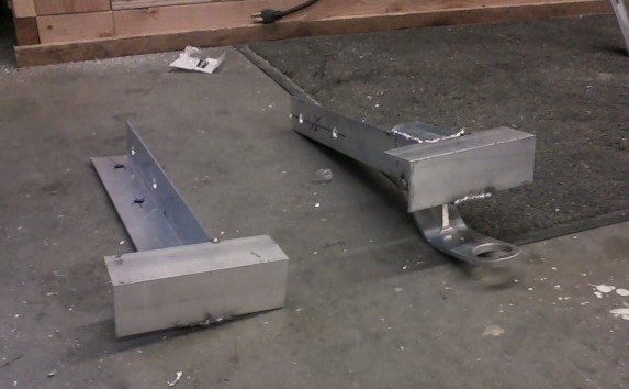

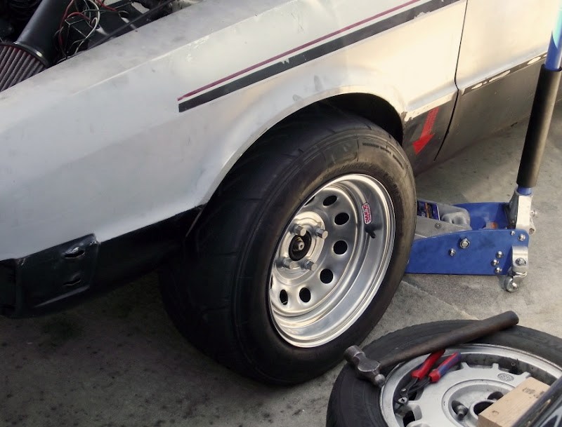

    okay I got some very cool stuff done today!!! and I think it looks SUPER sweet!
    as all good ideas start out ( some bad ones too)

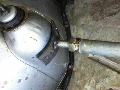

    Then I started the cutting and fitting.
    Then welding, I don't like the way they look but I double seamed even triple seamed some places for strength, so not pretty but strong. I don't know why this aluminum did not want to get the pretty welds I try for. I spent 45 min adjusting on cutoffs still nothing. lots of tight spaces too i guess, I am kinda embarrassed
    I was off work at 2pm today due to being in the field for a long day yesterday. SO I started fitting to the car.
    And finished product. re-sprayed the black stripe in the center of the bumper for a little freshen up, I love the shortened bumper look.
    This is not a functional bumper as the stock one is. There are no dampers as you have seen. ALOT less absorption. I would not recommend doing this on a street vehicle, even though I do drive this to events. I am allowed to ignore myself , but you! you are to play it safe and jazz.
    That being said. This is a Rabbit aluminum bumper it weighs next to nothing, and does not rust. The stock bumper broke off due to rust one day when I stood on it, so it had to go. The brackets that I made are 750grams (side with tow hook is beefed up a lot more) and 500grams for the other side. Both brackets together weigh 1250grams that is 2.7 pounds. about three cubes if butter, this is significantly lighter than the stock set up. My grab-something-in-one-hand-and-grab-something-in-the-other-and-move-them-up-and-down scale says I am saving close to 25-30lb if not more off the front.
    untill next time, any one know where to get the red tow arrow decals?
    Cheers!
    You could remove the stock headliner, buy some headliner material (any fabric will do, really), and glue it directly to the roof. The stock headliner hangs a couple of inches below the roof, so that might do the trick for you.
    Deal with it.

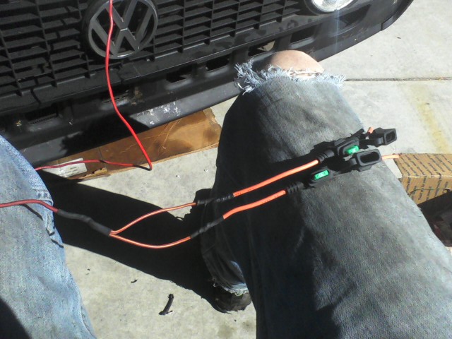

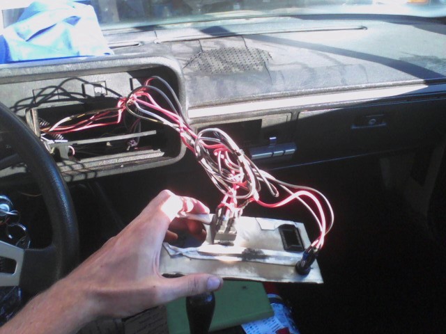

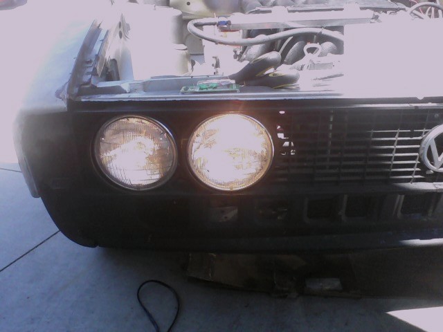

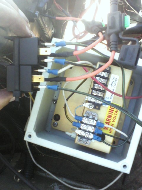

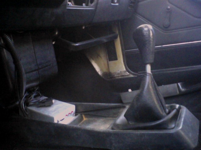

    This afternoon I cleaned up the rats nest of wires under the dash into something a little more manageable. I also put my headlights to a switch on the dash, and I am trying to get a switch that controls all power to headlights and ECU. This is not working as I planned when the car is running and the headlights are turned on the ECU does not get enough power so the car dies, so I need to think more about that.
    anyway! Right now the motor runs and the headlights are bright and now the tail lights work so that is good.
    until the Auto-x Sat night!

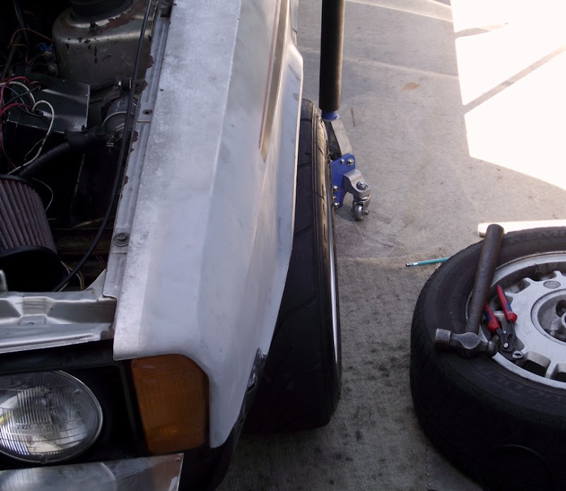

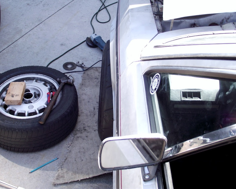

    Well last night was the Autox, and it was very eventful.
    Did one run had a shudder in the motor on the track. After that run it would not start, so I pulled it aside. after a few min I thought I must be out of gas (embarrassing as hell, I over filled it last event so I was being safe)
    ran got gas got back in time to finish my first set of runs. I get on the line with a co-worker and go to start and nothing, revs go up but car does not move. I figure clutch or tranny but there was no noise. I push it aside, then get a push back to the pits.
    during the wait for a tow from a friend me and several fellow racers think it could be many things but after watching it with the hood open we decide on blown CV, because just one flange was turning, and nothing else.
    Get a tow home from a co-worker push it into the garage, tossed a used CV I had laying around at it and fired it up. drove it back to the event and got there just as the last run group of the night was starting. I joined them and got 5 more runs. So out of the 10 runs for the night I got 6, but I still feel glad it was not something more severe.
    The CV that I threw in is an old used one and clunks and rattles so I will be getting a new one before the Hill climb.
    one hell of a night I got home around 12:30 and crashed(fell asleep ). Today is clean garage/unload car day. I'll post photos as they come it.

    Well today I got a new CV so I tossed it in and moved on to trying to get it to start from cold. I got it so it would idle right after a cold start and a few little throttle blips.
    After I wait till the coolant is sitting at about 170deg and slowly push the accelerator to 6500rpm to watch the fuel map and feel for any weirdness. As soon as I hit 6500 rpm I lift off and the car dies.
    When I try to start it a few seconds afterward the starter sound really weak, and it will not fire. after about ten seconds of cranking...nothing the car dies. There is no switched power anywhere. I have tested all the constant power from the batt past the fuse box and it all has 12v but as soon as I turn the key to activate the switched powers there is still nothing at the switched points and most of the constant powers drop to nothing.
    Things I have replaced so far: three fuses blew. two 8amp in the fuse panel and one 5 amp to the rear lights. I moved the batt ground to a better location put a better bolt in it and ground down to the metal( because it was getting really hot at autoX). I have not seen any scoring or arc marks, did not smell anything, and did not hear anything.
    I am at a loss for now I will sleep on it and see if tomorrow brings any new ideas.
    I am so close to the hill climb I need to be working on Megasquirt not a wiring phantom.
    anyone ever have this happen to them

    Any current draw on the battery when it is all shut off? What were the two 8amp fuses for?

    Pete suggested that I take out all my fuses and put back only what I need, because most of the wiring goes around the fuse box. I took all of them out except the fuel pump relay and everything worked again.
    The scirocco fires up way better now and there is less load on the electronics, so something must be grounding out hardcore.
    Played with the MS a little and it came out sweet it is running great, fuel pump is making a little more noise than normal I think so maybe crap is getting to it. why is there no filter before the pump? I might have to put one in there :/

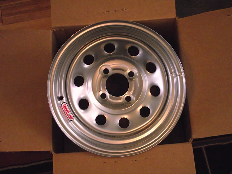

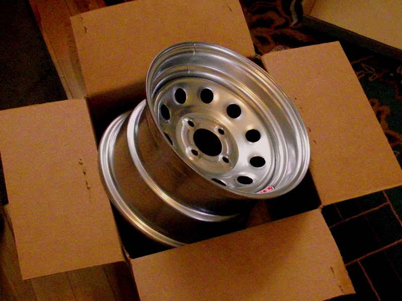

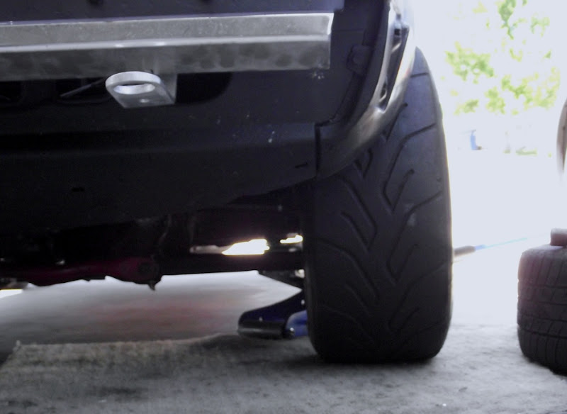

    two days before the race and I got some stuff done. I have decided to go for both days, I think the scirocco will hold up fine. I weighed it today and I sit at 1840lb, just a hair above the minimum for SMF. This is without me in the car.
    I will let the pictures talk:
    Day they came. 13inx8in, 4x100mm, 5in backspacing, spun aluminum weighing 11lb each.

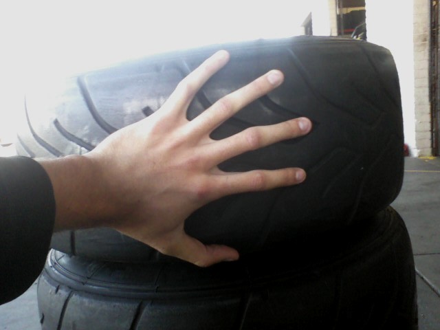

    Mounted: sorry forgot my camera when I went to Big-O. I also got a Race alignment while I was there. Left Front -1.4° camber, .-5° Toe: Right Front -1.9° camber, -.4° toe.
    Normal tire:
    Not so normal:
    Stuff pre-staged for the weekend. My roommate left for Cali and left her car right in the way into the garage, she did not leave her keys. So the Scirocco gets to shiver outside tonight.

    I am wading through the footage I took as well as the photos right now. So far my fastest was a 2:18 on my 2nd to last run, I only did two clean runs out of six the others had something happen or I almost span.
    Today was really cold and I could not get heat in my rear tires no matter what I did so the back end kept wanting to come around on the hairpins, a new feeling for me :/
    I feel like I could of been way better, but I could not get grip.
