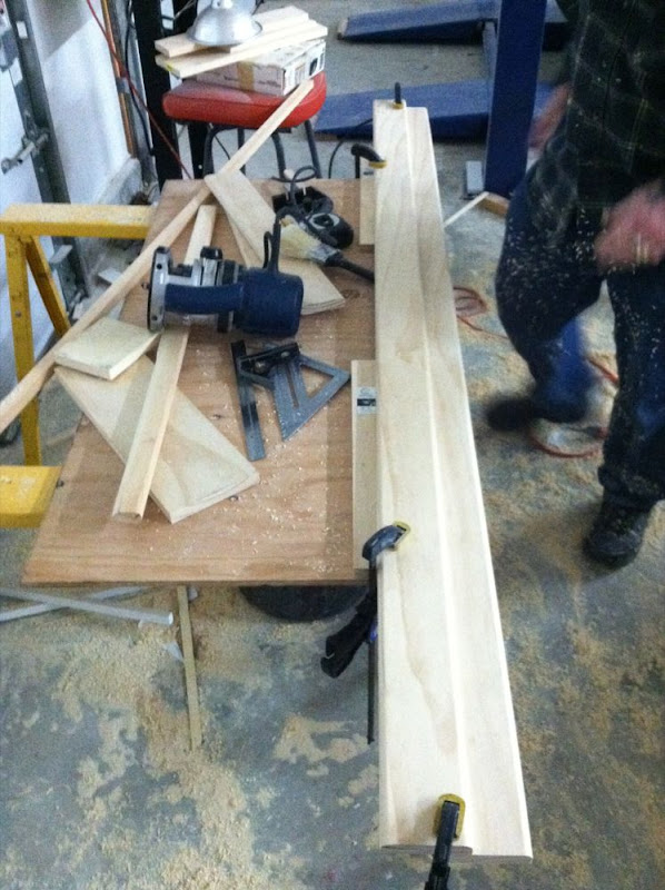

    Got some trim up and the door primed.. Darkk got in there with the air grinder and made some slots in the metal ends of the pocket door frame so we could nail through into the wood:
    We're definately not carpenters, but it'll look ok once it's done lol
    These two are worth their weight in gold for doing trim.. maybe cheap HF stuff, but they work great:
    We bought a cheapo router table to mount the router in, and it wouldn't cut a straight line, so it went back, and we made a ghetto router table:
    Here it is hung up:
    Some light green paint on the trim- this went on the shelf in the bathroom too.
    and the door primed up with Kilz.. **** goes on so blotchy. Probably end up doing this the same color as the walls so its not a sea of green when it's closed

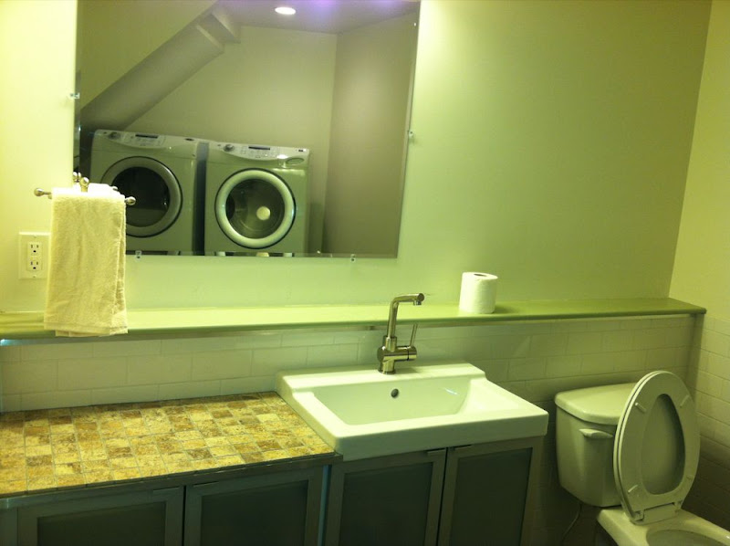

    The sink cabinets downstairs are mounted to the walls, sink is glued down, and we made a quick tile counter on the other side
    had to jerry rig the plumbing through the cabinet since we planned on using a 48" cabinet, but instead got two 24".. the sides were right between the hot and cold lines. It's all blocked up and clipped down now though
    And here it is with the mirror up. Still have to install the ****ter, and hook the lines up in the basement, but it's pretty much done

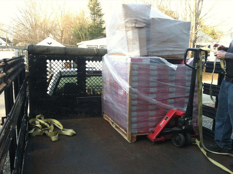

    And my laminate flooring showed up.. all 2240lbs of it
    That probably won't be going in for a few weeks or so.. got some painting to do upstairs (to fix ceiling, etc), and doing some transmission work next weekend

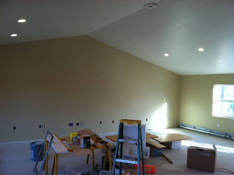

    Ok, been a while since I've updated this. Since the last update, a few things have gotten done
    The walls upstairs are no longer white..It needed some color. 3 walls are beige / tan-ish colored, and the bathroom side is mother****in orange:

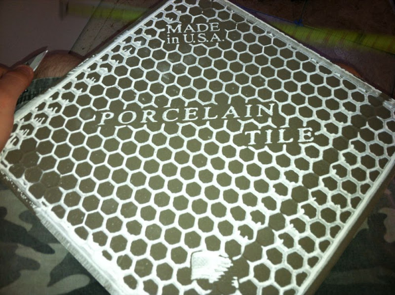

    don't see this too often- From Home Depot no less
    First we put down this styrofoam uncoupler matting
    seems I forgot to get a pic of it grouted, but here's the tile down:

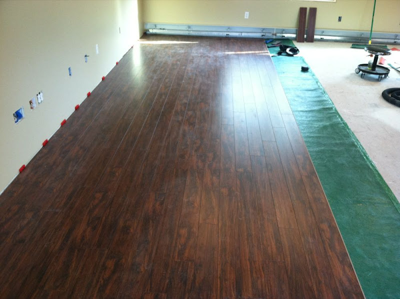

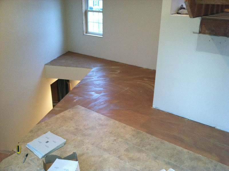

    The floor upstairs is started, looking pretty good so far. It's "Rosewood" style laminate, 1/2" thick, AC4 rated and the joints are all waxed to limit moisture absorbtion

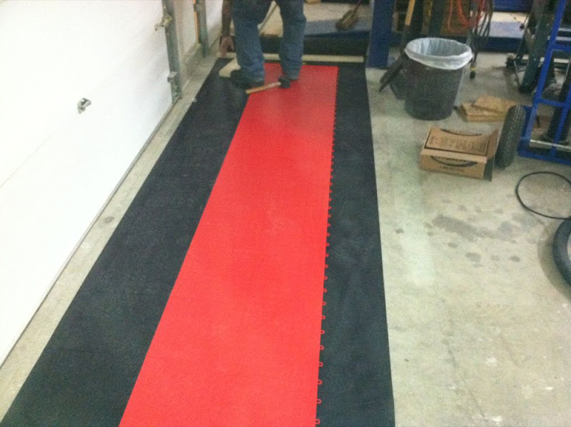

    We started our Racedeck install today.. If the garage was clean and empty, it would have taken a couple hours, but it was dusty, full of sawdust, and we had to move a whole bunch of crap, so we only got half of it done today
    We put down landscape fabric to try and take some of the clackety clack noise.
    section in front of one door started.. sorry for the quality, iphone sucks for pics if the light isnt just right
    Now we're gettin somewhere

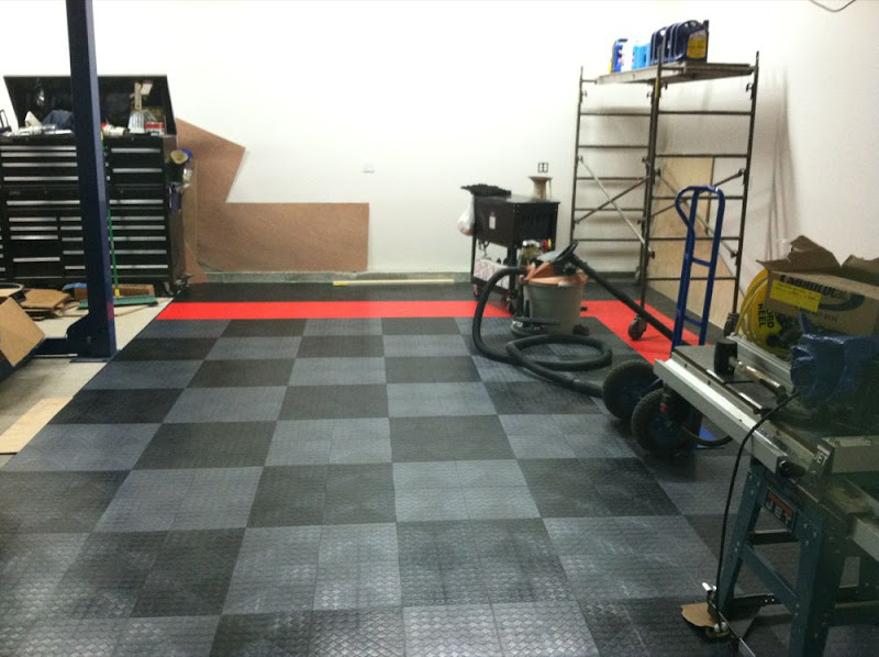

    Here's where we ended it.. just over half done. Gotta move all the heavy stuff to do the rest

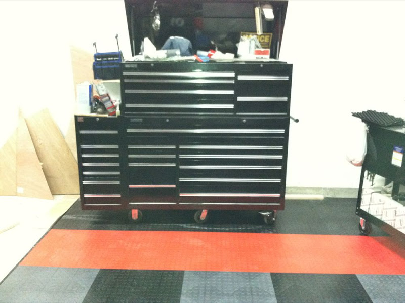

    We moved the toolbox over onto the new tiles so we can start in its spot tomorrow. Ended up using a piece of 1/4" plywood to make a ramp.. it went easier than I expected, considering the weight
    I left the back 3 feet of the garage all black, as it's going to have 3ft wide pallet rack all the way across once we get everything finished up
    It looks even better with a car on it!

    The Racedeck is finally all done. Had to move a bunch of stuff today to do the other side, as well as do under the lift.

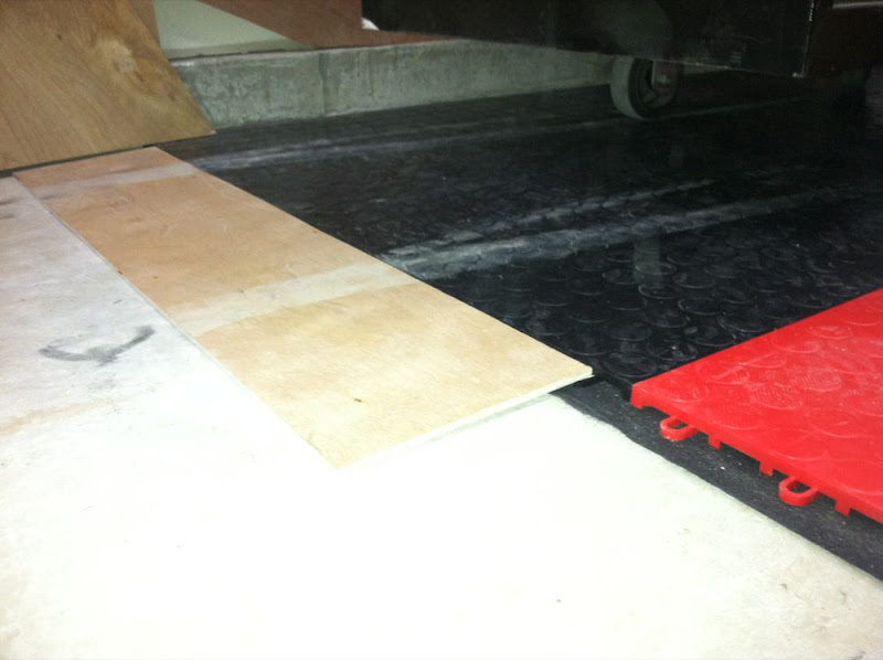

    We ended up getting some 3/4" pieces of plywood, and putting it under the casters on the lift to get a bit more height so I could place tiles under the posts without actually moving the lift
    Sliced the landscape fabric to go around the wheel so I could get it flat, then put the tiles down
    The edge tiles were all cut on the delta bandsaw, and it made an incredible mess! LOL.. I had jiblets of plastic everywhere, but it cut nice
    All done.. everything is just stuffed out of the way at the moment until we get the pallet racking in there, then it'll all be moved
    It looks awesome, just glad the install is done.. Actually, the install of the tiles themselves isn't bad at all, and goes fairly quickly, its just the shuffling around of all the **** in the garage that makes alot of work. I gotta get my buddy to take some pics of it with a wide angle lens so you can see it all in one shot

    There is a full second floor living space above the garage with 11 ft vaulted ceiling,a 900 sq.ft. loft, The connector between the garage/loft/house is the new entry way and has a downstairs bathroom/laundry with a stairway to the second floor and entry into the existing house. And the second floor part has the stairway to the loft because of the floor height difference between the old and new. It also will house our new server closet.

    We got a few things done over the long weekend..
    Hung the medicine cabinet upstairs. I only got one pic, was in a hurry to get out of there, it was hot since it was 90deg outside
    We shuffled a bunch of stuff around in the old garage so that we could start dragging out the cabinets to put in the new garage. The blue 2 door cabinet came over, and we banged out the bottom a bit since it was all tweaked from people dragging it all over before we got it. Had an idea to make a frame with some 2x4's to stiffen it up
    Then we sanded it down, and threw a coat of rustoleum safety red enamel on it with a roller. It came out fairly lumpy, but it's flattening as it dries. I have a feeling it's still going to be fairly lumpy when it's done though, but it'll do fine
    It still needs a 2nd coat, and the areas around the hinges and inside the openings need to be painted
