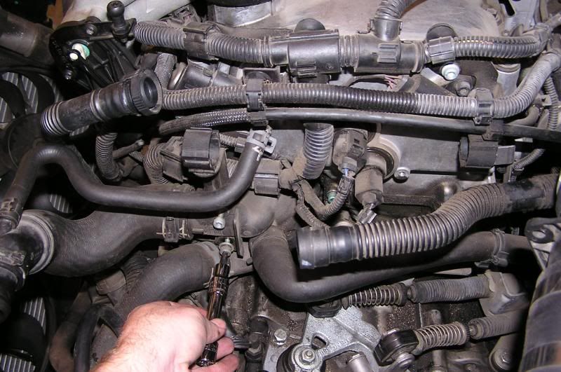

      Yup - doable, but difficult if you aren't familiar with where things are in there. Getting the rear bolt is the hardest to find if you don't already know where it is. Here are a pic from when I did mine that may be helpful:
      Front 2 bolts:
      This pic from darisd's (awesome) DIY show's the rear - just be careful which you get - the one you want is kind of deep down there.
      Be sure to replace the seal between the coolant flange and block (odd shaped seal) and the o-ring for the crack pipe when you put it back together.
