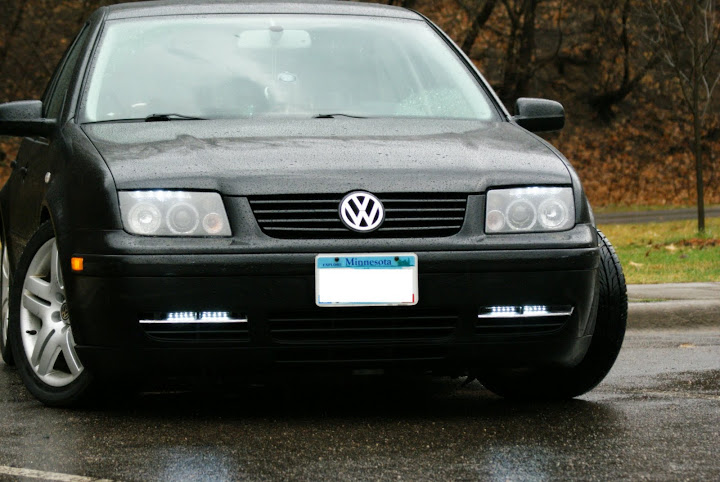

    LED Bumper Daytime running lights
    ::::::: Mod Name: LED Bumper Daytime Running Lights
    ::::::: Why Worth It: Looks cool
    ::::::: Cost: under $5.00 (hoping you have basic tools including a Drill)
    ::::::: Where to buy: e-bay or local Radioshack
    ::::::: Time required: 1 hr.
    ::::::: Difficulty: 1 on a scale of 5. (this was my first time soldering)
    ::::::: DIY:
    1. Order 5mm or bigger white LEDs with resistors for 12v applications from e-bay for under $5.00 or get pre-wired ones at-least 25.
    2. Using a 22AWG wire connect the LED to the resistors, if you would like to know more how to look at the above DIY for trunk emblem.
    3. Take out the lower bumper covers, on MK4s they just pull out. Using a drill bit matching the size of the LEDs, drill 10 holes.
    Note: Passenger side bumper insert is open, cut a measured piece of plastic sheet or polycarbonate sheet to use as a plate to drill holes in.
    4. To make the lights really bright and visible, use Aluminum tape and paste it around the LEDs in the bumper insert. (See pic)
    5. Using some glue to glue the LEDs in the holes and use Liquid tape or silicone to weather proof them from the rear.
    6. Route wires up to the headlights and tap power from the Parking lights to power the LEDs.
    7. Enjoy your work.

    Did this like 4 months ago...
