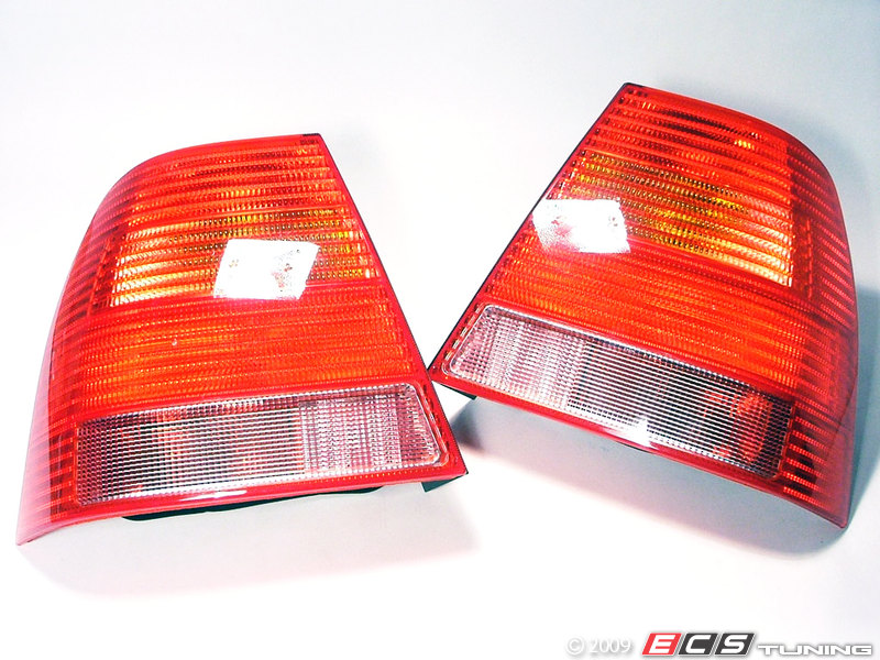

    In reference to the breaking the amber out of the tail lights, I've done it on my Jetta tails and it really cleans up the look. There is zero amber reflection behind the red lens. No, I didn't break anything. It took a lot of time using a Dremel and needle nose pliers.

    Quote Originally Posted by JettaGetUpandGo View Post
    The DIY for the red stitching is genius. I was mad that when I put my Euro Recaros in that I lost my gray stitching. To make it look even better the seat cover can be removed, then the stitching can actually be fed through the holes.
    What about the amber lights? You're saying you can actually break the amber pieces off?

    Yup! If it's the Golf taillights with the Amber outer lens you obviously can't, but in the Golf R/S/S/R, R/S/R/R and almost all of the Jetta lights there is an amber reflector inside the housing (it's actually more of a fluorescent yellow). Take the lights off the car and then VERY carefully use a drill or Dremel or a combination of both to cut as much out as you can, then grab pieces of it with needle nosed pliers, twist, and break it out in pieces small enough to fit through the bulb hole. You will need an air hose or really good vacuum to get the little bits out. I've done this to my Euro R/R/R/C Jetta tails, a 95 Accord coupe, and a 96 Accord sedan.
    Cutting the entire outer lens off and then pulling the reflector out and resealing the lights is another option too, but I prefer my method.
    I never took pictures before since they were cut out before the lights ever went on the car, but this should show you what changed. It's subtle:
