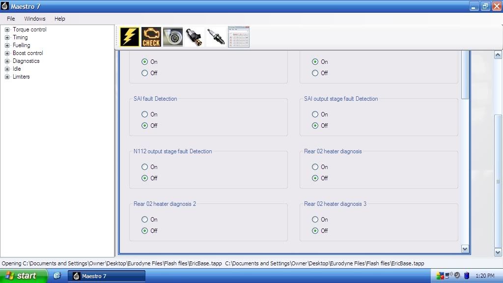

    1. Maestro 7 – tuning suite, allows adjustment of all tune settings with 3D maps (adjustment through numerical settings, maps non-adjustable as of 10.19.2009)
    --- Diagnostics (readiness)
    --- Boost
    --- Fuel
    --- Spark
    --- calculator

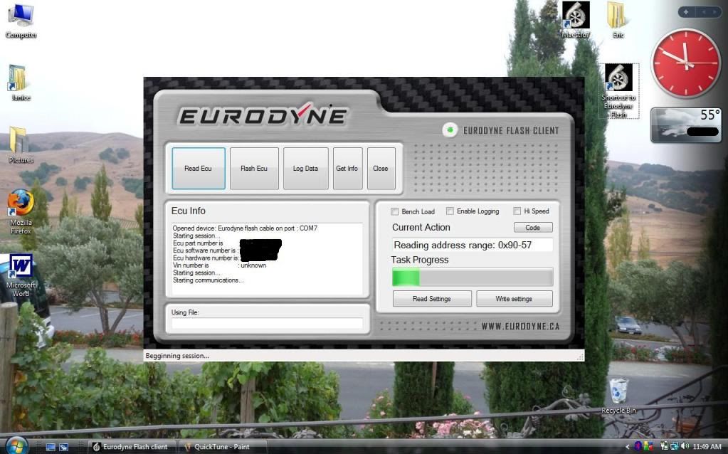

    2. Eurodyne Flash – actual flashing program (first picture below)
    --- Read + Write the ECU, get ECU info

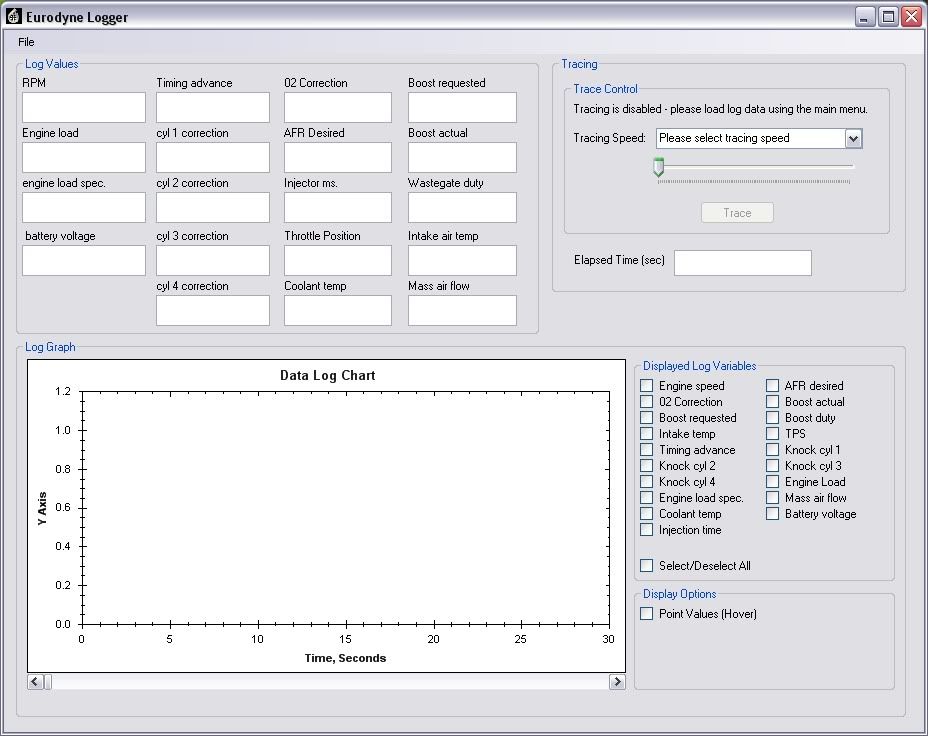

    --- “Log Data” takes you to a separate data logging screen, displays real-time data on many parameters (second picture below)

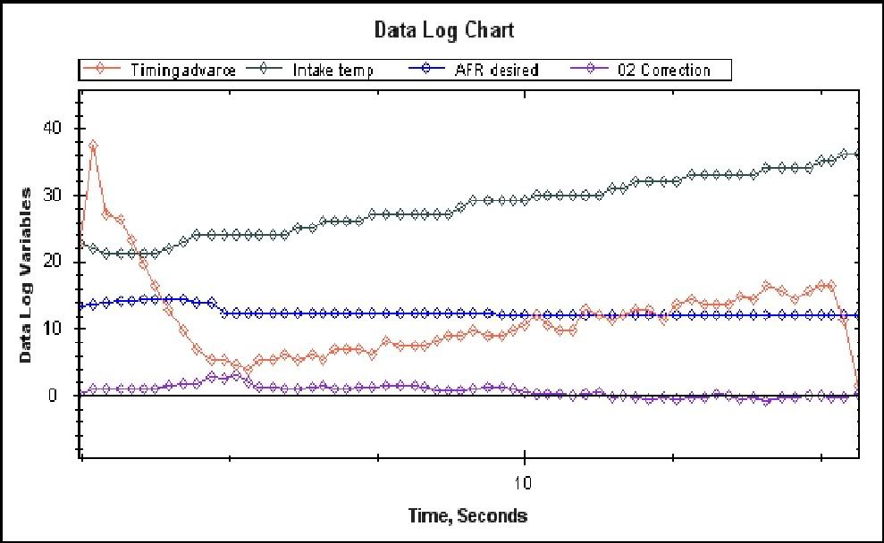

    3. Log Viewer - allows you to analyze the entire log file; you can zoom to a specific section, print the graph, or save it as an image.
    - Once you get the software installed and working, you have to Read ECU with the flash program; I would enable hi-speed since my connection crapped out with it unchecked (probably car dependant). Once you read/save the file, you’ll e-mail this to Chris, and he will send you a tuned file. Barring any problems, you will be able to simply download the file, hook up your computer and flash your ECU. Here is a visual sequence:
    Action pic:
    Reading the ECU:

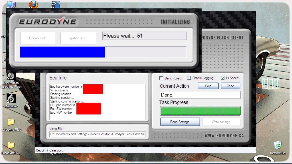

    (…a few days/emails pass…)

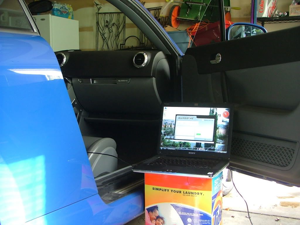

    Flashing the ECU:
    Time to play!!

    the icons on the maestro screen will open all related windows to make the appropriate changes

    I found the info on this screen to be interpret differently.
    I believe that KEY OFF ENGINE OFF and KEY ON ENGINE OFF would be a better description
    I know it caught me a few times when trying to load files

    I have the program that is not the case
    you missunderstand the graph map is not adjustable but the Number map makes all the changes to the graph map

    I believe you can change the maps, from this picture it appears he his altering the boost duty map, he changes the numerical value which then translates to the visual 3D map. I believe he says the 3D maps are adjustable through changing the numerical data in the table and not through actually grabbing points on the graph and moving them around(I could be wrong thought).
    Quote, originally posted by l88m22vette »
    There is basic adjustment through "Read Settings" in Flash or with a lot of detail in Maestro
