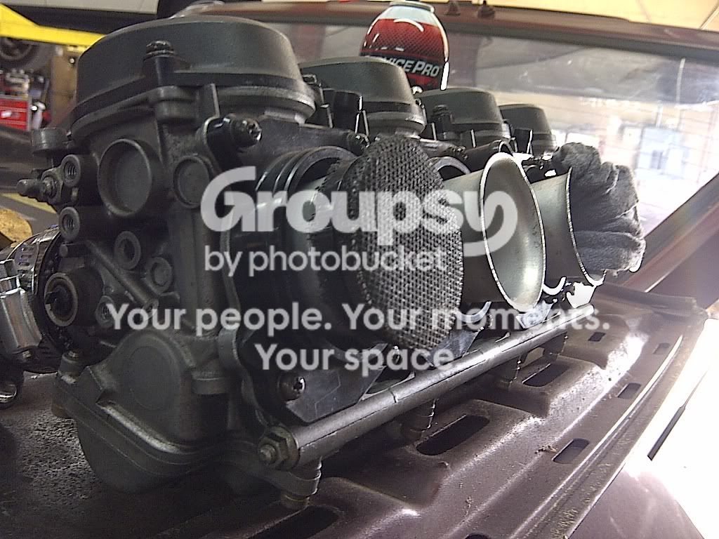

    attention to funpig's post....i see this setup run everyday with no issues. here's what i plan on doing...window screen secured with a ziptie. this is nylon screen but i have some metal screen im going to use instead for the sake of backfiring...

    Quote Originally Posted by yorgerg View Post
    Are those cbr carbs?
    Also nylon will not last. I burnt up aluminum screen. go stainless.
