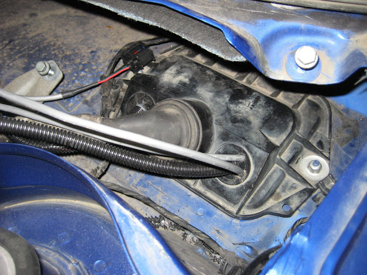

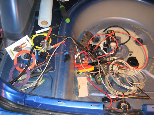

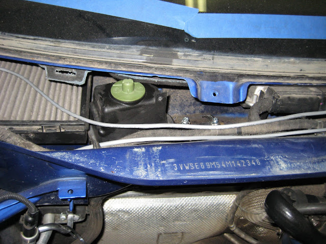

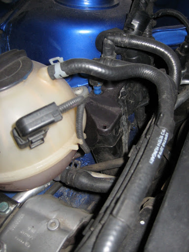

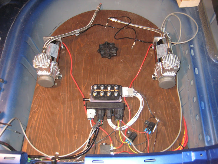

    Went crazy this week!
    Power Steering Relocation
    Shaved the Holes for the Evap System
    General Cleanup and wire tuck
    Sensor Lines Ran
    Base
    Wiring Mess
    Done for the Night.
    OMG IT LIGHTS UP!@
    Well, i hope you no one who waited had 56k.
    Just waiting on the bags to get here and in the mean time I will be building a false floor for in the trunk to hold the tank and hide the rest of the stuff.
    Any other ideas/comments?

    False floor is almost built. just need to pick up some felt so it doesnt rattle.
    Left to do:
    Run air lines
    Finish setting up the lines in the trunk
    Run an air line from the tank to valve block
    Drill holes to run air lines from trunk
    Set up the leveling sensors
    Install bags
    Run wires for the rear sensors
    Notch Frame
    Re-assemble interior
    Build cover for false floor
    ALSO
    What should I do with my tank? I was going to make it a disco ball, but that would look tacky.
    IDEA ME!
    Modified by SoldierSide16 at 11:41 PM 1-26-2010

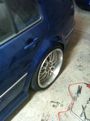

    Rolled fenders, rear tires don't rub whatsoever, just a mock up. I just popped the spring out.
    Thinking i might have to step it up to a 20 mm rear spacer.

    Anybody have more tips on getting the rear lower?? Im not held up on tires or anything is there something that i can trim that someone knows off the top of their heads? Or are you guys gunna make me get back under my car?
  12. 02-25-2010 09:48 AM #47
    is that pic just sitting on the rear shocks with no spring? have you cut the bump stops?

    02-25-2010 10:22 AM #48
    remove bump stops, and get shorter rear shocks.

    I have shorter struts, KYB AGX. But i will be changing them soonish.... What should i go with, H&R? any other companines that will just outright sell just the rear struts?
    I chopped the rear bumpstops down, i can now stick a business card in there and it will stay.
    I found out, i cannot go any lower. I am hung up on my exhaust.......
    Has anybody notched their rear subframe deal there?

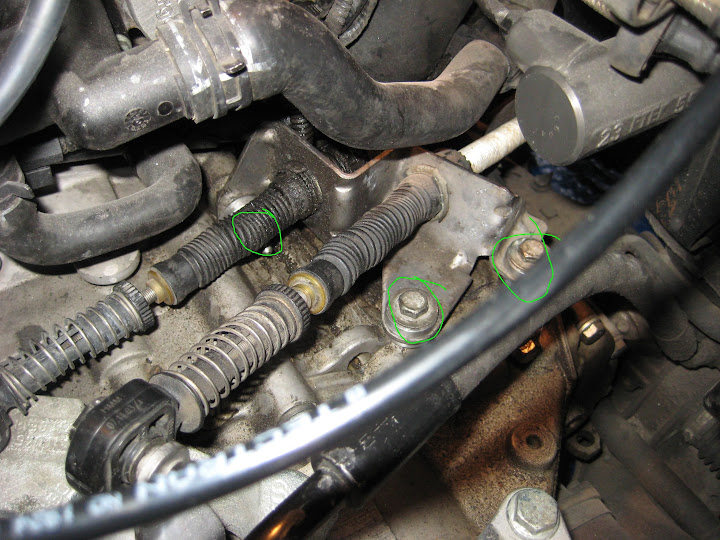

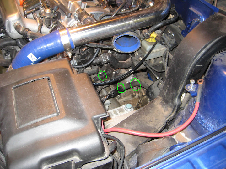

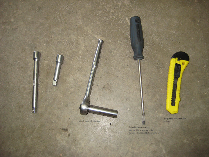

    Verdict Motorsport Shifter Bushing Install.
    Easy.
    Tools: Extensions, socket with 1/2 inch bit, Tools to remove your airbox, and a knife to cut out the old rubber bushings.
    Remove air box then Remove these 3 - 1/2 inch bolts
    Different Picture of bolts, also a finished picture.
    My blocks

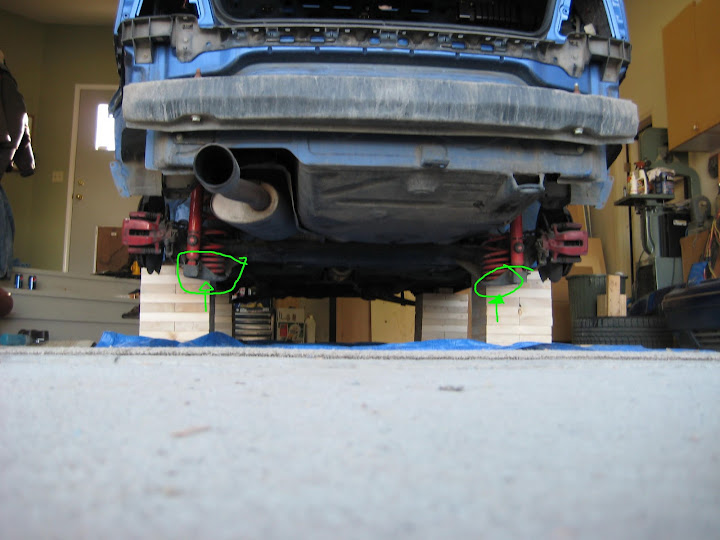

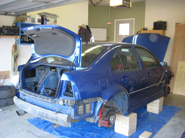

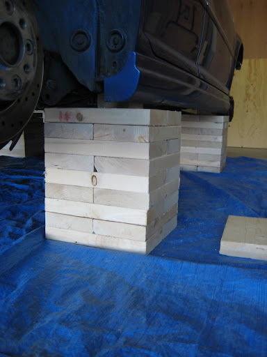

    13.5' high approximately made by me from about 18 foot lengths of 2x6 for EACH one. I put a small piece of 2x4 on the lifting points so that it didn't rest on my side skirts.
    How i got it up onto the Blocks.

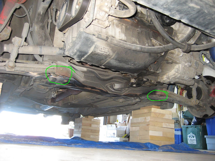

    I started by driving the front wheels up on my homemade ramps, that are a gradual step up of 2x6, to a height of 4 - 2x6's stacked, no pictures of this.
    Leave the car in gear with the e-brake set to stop any rolling.
    I started by finding two OEM Widow Makers and putting them at the lifting points in front of the rear wheels, I lifted the rear evenly using the OEM jacks with some help from my friend (DONT DO THIS WITHOUT SOMEONE ELSE, 3 PEOPLE MAKE IT THE EASIEST). I lifted it just enough to get the rear high enough to get a big trust-worthy jack under each of the springs.
    I started lifting the rear with the jacks under the springs, if you don't do this and just use the OEM jacks it will fall to the side and mess up your paint and or you. Have two people pumping the jacks evenly and one person watch from behind to make sure that the car stays even while lifting.
    Once it is high enough slip the blocks in under the lifting points for the rear and the 2x4 on top, make sure the weight is centered on the blocks. Lower the rears and make sure its all sturdy and stuff.
    For the front
    Being that it was already on ramps i had no problems getting the big jacks under it, i took off my front valence to give more space to pump the jack handle though. I put a jack in each of the spots circled.
    Lift the front up evenly like the rear, two people jacking, one person to make sure its even.
    Slip the blocks in and center them and all that.
    The way i built my ramps was the stack of 4 2x6's were screwed to but could be separated from the rest of the ramp.
    Finished product:

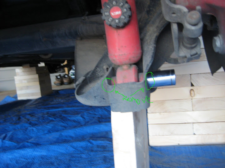

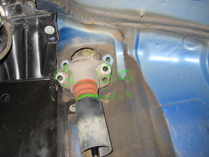

    Removing Rear Struts / Springs
    Start by pulling your fender liners, pretty basic, t25 torx (can someone verify this for me?)
    (no pictures)
    At the top where your strut meets the body, there is a bracket with 2 - 16mm bolts holding it in, undo these, do the same on the other side. You can also cut your bump stops too, if you plan on going that low.
    Once the struts are loose, the rear beam will drop down, and the spring should pull out.
    Undo the bottom bolt if you are replacing the strut.
    More to come as i work on the car.
    If anyone has anything to add or for me to change send me a pm and i can update it.

    My dad was a firefighter for 35 years, he has been to a lot of calls of fallen cars, he refuses to let me get under a car that is just on jack stands cause it is not very sturdy, if you have seen the pictures I have seen, you wouldn't put your car up on 4 jack stands and get under it again.
    Don't get me wrong, 2 jack stands is fine if your doing just front or rear, but for all 4 wheels off the ground better safe than dead.
