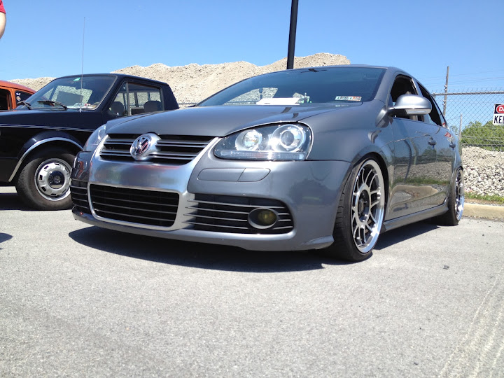

    Now you can't say people miss your car at shows!
    https://picasaweb.google.com/lvdutch...91196972981138
    Thanks man! Haha.
