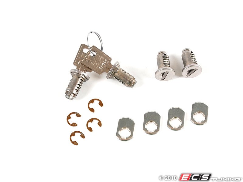

    The last part on my ECS order (lock cylinders for the roof rack) still haven't come in to ECS yet (16 days with no ETA). I canceled them from the order because I need the rest of it in order to make the car drivable. The OEM rack is a Thule rack and I can get the lock cores on eBay for a reasonable price, but there's a small piece that attaches to the lock cylinder that acts as a swinging arm to latch that I need as well. That's not included with the lock cores. Maybe I can use a friend's for reference and fabricate something.

    In other news, I have in my had a set of locks for the Votex rack, finally! A week and a half ago I stopped in at the dealer and the parts guy said he would call VW on the following Monday since the part number I gave him showed NLA. I didn't have a chance to get back there until today, but he found them and expected me to come back, so he ordered a set and they were ready for me to pick up!
    The part number that I had for the locks was 7M0 071 134. There are circlips and small mounting tabs that come with this lock set as shown on ECS (which now shows in stock. **** you ECS.)
    I believe Thule redesigned their locks within the last few years because when I searched online for replacement lock sets for Thule products, the locks looked different and didn't include the circlips or tabs. It turns out the new locks are direct replacements and eliminate the extra pieces! You should be able to get them from anywhere Thule products are sold, although, brace your self, they were $12 cheaper at the dealership.

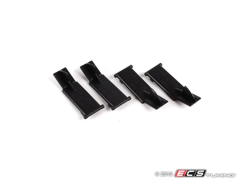

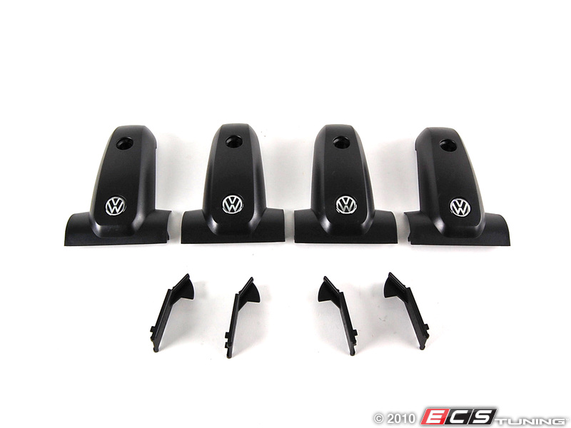

    For anyone needing end caps for the Votex rack, here is what you need:
    Caps: 3B0 071 738 $29.87 (4 caps and 4 retaining clips)
    Retaining clips: 3B0 071 701 $6.74 (4 retaining clips only. these are the same as what come with the caps, but can be ordered on their own as well)
    Locks: 3B0 071 734 $35.65 (4 lock cylinders and 4 keys)
