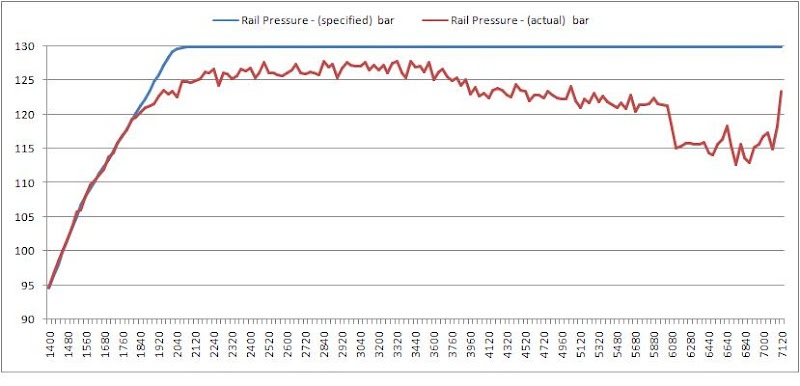

    according to your graphs you only reach ~134 bar of rail pressure for like a MILLISECOND and then pressure drops right off, RIGHT WHEN RAIL PRESSURE SHOULD BE AT ITS HIGHEST, and that is the rev limit...How amazing...
    Learn to read.
    Quote, originally posted by Uber-A3 »
    why the big drop off in rail pressure after the rs4, the one where is is way above requested and them just drops?
    Quote, originally posted by ndifadvokit »
    I let off the throttle. Keep in mind the sample rate is pretty bad and the graph is merely connecting one dot to another with a line. So it looks like it's dipping down however, there're only two data points recorded which are 134 bar and then straight to 124 bar. I probably could've cut that last point out but i used it in the other graphs so i left it in there. My other two runs from the same session stay at 129 & 130 bar

  4. 04-13-2010 07:07 PM #144
    You should first be asking WHY i wasn't meeting the 129.9bar request. My stock fuel regulator valve was dumping the pressure before it ever reached what it was supposed to. Just because the valve is rated to 130bar doesn't mean it actually is working at 130bar. Parts are not always perfect.
    With nothing else changed other than installing the RS4 valve i am now able to easily meet and exceed 130bar. Not every once in a while, but 100% of the time. If you put two and two together it makes perfect sense.
    then your stock valve was bad and replacing with the gti valve would have netted the same results. Not by going over 129.9 but up to it at least. Unless the stock valve really isn't rated at the claimed 130 bar.
    Maybe a different question but same answer.
    Quote »
    only if you let off the throttle completely. Accelerator pedal position goes from 99.6% to 73.3%.

  7. 04-13-2010 07:13 PM #147
    right. but i had the choice of replacing my stock valve with another stock one that might or might not have the same problem as my first one or go with the RS4 valve which probably costs the same and is rated higher. What would you choose?

    Honestly, after reading all of this...I'm not convinced with the data provided...the sampling rate is too low to really determine how the rail pressure is really fluctuating (or sustaining) due to the new valve.

    guys, i respect everyone's opinion here. Yes, even yours GolfRS. I've gone out of my way to take the time to post actual data free of charge. Inevitably some people will disagree. To you i say... prove me wrong with cold hard data. I welcome it. If i'm wrong prove it and i'll accept it. But so far my data and first hand experience say otherwise. Eventually someone else will install this valve and we'll see how that plays out. Till then, i wish everyone well.

    What i have gatherd from all of this is that ndifadvokit was not reaching requested before installing RS4 valve but now is, i was also not reaching requested, but now meet it better than i ever have and guess what yeah my car does feel smoother, much smoother. Could i be masking a potential problem, maybe, but i guess that problem would have to show its face again and when it does i will deal with it. My rail pressure logs have never looked better. It is as simple as that.
    Everything else thats being discussed, has nothing to do with why the uprated valve was installed. This is not as complicated as its being made out to be.
    Like what was said earlier the stock valve could have been playing up, i chose to stick the uprated valve on and have only seen good things.

    Update. So I ran some logs last night. Prior to installing this valve I was running 949 on my Revo software. With the new valve I'm able to bump the numbers to 969 and not have any retardation.
