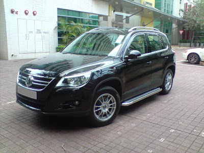

    aftermarket shocks/coilovers are usually stiffer than stock ones....so it will only makes thing worse...if u are looking for comfort
    the safest play is, smaller rims with thicker tyres.....like what I have done to my tig
    go for stock 16" if u are on budget.
    if u got $$ in pocket, OZ Ultraleggera 16" on 215/65 Michelin Latitude Tour Hp like mine are decent choices.
