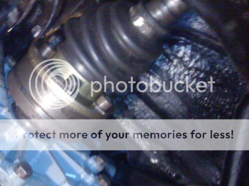

      Remove each half-axle from the car. The downpipe will have to come off at some point so you might as well do it before removing the passenger-side half axle. This is what I did on mine but my downpipe is very different from the stock one.
      If you have difficulties removing the half-axles, try prying the transmission to the side using a crowbar or large wrench.

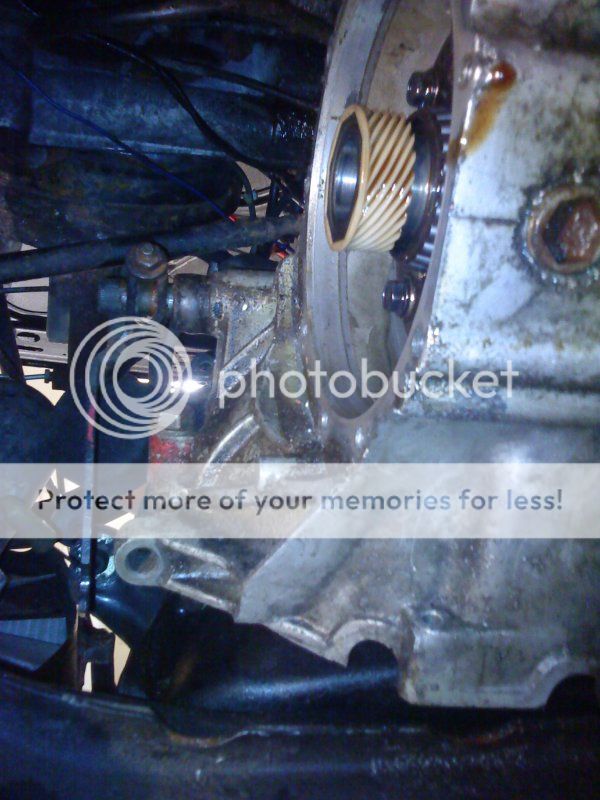

      Now pull the reverse sensor wires off. They are shown in the pic above. On 5 spds they are on the passenger side of the tranny, and on 4-speeds they are at the rear of it.

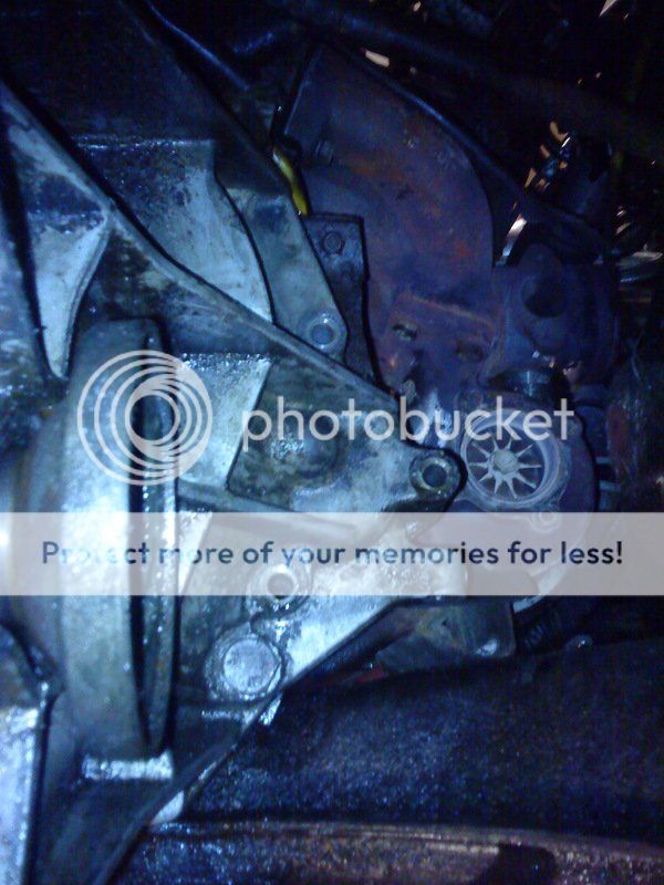

      Start taking off the 19mm bolts that attach the transmission to the engine. They are 5 in total, all 19mm. Going clockwise, starting from the bolt you see immediately below the clutch release arm in the pic above (say that's bolt number 1) that one is there by itself, bolts number 2 and 3 hold the coolant heater bypass structure between the tranny and the engine block, number 4 holds the end of the ground strap, and number 5 is a long one with a 19mm nut on the other end.

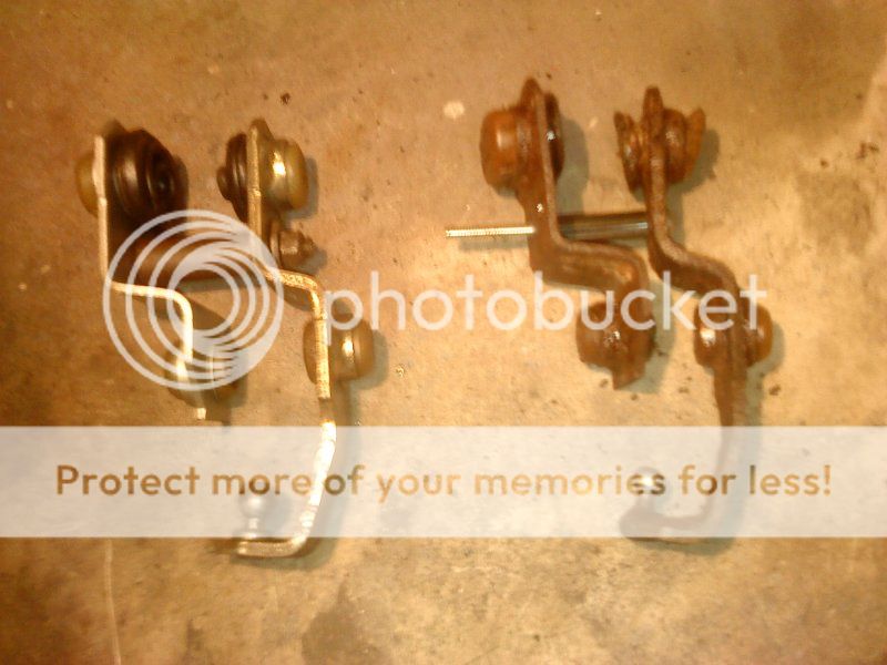

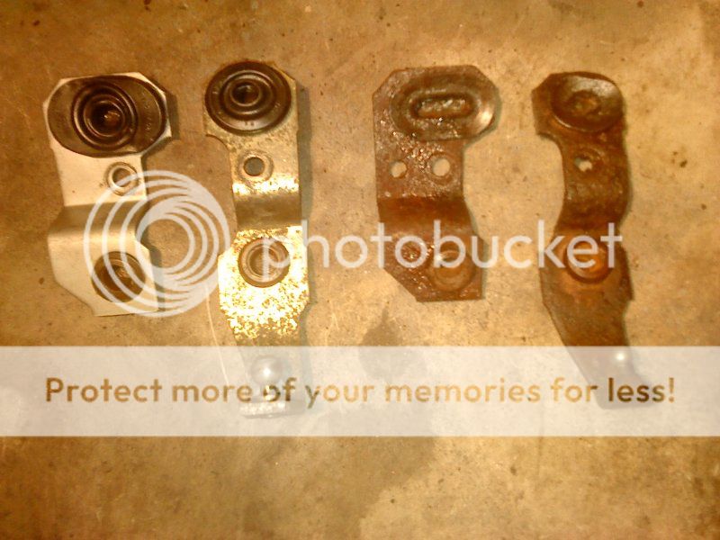

      As you can see, they are the exact same metal structures. Top bushings are the same (the 4-speed ones shown are missing the dust caps), middle bushings are different, and the ball on the bottom is a different size as well.

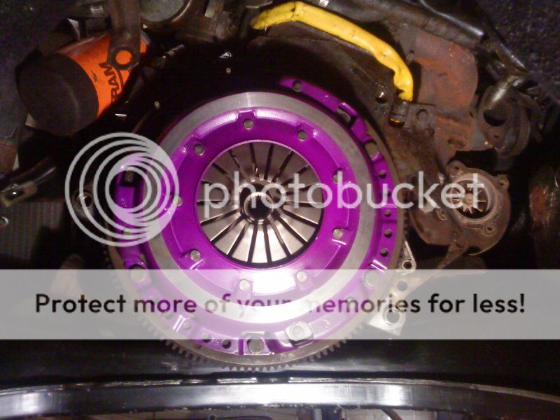

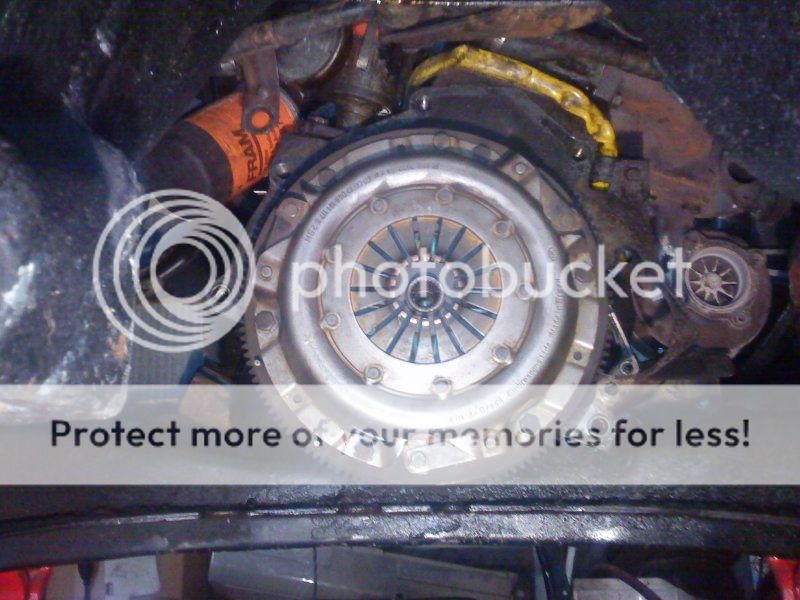

      If replacing the clutch, remove the six 13mm bolts holding the pressure plate on. Out it comes and exposes the flywheel:

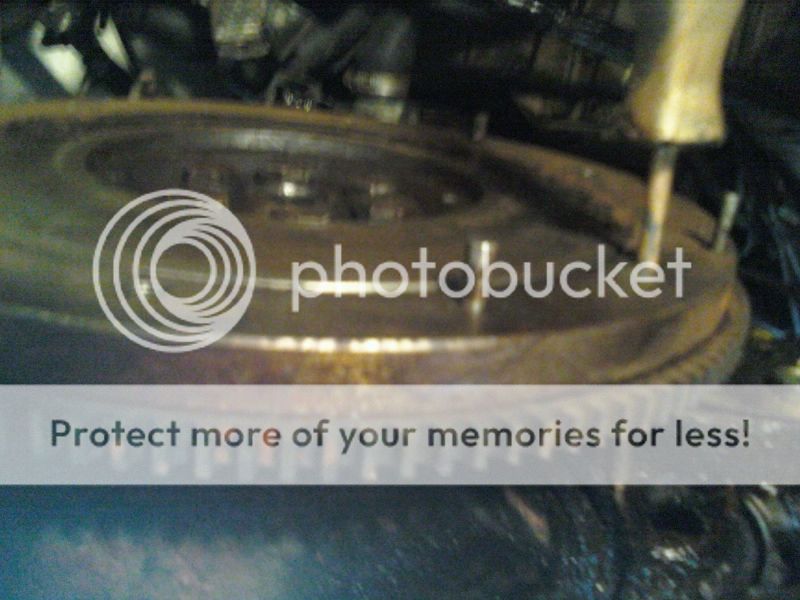

      Now, you are supposed to remove the flywheel and get it resurfaced before installing a new clutch. In order to keep it from turning, you could stick a screwdriver through one of the holes so the engine block stops it from turning (thanks j-boogie and themagellan for the tip and picture)
      I chose to keep mine in place as the ceramic clutch I installed wouldn't have a problem grabbing onto the flywheel, but to be on the safe side you should remove the flywheel and get it resurfaced if you want to do things properly, especially with if using a stock clutch. The flywheel is held on by 6 15mm bolts. These bolts are one-time use only and must be torqued to 30 Nm following a star pattern, plus 1/4 turn again following the same star pattern. Removing the flywheel will also give you access to replacing the rear main oil seal.
      Now onto installing the new clutch. It is not absolutely necessary, but it is highly recommended to use a clutch alignment tool as shown - you can loan one from your local parts store for free just putting down a deposit. It will allow you to perfectly align the clutch disc in no time. A misalignment of even a milimeter will make it impossible or very hard for the transmission to go in. It is hard enough to get it in even with a perfect clutch alignment, you don't wanna make it any harder than that.
      Make sure it sort of looks like this up close:

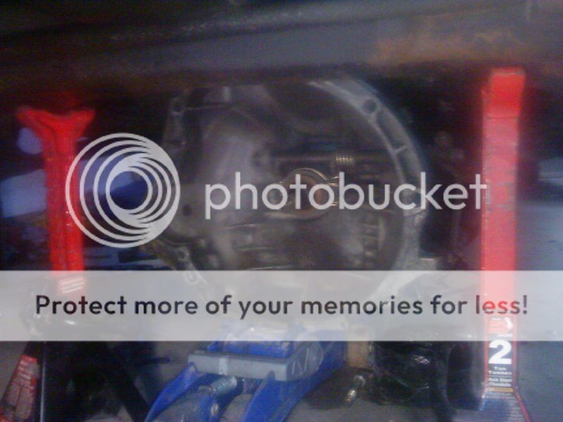

      Now jack the front:
      If you haven't yet, jack up the front engine mount to tilt the back of it down. This is necessary for the transmission to clear the steering arms going in.

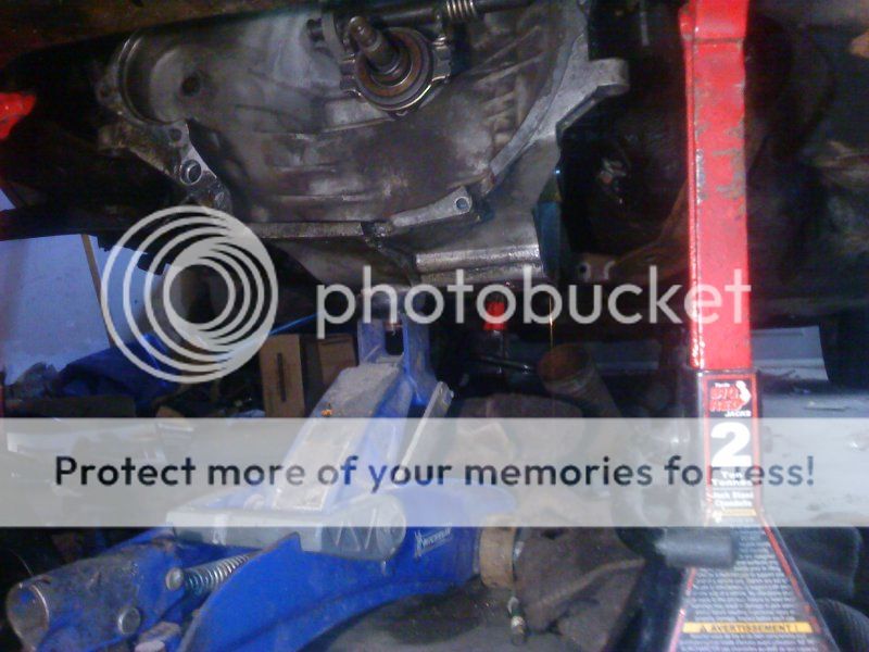

      Move the front jack to around the middle of the transmission so it gives you room to manualy insert the spline into the pilot bearing.
      Line it up as best as you can by moving the rear of the transmission and then the front and then the rear again, and ensuring the whole thing is lined up with the engine, both vertically and horizontally.
      Instead of the front jack, you can use a strap attached to a 2x4 piece of wood resting against the strut towers, to keep the front of the transmission at a height close to what you will work with. Having a helper for this step might also be a good idea. Getting the transmission in and keeping it in can take a while and really piss you off, but it is a great joy when accomplished.
      Have a couple of the bolts handy when putting it in, so that you can screw it in by hand to keep the transmission in place once you put it in. Attach all other bolts, keeping in mind the bolts that hold the heater core valve and the ground strap.

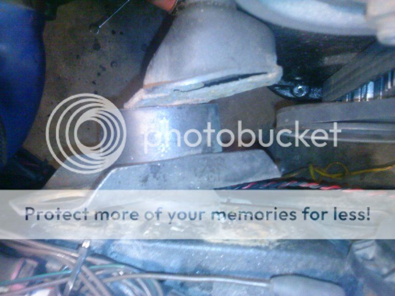

      Now attach the brackets and the big tranny mount (jack the rear of the transmission up for this).
      Then you can re-attach the front and side engine mounts, connect the wires for the reverse sensor, reinstall the starter (make sure to grease up the bushing on the transmission where the starter shaft goes into), hook up and adjust the clutch cable, attach the speedometer cable, attach the half axles and the downpipe, and attach the shifter linkage. In order to align it, you can shift the transmission into third gear, then have a helper hold the shifter in the spot for third gear inside the car as you tighten it underneath. Take a shower and enjoy!

      I was able to get the flywheel off by using a breaker bar on the bolts and putting a transmission bolt in the block to jam a screwdriver into the flywheel teeth to hold it still...I should have taken a pic but it's fairly easy. The bolt acts as a stop for the screwdriver
      Copter* add this to your original post may help a few people who do the flywheel
      The engine block stops it from moving!
