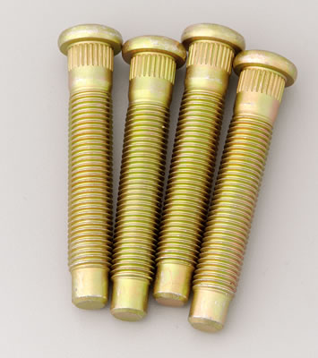

    Is it poosible for me to use press in studs in the stripped holes? The holes goes all the way through. The press in studs i've seen have a lip at the end. I dunno how it would work with what i have.

    Those will work, if your current adapters can be machined to accept them. You need the primary bore to be small enough for the teeth of the stud to grab them, and the secondary bore big enough to take the press end. You will also need a nice hydraulic press to set them.

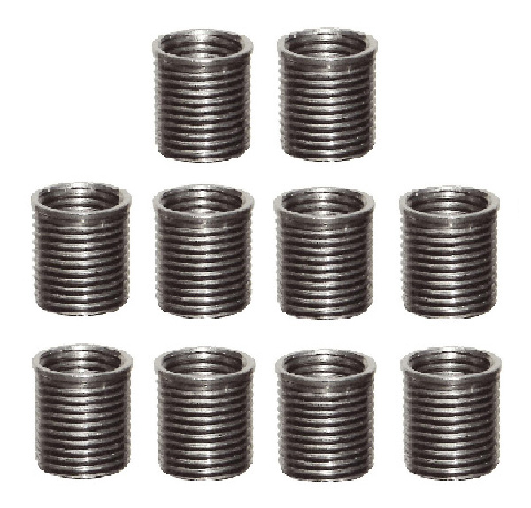

    You can make those studs to fit or you could drill, tap, and helicoil the holes if they stripped. (I didn't read back to see what happened) My adapters for my Porsche wheels didn't have studs either, but they're pretty damn thick (40 & 50mm) so I can run long bolts to get a good bite.

    I think the press in studs will work. The teeth look to to bigger then the threaded part. Being that the holes are threaded all the way through, he would just have to machine the back to counter sink the tab at the end & the teeth will be grabbing the shredded lug bolt threads. Worse case he can tack the back tab.
    now i gotta find the right length. 50mm should be fine. i'm not running spacers in the front of the adapters so they don't need to be long. I think the shortest they come is 44mm.

    Ok...call me OCD but i think i've found a plan B (if i can't use the press in studs). And after talking to the customer service guy, he see's no reason why they shouldn't work. They're made for aluminum & they lock in place...
    They come in various lengths so i can get a sleeve long enough to cover the whole threaded section. It will cost me the same as plan A. I'm going to the machinist on Mon. to get the green light. Then i'll buy what i need...depending if it can be done or not. I prefer the studs anyday.

    Ok fella's..need some advise. I think i'm gonna go with ARP wheel studs but the problem is they come in various lengths & diameters. They are mainly bought by the kind of car you have. I don't have an accurate enough measuring device to size up the holes as the knurled end of the stud comes in different length & dia. I manage to get a rough estimate which is a hair under 1/2". The Honda studs come with a .485 dia so i'm gonna apply it to what i have. The problem is do i get the Honda studs or do i find ones with a bigger diameter. (As i'm typing this, it makes sense to do the latter). If so, how much bigger? There are some that come .509 & up. I thought about getting the .509 (knurled dia.). Next would be the perfect length. I don't want it to look to ricey, poking past the wheels. The sucky thing is i might have to give a bit length for the right knurl dia. I'm thinking after he machines out the holes, it will be about 1/2".
    one's i'm looking at.

  25. 05-07-2012 10:42 PM #1250
    length ishard to judge without knowing the hub thickness on the wheels, so I can't say what is best. My one suggestions is that too big in diameter on the knurled section and too long are both the most easily remedied problems with fit. If the dia. is too great, the holes can be drilled out to the ride diameter. If the length is too great, they could be cut down.
    That's my thought process on it, anyway....

    Quote Originally Posted by blubayou View Post

    Thanks Blue...makes sense. Going through VR withdrawals. I think i'm gonna have to pull him out for some tire destruction

    Ok, after some measuring, i'll have an inch of thread which is perfect as the one stud/lug/barrel thingy has 1" worth of thread. I did some searching & the .485" is the size i'll need. The super bonus is i found someone selling a full BNIB set on flebay for $60. Would've cost me $100.

    Hey dreadz, got any leads on those screw sleeves?
    also, the hub bolt for 5 lugs are 14mm, about 25mm deep,keep a inch more for the lug nuts, as these conversions advise running open-ended lug nuts. Your ok with a inch and a half, add more for spacers and wheel center thickness.
    Look up Mercedes sstud conversions, they use identical hubs and should work with your looking for

    Ebay for those those sleeves....
    The studs are being used on my 4 to 5 lug adapters. This is why its been difficult to find the right set as most are made to press in the hub. And yup, i'm gonna use open face lugnuts. Finding the right length is the key atm.
