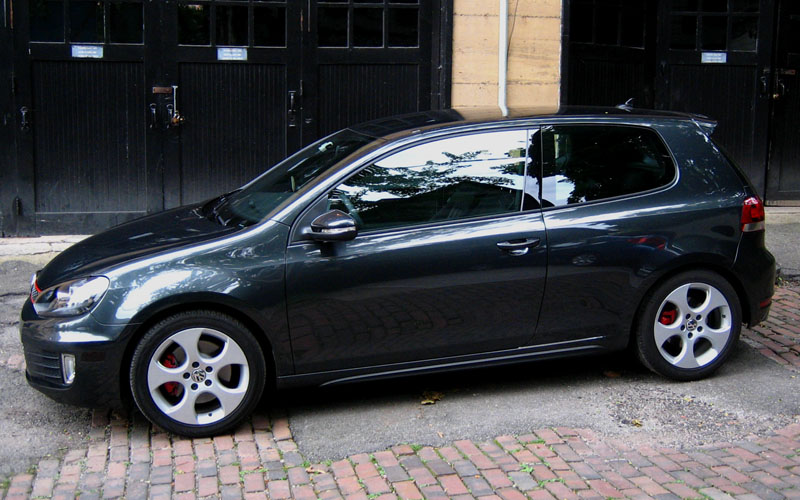

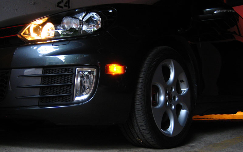

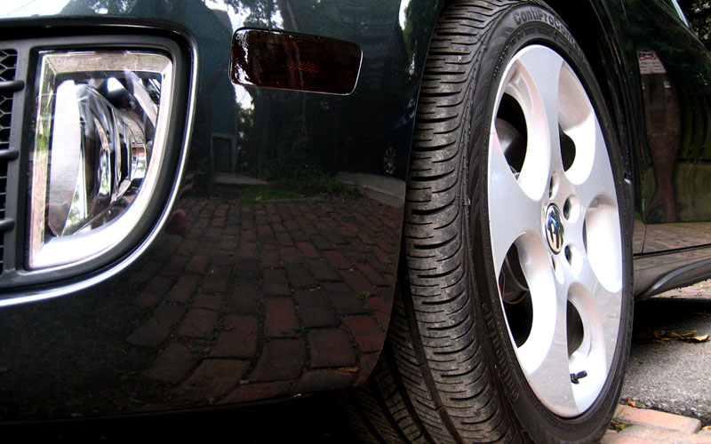

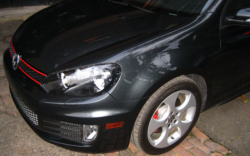

    Like most of you I got sick of waiting for someone to release smoked sidemarkers, so I figured I would give Lamin-x a try. Total cost was about $10 and it took less than 30 minutes. I'll let the photos speak for themselves, but I'm quite happy with how it turned out. Still reflects and lights up orange.
    With running lights on
    With flash for reflection

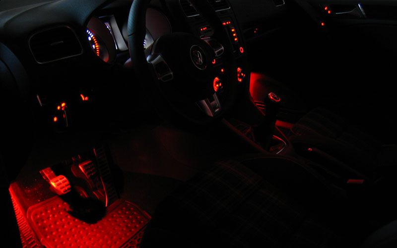

    Also swapped the footwell lights to red (DIY for that here)

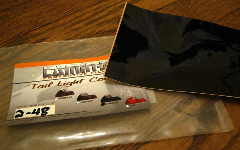

    So to do this yourself, order one Lamin-x universal 4x8" film, found here. Props to Lamin-x, it arrived very quickly via USPS. I went with charcoal, which is dark but not black, perfect for CSG.
    Cutting the film longways down the middle will leave just enough to do both sides. You can either apply it to each sidemarker while on the car, or pop them out to apply. I popped them out, which is accomplished by removing the small panel in the front of the wheel well (on the GTI at least), and then feeling for a plastic tab at the rear end of the marker. Pushing this will swing it out; simply pull off the light harness and remove.
    Once you've got them off, clean them well, and then apply and trim the film. The best way I found to do this was to apply each strip (starting at one end and squeegeeing along the way to avoid air bubbles), then put them face down and trim around the perimeter with a sharp knife on a cutting board. Very simple. Reinsert and enjoy!
    Hope this helps anyone on the fence, as you can see it's well worth the (very little) time and money.
    PS- insert disclaimer about sharp knives and damage to fingers and/or cars here.

    So if I want to do my United Gray TDI and not be too dark, I'll probably want to use either gunsmoke or smoked. It's cheap enough that if I get the wrong color I can afford to do it again.

    Yeah definitely. It's about $8 for one and $15 for two, not sure if you can get different shades if you order two but may be worth a try.

    Nice. Love CSG. The footwell lights were easy, few bucks at Autozone and swapped them right out. It looks great at night; the long exposure above over-exaggerates it, it's really subtle and compliments the overhead and dash lights nicely.

    Both driver and passenger footwell lights are on at the same time when not disabled. The white lights were a little distracting for me too, the red is much more fitting. You know you can adjust the brightness level right?
    Swapping the bulbs is very easy using the instructions in the above link, and they only cost about $4 from Autozone. Glad I posted that photo, people seem more interested in that than the sidemarkers

    Coincidently I ordered Charcoal Lamin-X in the same size as you did for my CSG. The size is perfect if you follow this writeup.
    I learned that you do not really need to wrap the edges of the lens, as it is a tight fit into the bumper already, and Lamin-X is pretty thick. You want to pretty much cut the outline of the lens, no more.
    Also use the technique of applying a bit at a time. For the first one, I laid it face down onto the Lamin-X and therefore got a few bubbles. Second one I did a bit at a time moving my way up and no bubbles.
    I won't repost a pic since it's the same as the OP but what a visual change for what, 8 bucks?
