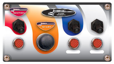

    Might start looking into making a Switch Box for it here soon so that I can eliminate the key, and all the other random switches that are in the car. Any suggestions?
    I thought about buying a Longacre pre-wired box or two... (about $50-$60 a piece)
    I REALLY like this one... but I want the ability to expand and get another multi-switch panel, like the one with 4 switches pictured above, but the Carbon Series only comes like this:
    I looked at the Moroso, as well... but they are a lot more expensive ($125)...

    Meh, its not that bad. There are some extra ends here and there now. But the engine bay is free of A LOT of the loose ends that it once had... especially after I removed the Headlight Harness.
    The interior... yeah, that's a different story. One I make a proper switch panel though... I'll be able to eliminate the 3 random switches around the steering column... as well as the Key. One of these days here soon, I'll start fooling around with the interior wiring.
    BUT, I would still like to find a new complete harness. That way I could properly remove everything that isn't needed... and do a little bit of customizing... and beautifying.
