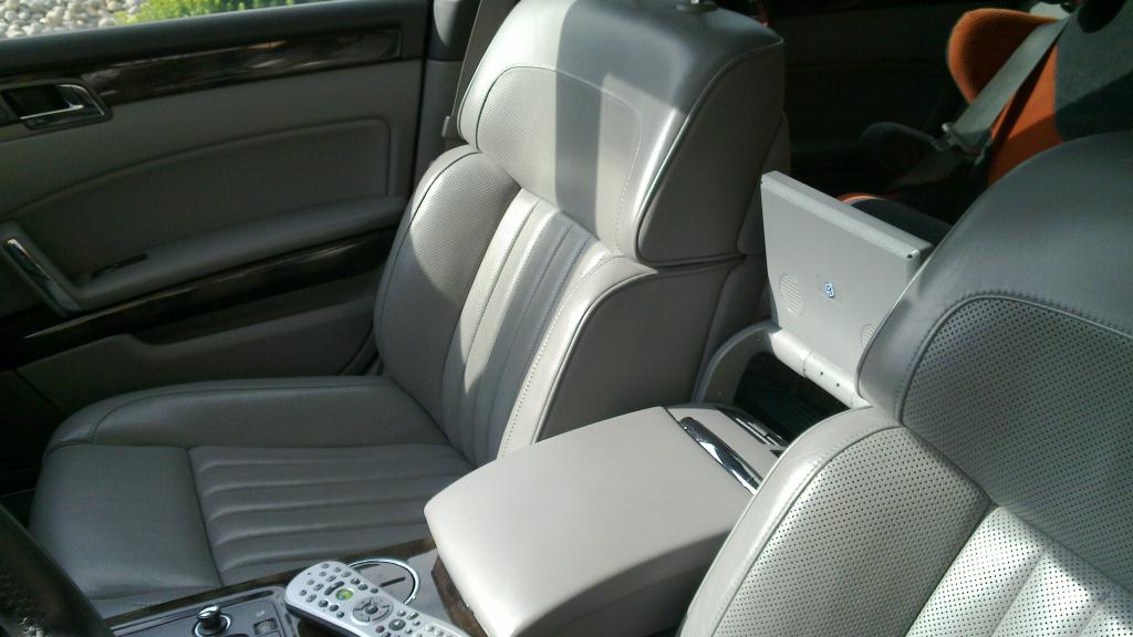

This is where it all starts from. First, I considered installing dual screens to the back of the front headrests. This would have been a major undertaking with the 18-way seats. Not to mention that the OEM screens are pretty darn expensive and I feel that they are placed a bit too high for the kids to view.
My next thought was that I would install a single roof mounted screen. I gave up on this idea once I dismounted a part of the headliner: There is awfully much stuff in there with all the sunroof related wiring and such. Not much room for extra wiring.
Then I stumbled across a very interesting console mount monitor on Ebay. It was pretty cheap but had a decent 800x480 native resolution, video input and it was available in grey color matching our interior. It definitely isn't OEM but I think it integrates pretty ok with the center console. It has a very good viewing position for the kids and does not get into the way no matter what you are up to in the rear.
It also is positioned so that it does not interfere with the use of the handrest or the storage bin:

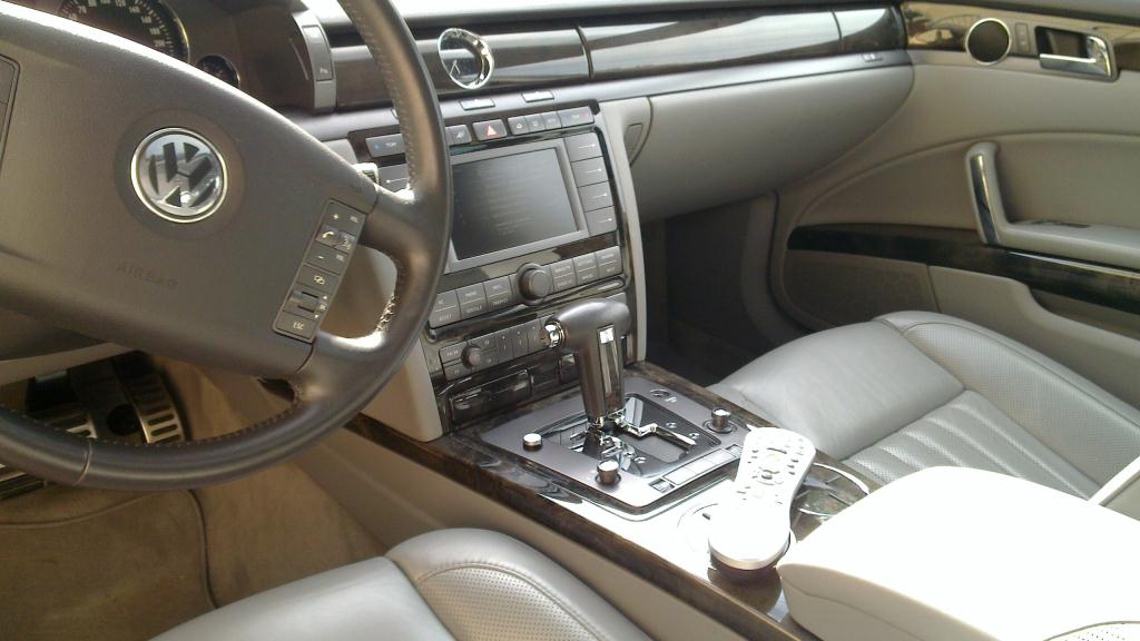

5. Controlling the system
As the laptop is running Windows Media Center, it has native support for remote controls and there is no need to have a keyboard or a pointing device. Most media center remotes are infrared. It would have been possible to install the IR receiver in the cabin, but this would have necessitated more wiring and the remote would need to be pointed at the receiver. Fortunately there is a RF based media center remote available from Keyspan. Think I paid about $100 for it.
Works like a champ: with the receiver in the trunk, the remote works flawlessly anywhere in the car.

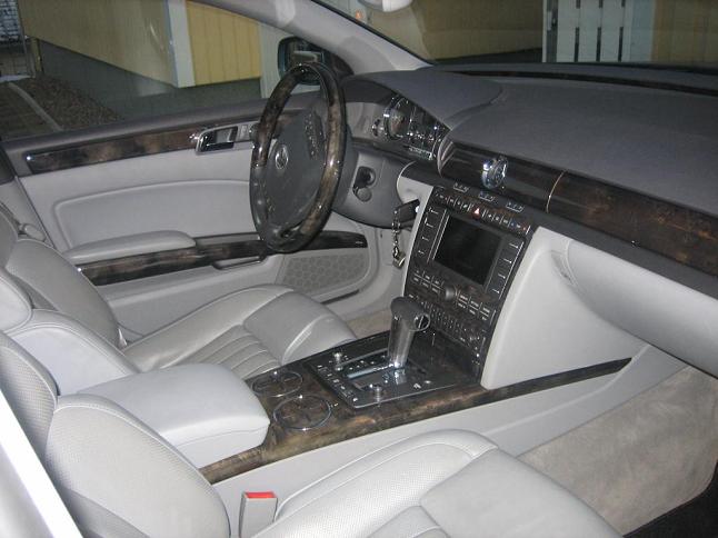

However, I got more excited about the pictures posted and those fine looking wheels. I assume these are OEM Phaeton on the newer generation European models. The bright silver color(hyper-silver?) on the wheels is much classier than the dull silver on my Challenge wheels. If you don't mind, tell us about those wheels.
#4
The photo is taken from a bit odd angle, my wheels are pretty common "Omanyts". They're silver with a polished outer lip, 19" in size. Here seems to be a whole thread on the subject: http://forums.vwvortex.com/showthread.php?3831433I assume these are OEM Phaeton on the newer generation European models. The bright silver color(hyper-silver?) on the wheels is much classier than the dull silver on my Challenge wheels.

Zed ze typikal VW Warkuß smile!
just kidding. Do you have Myrthe wood? I have it too (I suppose), but mine doesn't have this 'greenish' touch?! How is the wavy grain on your wood? Is it sharp and very detailed with small thin grain or extremely blurry?
Oh and by the way, your TV upgrade looks very professional. BMW used to have a similar if not even the same design for the old Chris Bangle BMW 7. To bad, that this might not look good in a 4 seater.
#8
Haha, thanks guys!
Harry, yes, should have asked my wife to prescribe our kids what you proposed - would have spared me a lot of time spent in the garage. What comes to money, the parts I used were not expensive at all. The set has been working fine ever since. I have even gotten to use the laptop for something useful - fixed my cranky electric trunk lid with VAGCOM while on the road.
My car has the "pappelmaser schwarz" wood from VW Individual. It is (most of the time) pretty much gray but when exposed to bright light, it looks brownish. I know this is stupid but it was one of the main reasons I chose this particular pre-owned Phaeton :-) Here's some more photos of the wood:Do you have Myrthe wood? I have it too (I suppose), but mine doesn't have this 'greenish' touch?! How is the wavy grain on your wood? Is it sharp and very detailed with small thin grain or extremely blurry?
