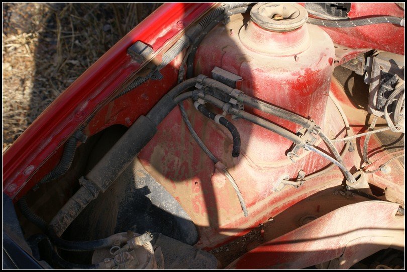

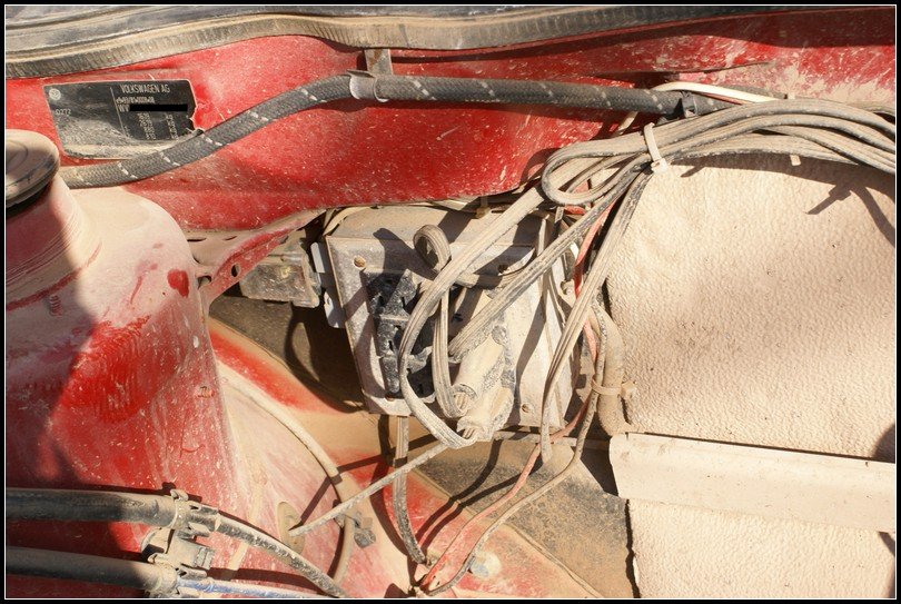

    It then appears to have been fitted afterwards with a 110 volt distribution block in the engine bay, which had one wire running to the inside of the car (unknown to what it connected to), with a crudely installed external plug. It also received a roof antenna, and a receiver (+ transmitter?) inside - only the wiring was left installed when I received it.

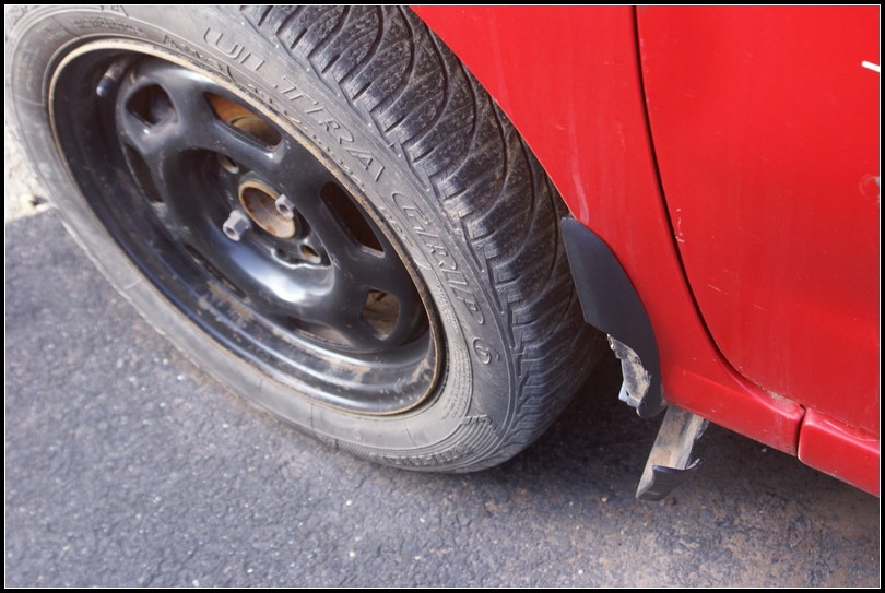

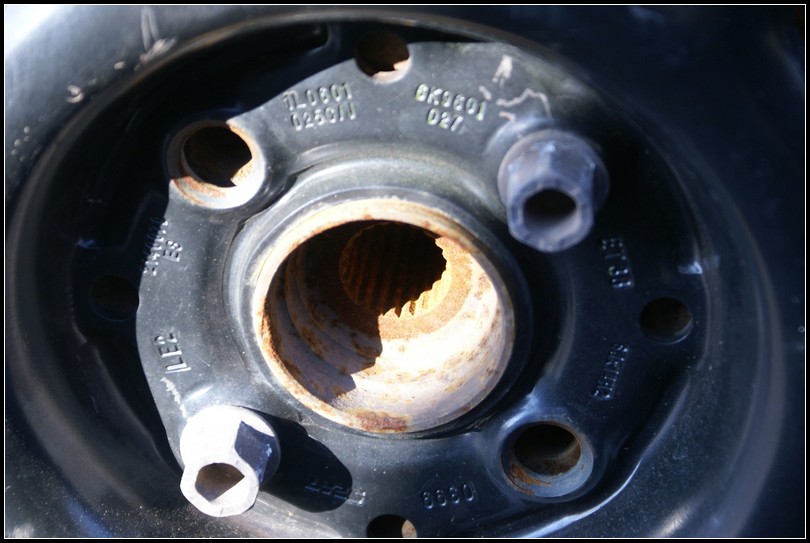

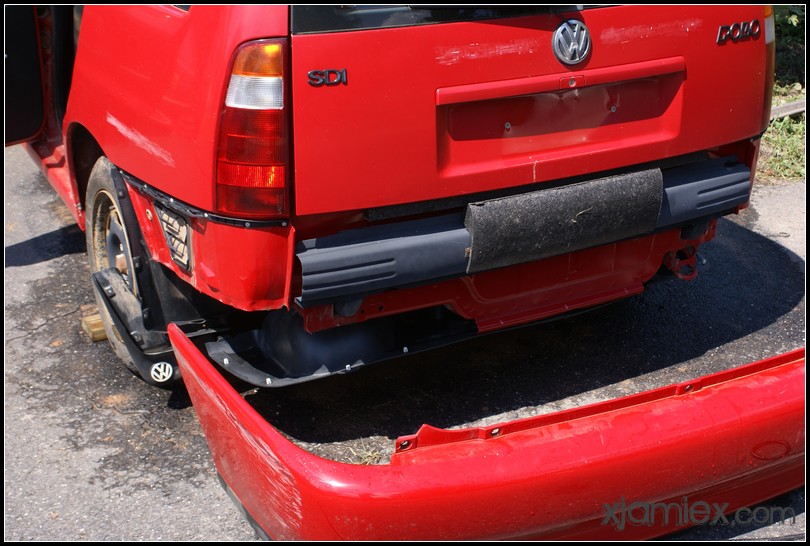

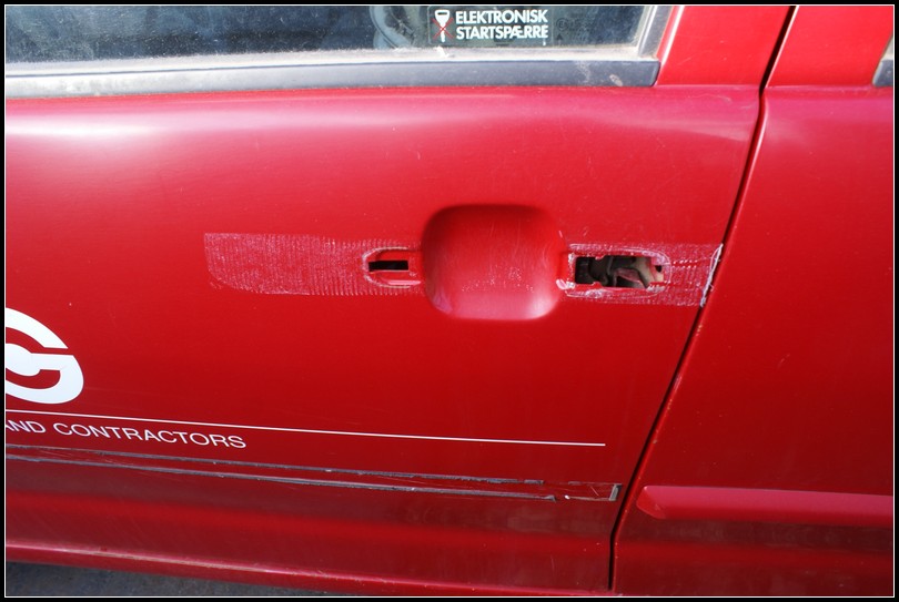

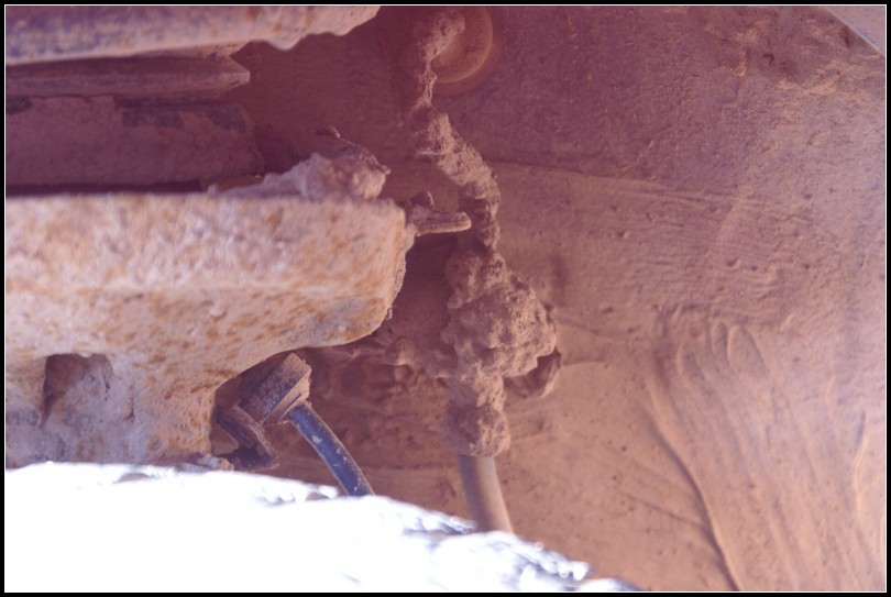

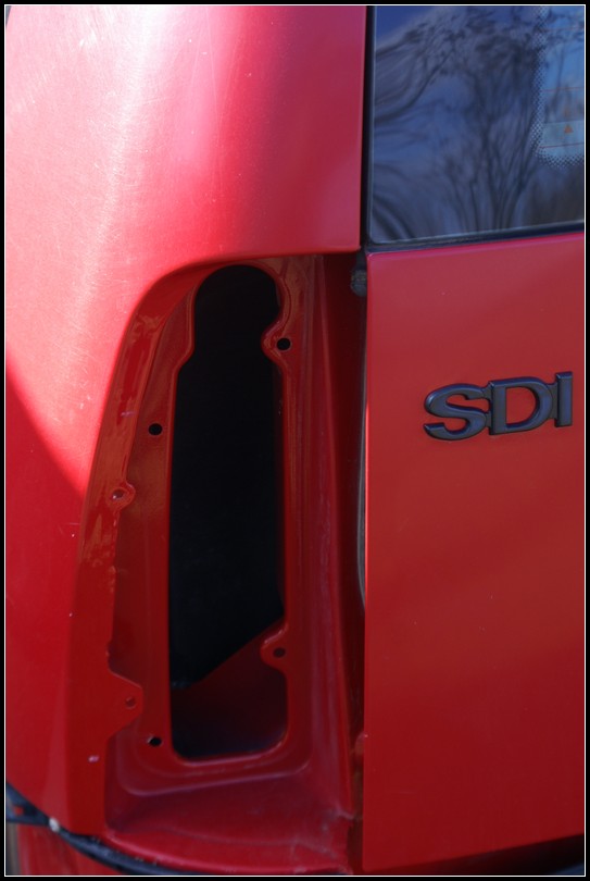

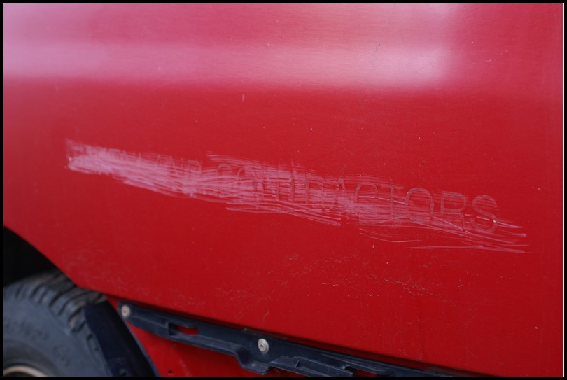

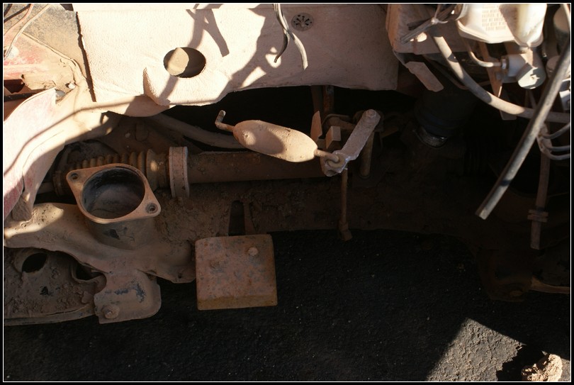

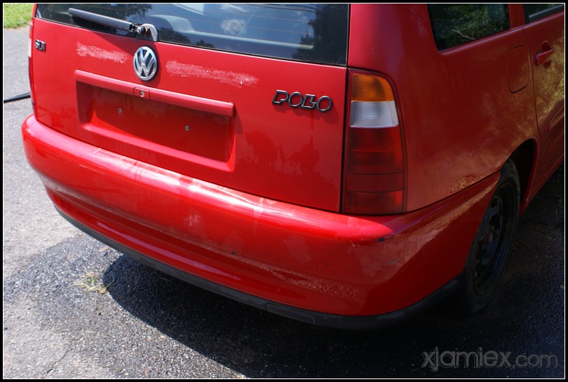

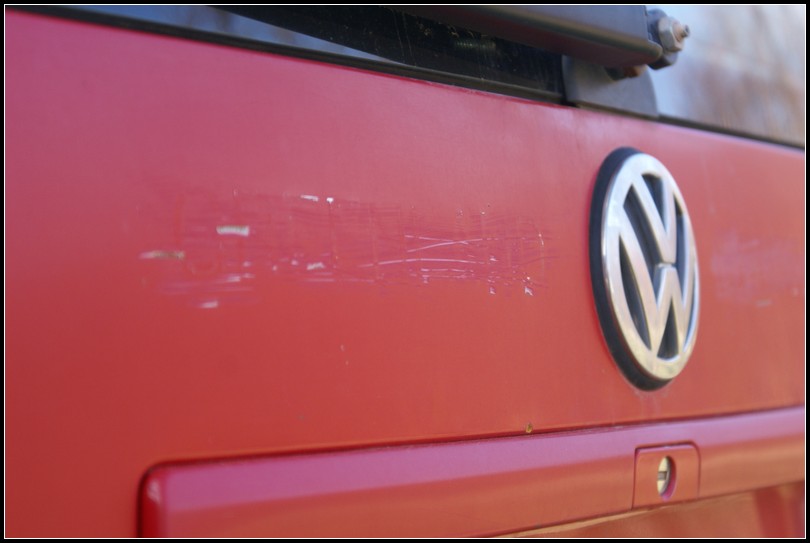

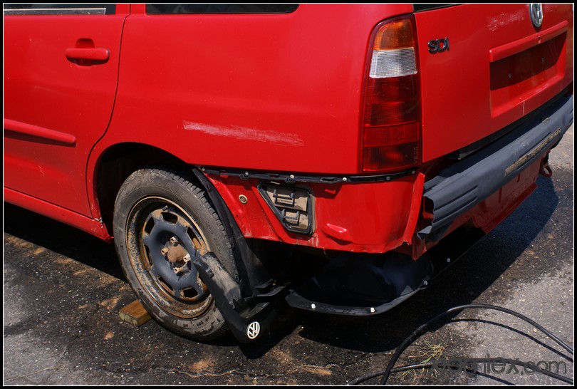

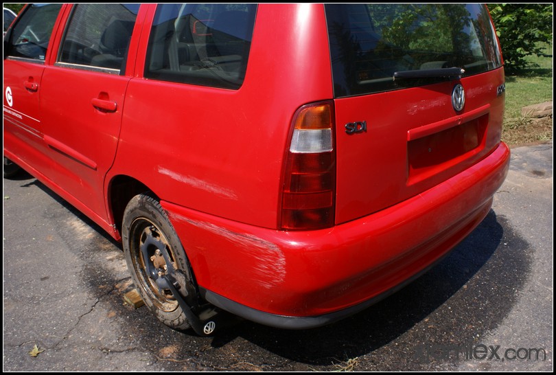

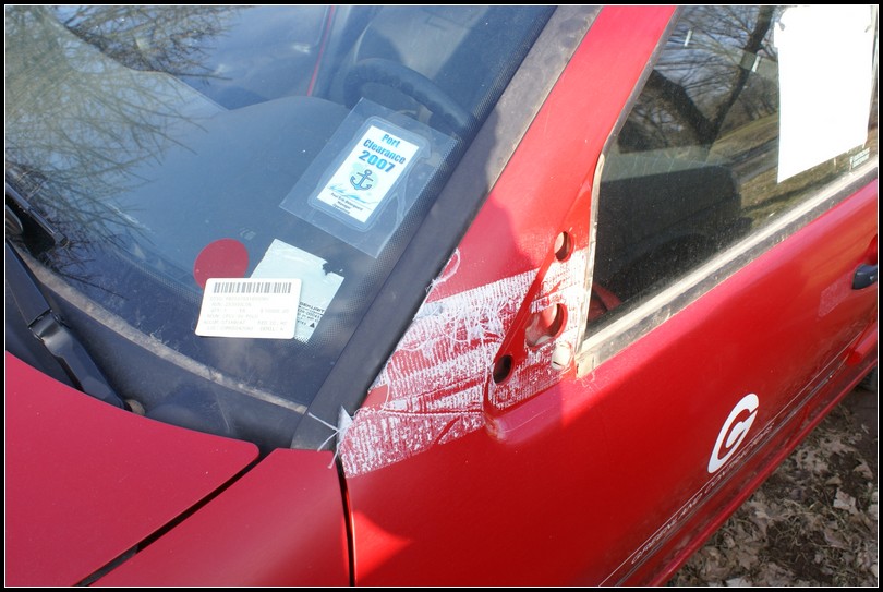

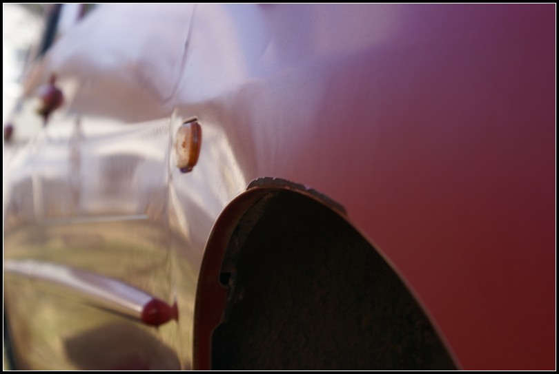

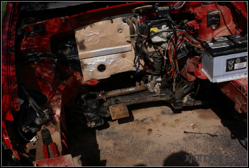

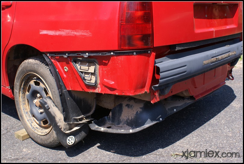

    Here's some further inspection of the damages:

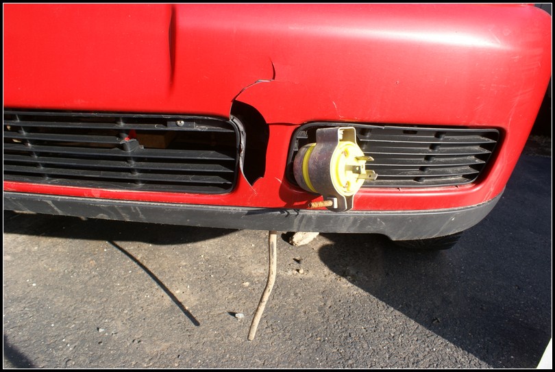

    I'd guess it's had a block heater fitted, to warm the engine up before starting it.

    Quote Originally Posted by veedweeb View Post
    Absolutely. From what I've read, -30'C is not uncommon, so I suspect that when the engine wasn't running, it HAD to be plugged in. I wouldn't be surprised if it had several heaters, hence the distribution point.

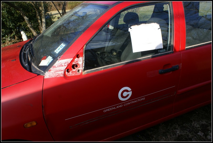

  21. 08-05-2010 10:20 AM #21
    im rather curious how you got around that one..

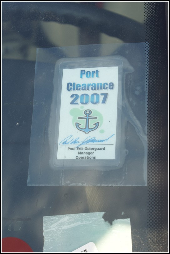

    The car worked for this company
    http://www.greenlandcontractors.dk/en/
    Wonder what its role was...

    You're spot on, it is just a rebadged Seat Cordoba - same production line, and a lot of the parts have VW Spain or SEAT Spain stamped on them.
    actually the lights on the front and back are a little different only seats don't hold the price as well as polos. they also share a looot of parts with mk3 golfs and also mk2s. engine, gearbox all mk3, suspension parts mk3, front antiroll bar mk2 gtd and so on...
    you have to be careful, all of this early cars with 1.9 sdi have a problem with the reverse gear (so i heard, correct me if i'm wrong), the gear itself is supposed to be to weak.
    Mmm reverse gear is totally missing

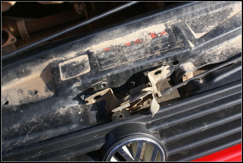

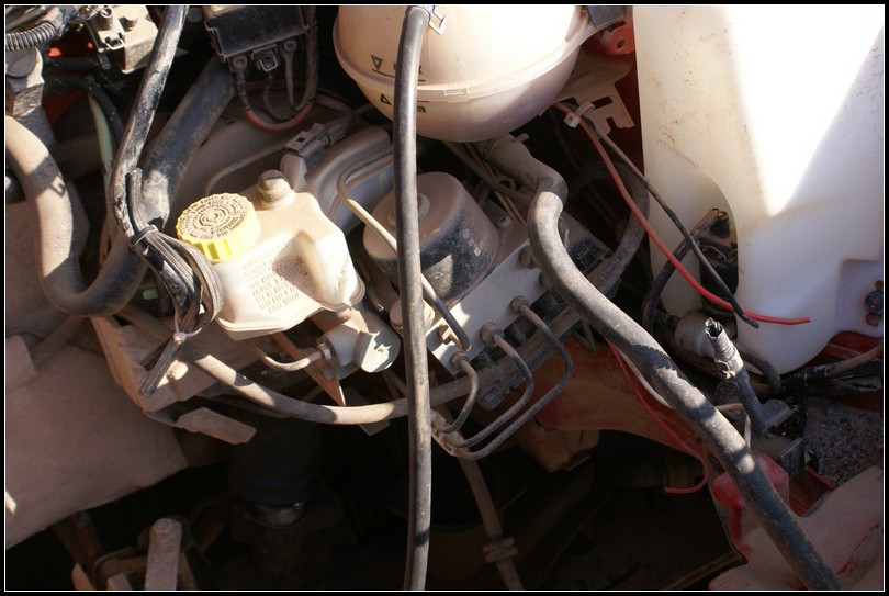

    Here's the last week of work, squeezed in when I've had some spare time.
    Obviously, the dirt in the engine bay has been power washed away. My driveway's got a nice coating of grey Greenland mud on it now. After that, the 110v external power wiring was removed and I got a chance to inspect some more of the engine bay. It's a hydro clutch setup, which is great for me as it saves me hassle of installing that stuff if it had a clutch cable.
    There's lots of stuff missing, or half installed. The rear engine subframe is hanging on by 2 bolts, and the steering knuckle unclips at will. A lot of the suspension bolts are hand tight too. I suspect that when someone was trying to remove the engine they though dropped the rear might have been easiest, and then changed their plan half way through. Well, it's all simple stuff to sort out for me - at least the subframes still on, so it rolls and I have less parts to track down.
    In my stash of parts that just arrived, I got the drivers door cleaning up and the mirror installed. Unfortunately, it's a slightly earlier style mirror so although it works fine it's not the right shape cover. I'll have to track down a late model but non-power one later - it doesn't seem like a very popular option though.

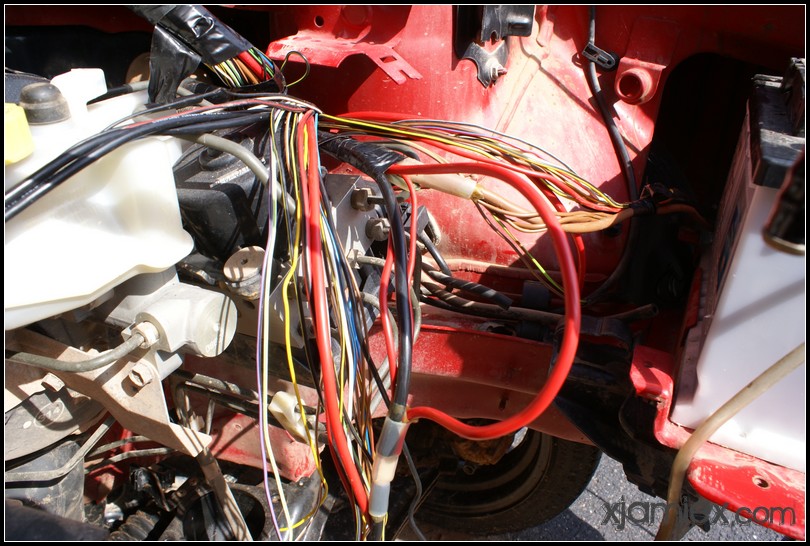

    I removed the front end, and replaced the missing bolts on the steering rack and rear subframe:
    and at the same time, took a further look at what's left of the wiring in the engine bay. All of the engine wiring has been cut, as have the battery terminals etc. I have got replacement terminals, but wanted to double check my diagrams and test that I can remove the diesel +12v feeds that supplied the glowplugs etc.

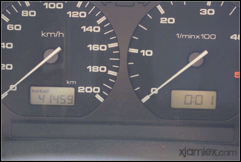

    So, for the first time in a long time the car got power. Lower mileage than I expected:
    I've brought a few of the missing parts over from Europe for the car. The missing drivers side taillight was bolted on the moment I got it here, to close that big hole in the body, but today I mounted up the rear bumper.
    How the car came, with newly installed light:

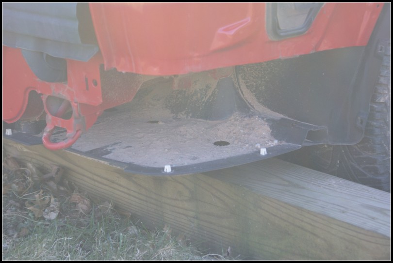

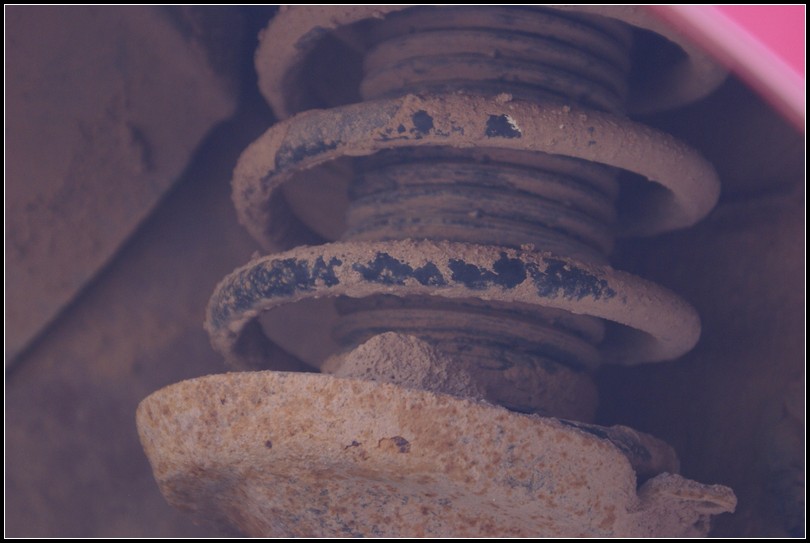

    Power washed some of the worst of the mud off the bottom. I got to discover that the bottom of the car smells like a fish mongers, or the Jersey Shore. Lovely.

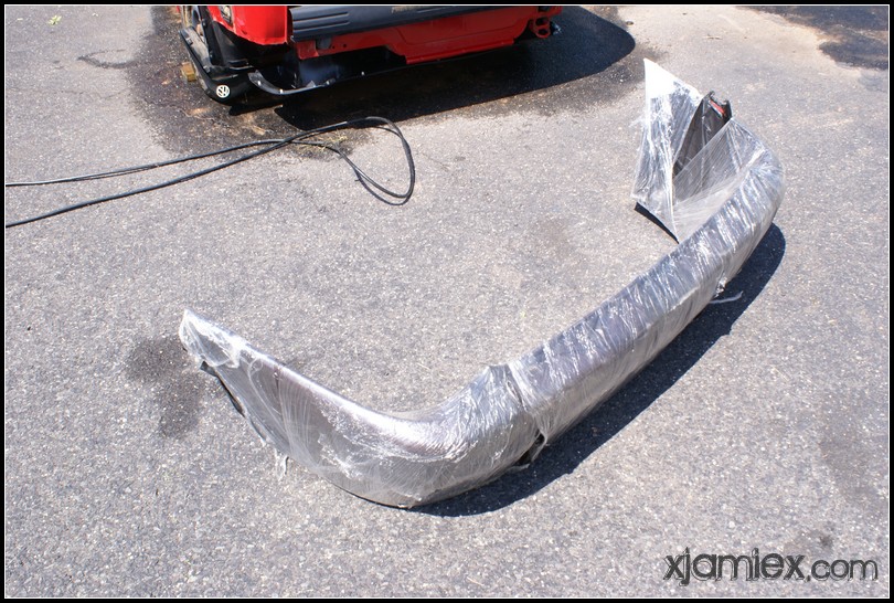

    Replacement bumper from a matching red Seat Cordoba Variant. I know (hoped?) they were interchangable, but I still haven't cross referenced the part numbers to see if they're identical. Either way, it's a bumper!
    Re-glued the foam to the re-bar:
    Fitted. Still need to find the correct hardware to bolt it up fully, and to screw it onto the diffuser:
    It's a used OEM bumper, so the scratches match the rest of the car nicely

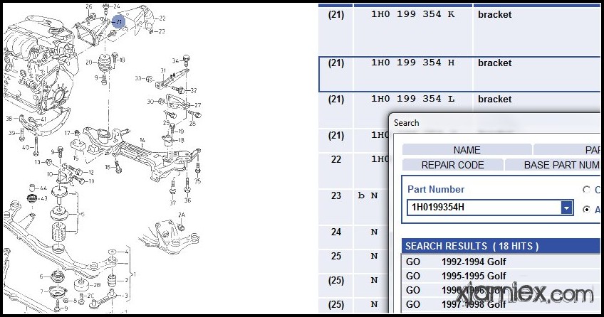

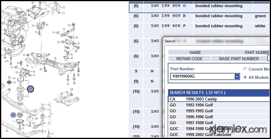

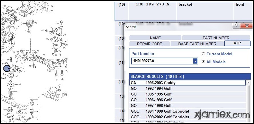

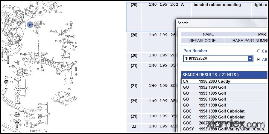

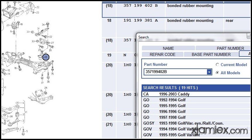

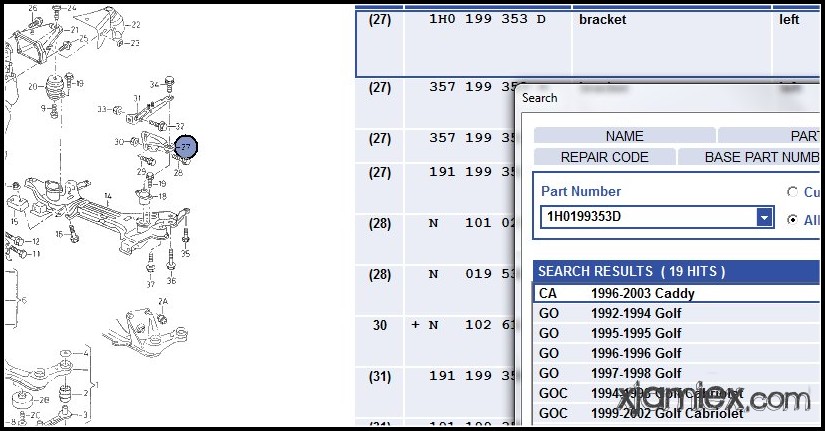

    I've also been slowly thinking about the engine that's going to be swapped in. It's a 1.8T 20v AEB from a early B5 passat (Nevar Lose except for Sludging version). Several things need to switched from the longitudinal setup to a transverse setup. The oil filter housing has been traded with a VW Fox owner for a ABA setup. The open hole on top needs to be tapped to M12x1.5 to use the turbo oil feed fitting. The hole with the socket in it will be used for the oil pressure switch, and is already the correct thread size.
    And in the spirit of cross-referencing, I'm going to be doing a lot of it instead of just buying everything off the shelf in Europe. It's mainly the engine bay, so here's what i've found already:
    ABS hubs are mk3 Jetta/Golf. I'm going to put new ones on when I do the front bearings:
    Control arms are mk2 Golf/Jetta:
    Engine mount bracket is mk3 Golf/Jetta:
    Engine mount itself is a mk3 Golf/Jetta. Need to decide if I want to run stock, or give Black Forest a call for something upgrade:
    Front engine mount bracket, mk3 Golf/Jetta.
    Front engine mount, mk3 Golf/Jetta.
    Trans mount and bracket.. following a theme here, is mk3 Golf/Jetta:

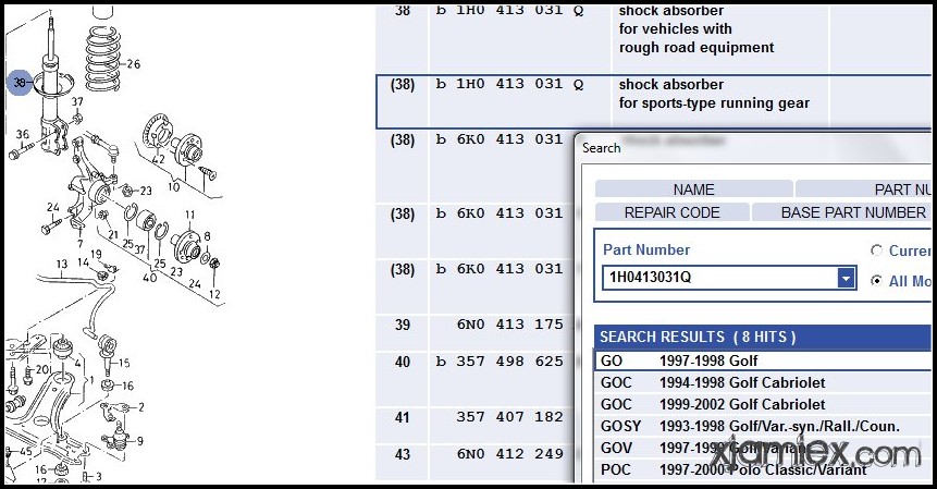

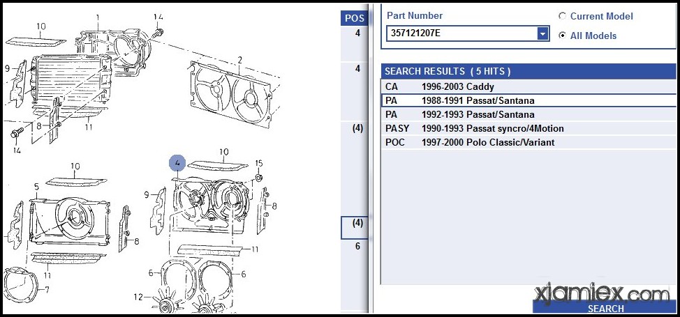

    Fan shroud/setup. This had me worried, but it turns out that a B3 Passat is the same thing. That means that a mk2/3/Corrado should all work, with minor trimming or modification.
    I have a set of mk2/3 Golf/Jetta coilovers sitting around in case they fit.. The fronts are the same, which is great. The rears say they are specific to the Polo, but I just don't believe it. Maybe the length of the housing is Polo specific, but I going to be they all mount up the same and with the adjustability I should be able to overcome the height difference. We'll see how the weight of the polo does against the heavier mk3 though - I bet there's little difference in the rear though.
