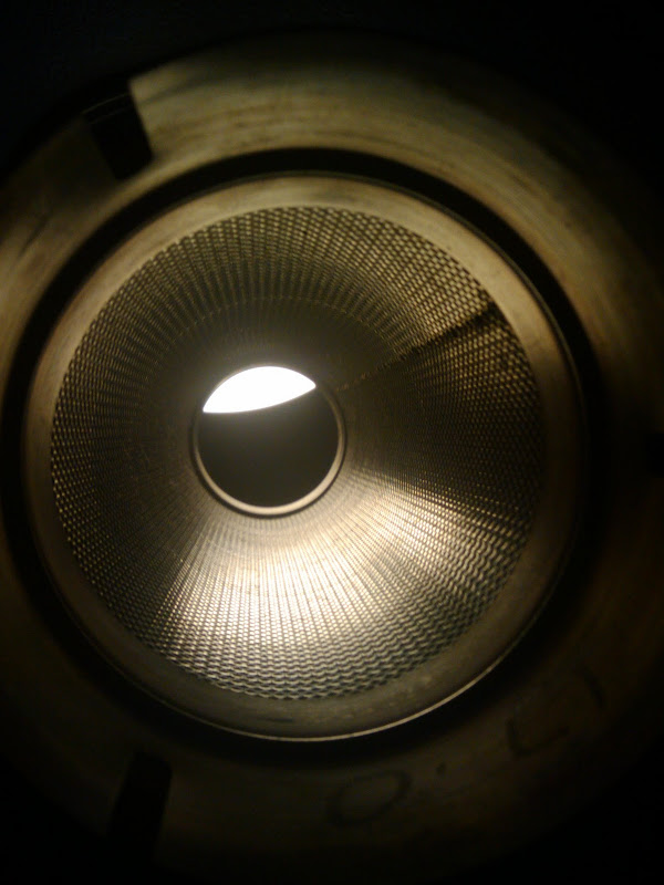

    No going back now. Burns Stainless is fabing up my 2-to-1 collector as I type.
    Need to order:
    O2 Bungs
    V-Bands
    Mandrel Bends
    308 Tig Rod
    304 Stainless Flatbar - So I can mill out the header/testpipe flange.
    Just ordered:
    SM-300-450-17
    Inlet/Outlet Diameter: 3.00"
    Body Outer Diameter: 4.50"
    Overall Length: 17"
    Weight (lb): 3.29
    http://www.burnsstainless.com/sm-300-450-17.aspx
    and
    2-to-1
    Inlet Diameter: 2.25"
    Outlet Diameter: 3"
    I am debating on putting in two venturi vacuum generators in the test-pipe. Not sure yet.

    Yea, it was a bit more than other stuff. But the extra cost went towards the quality of the product. I can also repack the muffler just by undoing 4 hex bolts. So it will never wear out, and I can play with different packing materials to get the sound I want!
    Details:
    I bought some stock downpipes from a fellow on here and took them over to my buddies machine shop. He does 5-axis milling for Boeing, awesome place. We threw the downpipes on the CMM machine and pulled all of the X,Y,Z dims and I then made up the exhaust flange in Solidworks. I also have the X,Y,Z and I,J,K of the downpipe to testpipe and then the downpipes to 3-to-1 "headers". So someone could make downpipes and have them mandrel bent. Anyway, that is a project for another day.
    So, I made the flange with 2.25" exits.
    From there back it will be 2.25" OD piping back to the first exhaust hanger. It is important to note that these pipes are not bent like the stock ones or all the other aftermarket testpipes. They are straight back to keep the tubes equal length and not screw with the exhaust pulses.
    At that point it merges with the Burns 2-to-1 into a 2.75" single and then a megaphone to 3". V-Band.
    From there it will go back and up slightly and tuck the muffler into the stock location.
    I am going to pipe it up past the diff and get it ready for the final muffler.

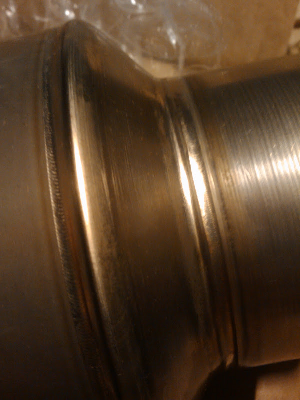

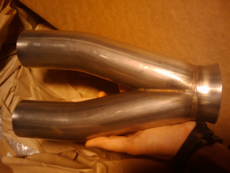

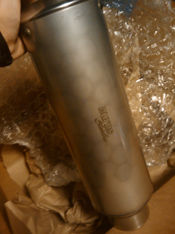

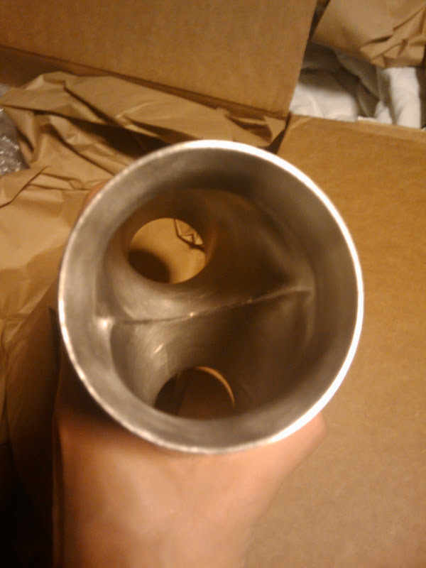

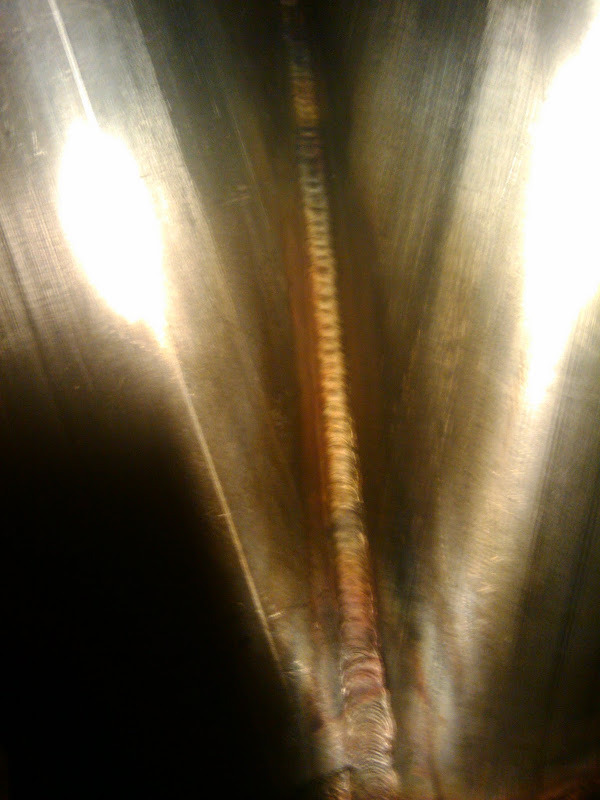

  9. Member Draxus's Avatar
    Jan 6th, 2009
    Seattle, WA
    2,407
    MKIV DBP .:R32
    08-28-2010 03:16 AM #9
    OMG
    So worth the money. Everything is perfect. The welds are phenomenal! Sweet Jesus look at the Y-Pipe! Its mandrel bent to size! Oh yea, stickers also! Sorry about the phone pics.

  10. Junior Member Dingman1088's Avatar
    Oct 9th, 2009
    Ogden, Utah
    47
    MKIV R32
    08-28-2010 03:55 AM #10
    Looks bad ass......Good quality welds

  12. Member dr. b's Avatar
    Jul 14th, 2005
    motorsport capitol, the world
    4,472
    i scrape a gt4088R32, she rocks a B8
    08-28-2010 08:37 PM #12
    the inside-shot of that 2-1 gave me a half-stack.
    subscribed!
