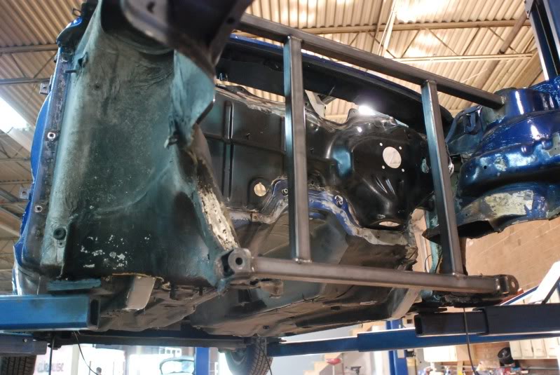

    The euroWise Guys are getting serious now...
    So what i wanted was basicly the entire r32 car stuffed in a rabbit shell... I'll keep the typing to a minimum and let the pics do the talking....
    braced more of the car up to keep everything true...
    notice the modified mk4 subframe... Bolted in place...
    They go from this....
    to this...
    from under the car...
    and finally, a new firewall, and don't worry, there will be a few less holes soon....

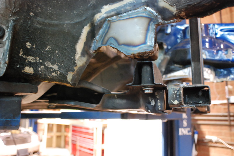

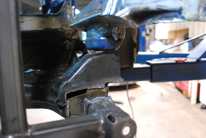

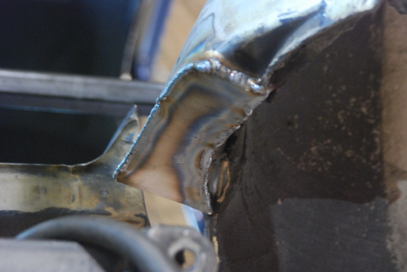

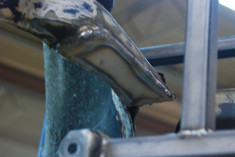

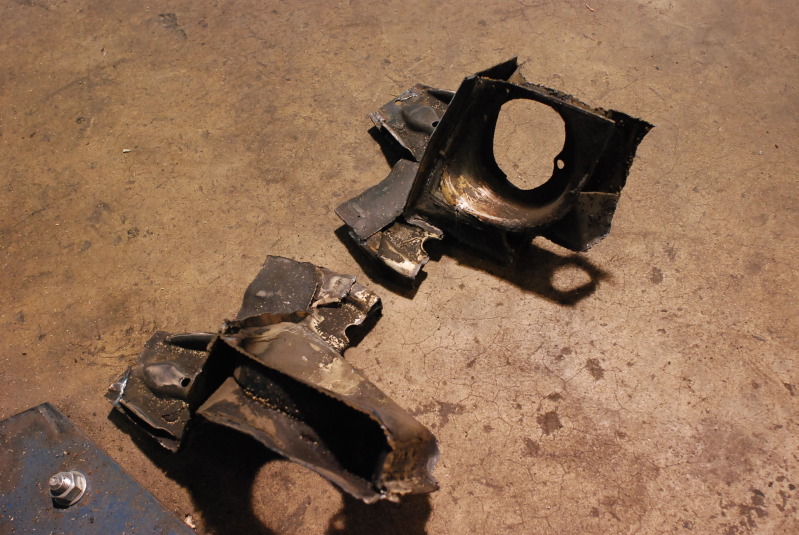

    More progress and must say... the guys at eurowise are definitely doing things the way i had explained and asked and they have even surpassed even my expectations in regards to quality and time.... thanks fellas
    enough of the hallmark comments and time for the progress report.....
    mk1 front control arm structures cut off
    they reinforced the body with steel plates where the mk1 subframe\control arm mounts were cut off
    drivers side oem mounting point for front subframe mount retrofitted
    passenger side shot
    detailed shot of mounting point
    view from under the rabbit of the subframe bolted up
    take care,
    nash

    10-18-2010 02:16 PM #102
    Quote Originally Posted by otti View Post
    seems to me like very nice planned out work!
    do you help with the build or do the guys at the shop bill you by the hour
    What i wanted goes well beyond my capabilities and more importantaly I wanted it done RIGHT. I know what i know and more importantly, i know what i don't know even better..... Having said that mike, doug, ronnie, and the rest of the eurowise guys are very capable of doing what i wanted!
    the way it goes is..... i tell them my ideas and they tell me whether it is possible or not... So far i've gotten more yes's than no's, but after discussing suspension idea's with mike this weekend, i'm expecting a few no's coming soon....
    I'm sure once all the fabricating is done, mike will let me rachet in one bolt.....
    take care,
    nash
