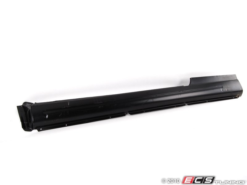

    I don't know how I overlooked this.
    I found some replacement rocker panels on ECS tuning.
    This means that I just need to concentrate on patching up the floor.
    This will definitely save me some time.
