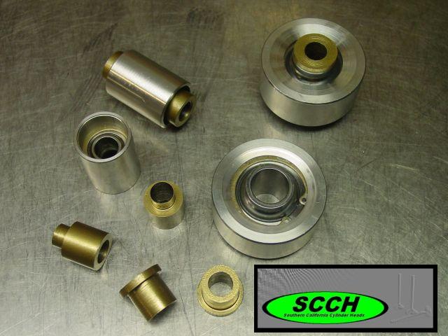

    *UPDATE*
    034 Motorsport made them for us!
    They are available here: http://www.034motorsport.com/chassis...i-p-21362.html
    Hey guys. This just popped into my head when I was helping my friend with his S4.
    What you think of this comparison. The front bushings on a S4 look very much like the R32/Golf bushings. I am going to contact them on Monday. Anyone know the size of the front bushings or have access to some to pull some widths?
    Thanks guys.

    I'm curious about this. A few questions for those who have seen them.
    1. There doesn't seem to be any flexible material or spherical bearing. Is this correct?
    2. Does this effectively mean the subframe is fixed to the chassis?
    3. On the web link they speak about clearancing the bushing to the subframe. This would mean there would be no play between two hard surfaces.
    4. I understand minimizing the movement from subframe to chassis, but no movement?

    Ok. So I talked to them. They have no idea if it will work or not. Does anyone have a bushing sitting around? This is going to take a test fit.
    And yes, it would be effectively locking the subframe down. No movement. It's a good thing.

    I have a spare new subframe sitting at the shop. I will take some measurements.

    So the diameter of the subframe hole that the bushing goes into is exactly 66.50mm or 2.618"

    I want to make sure which sub-frame you are looking at. I believe we were discussing the front sub-frame. If this is the case, we should have something ready for you in 3 - 4 weeks time. I will e-mail you with more specifics as time moves on. Let me know if you have any questions. Thank you.
    034Motorsport
    I responded to confirm front.
    Now, someone get me the dims for the rear!
