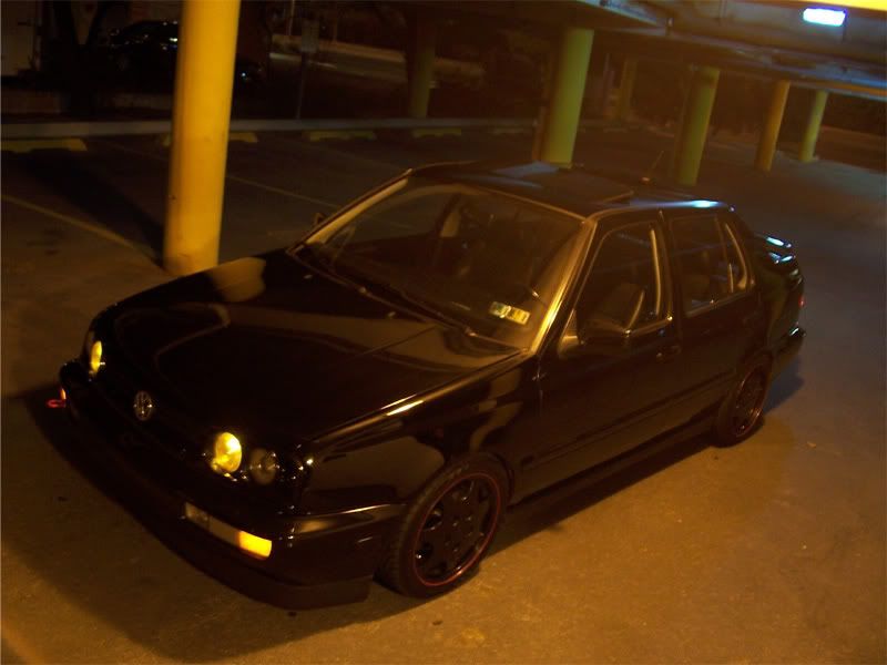

    Yup, so i got some.
    I'm really not sure if they are ABT or Carrello.
    edit: better pics
    Really don't matter what brand they are. Anyway, onto some questions:
    These are really dirty and look like everything is there.
    Visibly, it looks like the black plastic ring around the Cibie lo beam light is broken or worn.
    Where can we find replacement lights?
    One of the Cibie hi beam housing is loose and moves about, but nothing looks broken.
    How can i refresh these properly?
    The plan is to resrpay masks in red and maybe HID in a projector behind the low beam.
    I want to laminex or "french" the hi beams to yellow.
    Teach me about dual round setups, common fixes, replacement parts and the such.

    Those are abt duals. If i remember correctly they only had stickers that abt , it wasnt molded into them.
    to refinsh them i would sand them down and use a sandable filler primer to smooth them out and then paint them. It prolly wouldnt be a bad idea to reinforce any of the mounting tabs that are still there. They tend to break easily.
    as far as lens, thats a crap shoot. Ive heard rumors that some bmw projector low beans will fit them, but ive never seen any proof. as for the high beams, the best bet is to find something the same size and make them work. or you can scour ebay for some replacement lens or buy a parts set.
    The hellas/pzwos have the best light output of any of the dual rounds. The hella projector they both use is really nice.

    alright guys, so it looks like i will need to start measuring and then either sourcing from Daniel Stern or the rally lights site. eBay is another option, but i'll leave that for last.
    thanks Dan, Steve and all.
    And yeah Steve, if you could check on your sets real quick, that's cool. appreciate it
    tabs:
    i realized one is broke off and has taken a small part of the housing with it.
    really sucks bc idk what i could do to fix that without it looking/operating ghetto.
