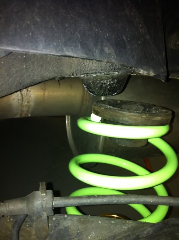

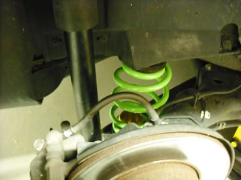

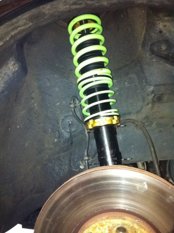

    First I’d like to point out that what I received looks different from what the Raceland website shows. Not a big deal for me but it’s something another user pointed out to me. Once receiving these I was happy with their condition. Certainly there was nothing to complain about. They got here in one piece and were shipped via UPS. I wasn’t originally a fan of the slime green, but it grows on you. I was happy with the collars and perches being golden, but I was concerned that it would just wear off once I adjusted them.
    The Front
    I don’t recall seeing any difference between the two front coils (besides the colors and powder coating). At that point they seemed to be nearly identical. They do have their little differences but I do not really know if that matters. One big difference I did notice was that the allen key size were different between Rokkors and Ultimos. The Ultimos required a size smaller. (I will update if I can find the size) They also may be a tad bit shorter IIRC, but nothing to concerning though. The Ultimos front are much wider than the Rokkors. I had complete wheel clearance with my rokkors and now I'd need another 5mm or so to clear.
    The Rears
    These are the moneymakers IMHO. The install was simpler than the Rokkors because the spring is nearly half the size of Rokkor’s! When installing with the perches spun all the way down the spring doesn’t even touch the top. ☺
    That made me really excited. Furthermore the strut is also a bit shorter. I cannot imagine how much can be different between the two other than this so I don’t have anything much to say about them. Simple install.
